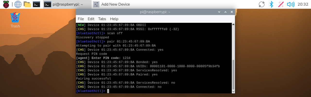

And i have managed to successfully pair the OBD reader in bluetoothctl
I have also used the same MAC address in my main_configuration for the obd settings

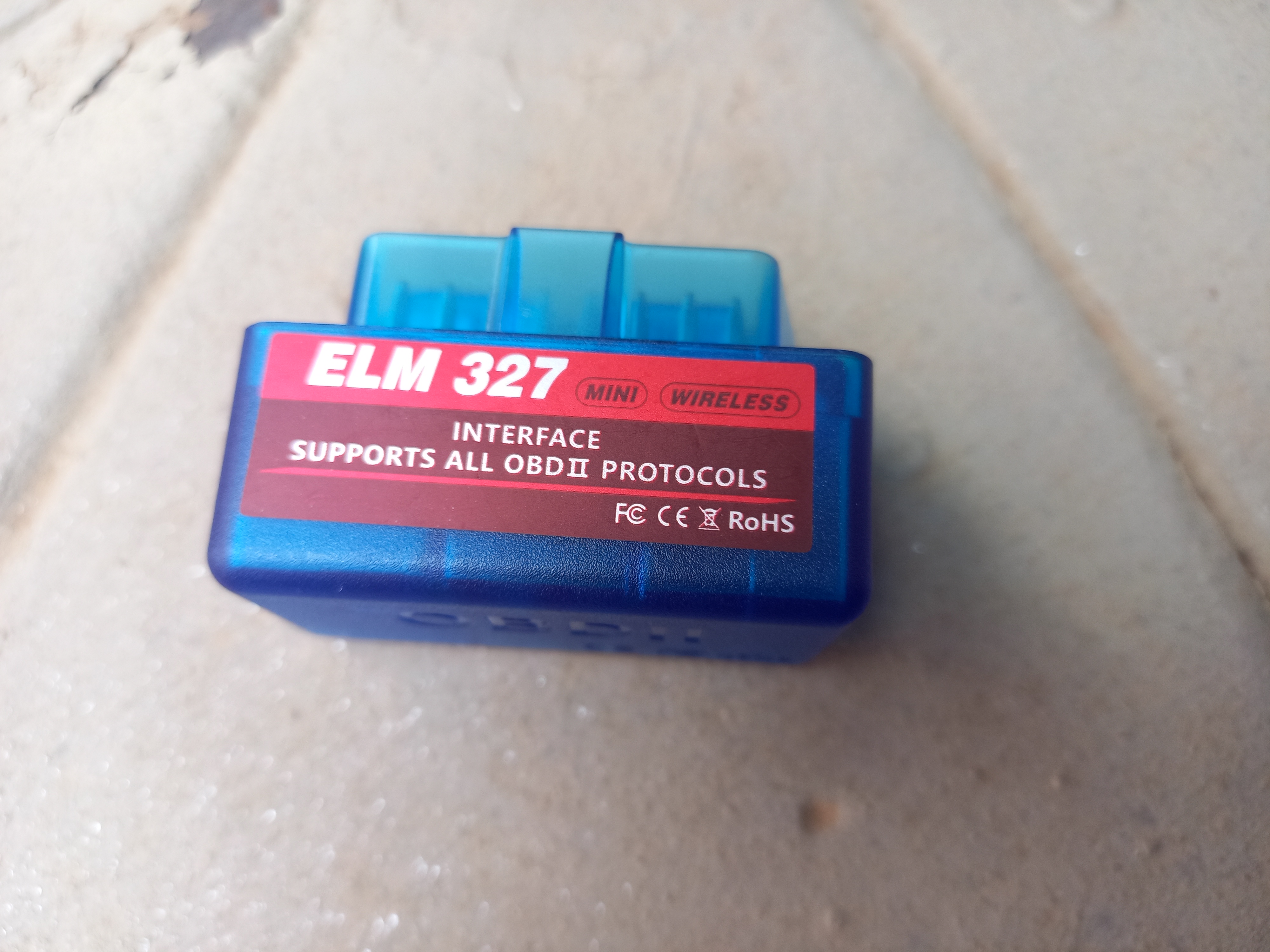

One of these generic ones
https://www.amazon.co.za/gp/aw/d/B0DJMH ... asin_title
Heres an actual pic. It didnt come with much documentation either. If the dongle is an issue do you have any suggested products instead 🤔

If you paired via bluetoothctl, try to add the device to trusted list by executing below command in bluetoothctl
trust 01:23:45:67:89:BA
Or you can remove existing pairing and pair with the device using Bluetooth menu in Hudiy. If that will not help, please post output of

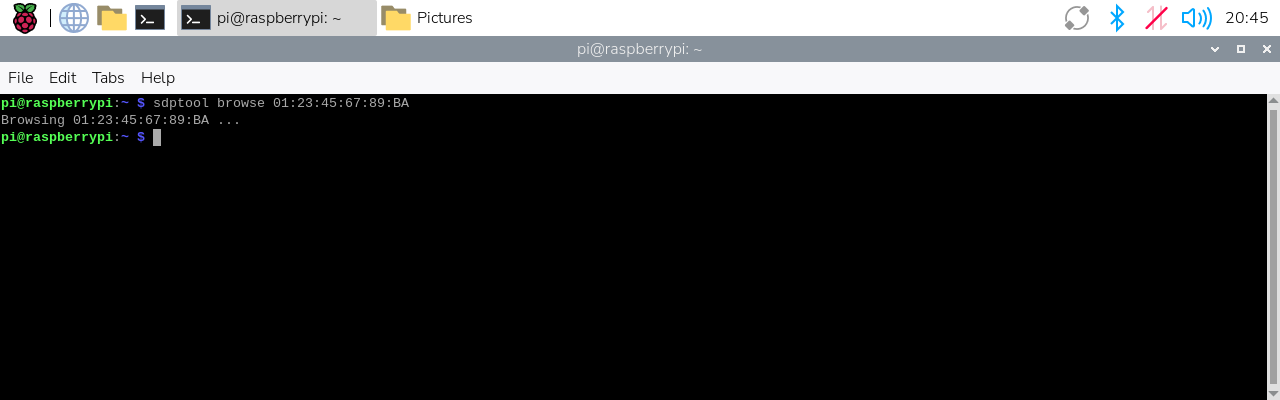

I have tried all the above including trusting in ctl as well as removing and then pairing in the hudiy UI
Sdptool returns
Re: OBDII Connection Refused
The UUID "00001101-0000-1000-8000-00805f9b34fb" visible in one of the previous screenshots is the UUID of SPP (Serial Port Protocol). It should be also visible in sdptool.
Could you please send us full logs from $HOME/.hudiy/log? You can zip the directory and then upload the zip file to this thread.

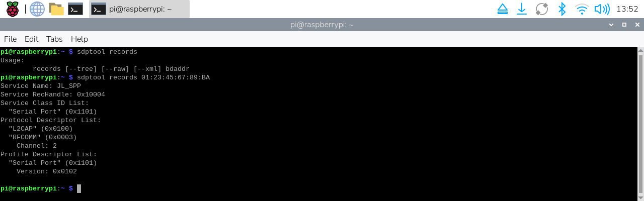

Please also post output of the
sdptool records 01:23:45:67:89:BA
command.

Output of sdptool record
Thanks for the sdptool output. It looks like your dongle listens for RFCOMM traffic on channel 2. By default Hudiy uses channel 1. You can change the channel number in main_configuration.json: https://github.com/wiboma/hudiy/blob/ma ... ion.md#obd (rfcommChannel). Try changing rfcommChannel to 2 and check if Hudiy is able to communicate with your dongle. A restart of Hudiy is required for the change to take effect.

That worked, rebooted and it was flawless, thank you so much for the assistance and really efficient troubleshooting
