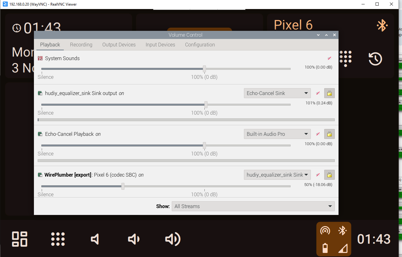

having some big issues currently getting my DAC to work nicely with hudiy
been reading through the forums trying to get an idea of what might be the issue, but it seems to be that hudiy cant pick the correct input
default on bootup config
pavucontrol playback.PNG (109.57 KiB) Viewed 397 times
this is the current bootup config that is not working
i've confirmed if I set the hudiy_equalizer_sink output to Built-in Audio Pro, that it plays fine and also has volume control, but I am not sure if that is the correct way to do it, and also on reboot it just re-configures back to not working
what can I do to get it to detect the correct output?

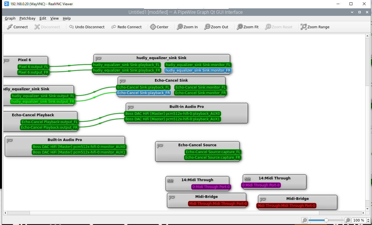

Re: Innomaker Raspberry Pi HiFi DAC Mini HAT
Audio stack in Raspberry Pi OS is handled by PipeWire and WirePlumber. Once the routing is configured, WirePlumber is responsible for restoring it after a restart and applying the last used volume levels.
hudiy_equalizer_sink and echo_cancel sink are PipeWire modules that are loaded from $HOME/.hudiy/share/hudiy_startup.sh
You can try setting master directly as your DAC and see if WirePlumber will be able to restore the routing after a restart. Please modify the hudiy_startup.sh as below and check what is the behavior
sink_exists "$EC_SINK" || pactl load-module module-echo-cancel aec_method=webrtc aec_args=\"voice_detection=false\" source_name="$EC_SOURCE" sink_name="$EC_SINK" sink_master=alsa_output.platform-soc_107c000000_sound.pro-output-0
You can also check the PipeWire and WirePlumber GitLab pages to see if similar issues with your DAC have been reported:
https://gitlab.freedesktop.org/pipewire ... /-/issues/
timunchy
Posts: 3
Joined: Tue Nov 04, 2025 2:02 am
Post by timunchy »
confirmed working- I had to remove master="$EC_SINK" and add master_sink but that worked!
thank you!
