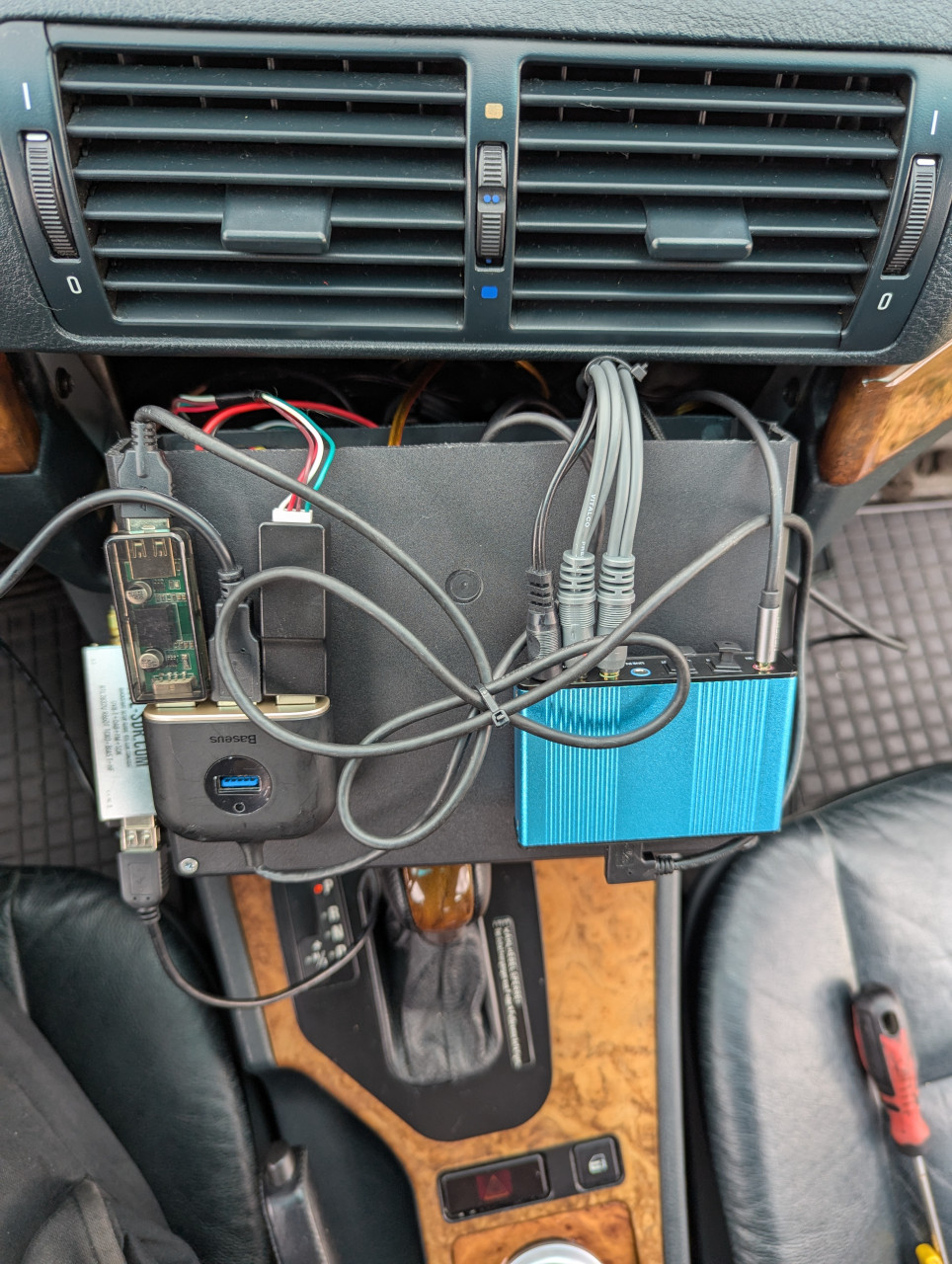

Okay after a 3 hour test drive i have two issues - now and again the volume buttons don’t work, is this possibly an issue with late detection of sound card?
Second, the siri crackle and muffled audio is still prevalent. it sounds like he’s on a very bad phone call.
Third every few mins or so i get a hiccup in the audio, almost as it drops for a split second then resumes as normal. every 15 mins or so there is a longer hiccup of 2 seconds. Is it a bandwidth issue, or buffering? It’s frustrating but i don’t know where it’s coming from.
Any thoughts on the above is much appreciated

My two cents to the topic might not be very helpful but I’m using the exact same cm6206 card with the same 5.1 to 4.1 mapping setup and everything works great. I have an ADUM3160 connected between the card and the rpi to eliminate ground loop. Maybe defective hardware in your case?

My issues only occur during carplay. Do you use carplay? The siri muffled voice isn’t the sound card as it happens with any sound card.

Unfortunately, we are unable to reproduce this issue on our side with this CM6206 card. It might be specific to your setup. Try to remove hudiy equalizer and echo cancel modules and check how your setup behaves with remap sink only. Also increasing the quantum in PipeWire configuration might improve audio playback.

jackv8 wrote: Thu Dec 18, 2025 12:26 pm My two cents to the topic might not be very helpful but I’m using the exact same cm6206 card with the same 5.1 to 4.1 mapping setup and everything works great. I have an ADUM3160 connected between the card and the rpi to eliminate ground loop. Maybe defective hardware in your case?
What steps did you follow to get it working? ive been trying to follow the thread but im not sure what you did to make it work. Im trying to do the exact setup as you and i cant get the rear out and bass out working.
Re: Cm6206 Output
hudiy wrote: Mon Dec 15, 2025 2:55 pm 1. Set card profile
pactl set-card-profile alsa_card.usb-0d8c_USB_Sound_Device-00 output:analog-surround-51+input:analog-stereo
