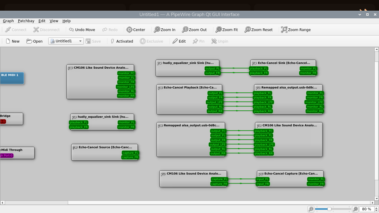

6. Verify routing with qpwgraph with below screenshot
