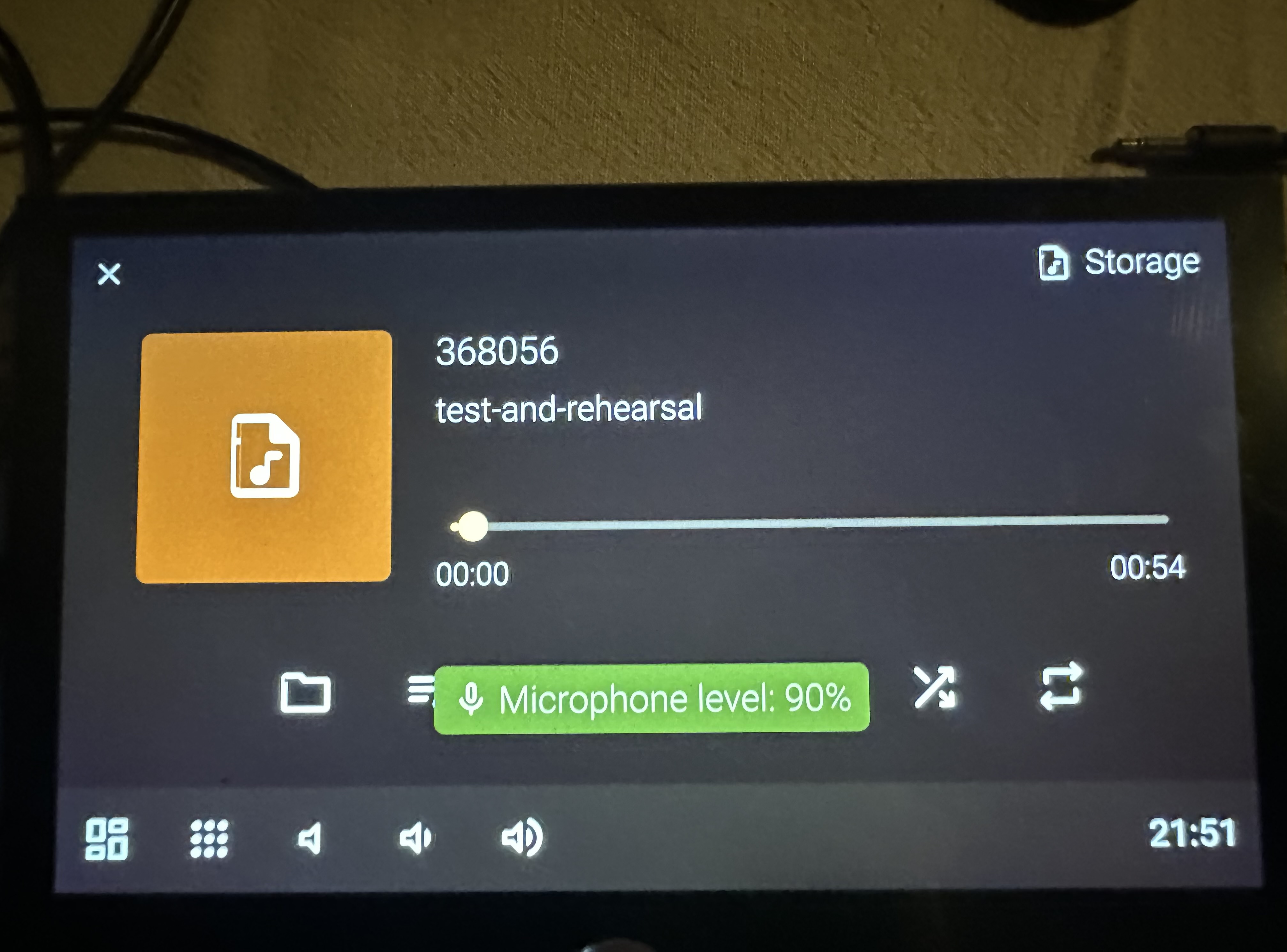

Before we make the change und Build the dummy, This was displayed on the Hudiy interface when I first started the music. However, I didn't have a microphone connected.

echo-cancel creates its own virtual microphone (echo-cancel source), even if no physical microphone is connected.Olli wrote: Sat Nov 15, 2025 10:42 pm Before we make the change und Build the dummy, This was displayed on the Hudiy interface when I first started the music. However, I didn't have a microphone connected.
The behavior of the echo-cancel module is poorly explained in the PipeWire documentation https://docs.pipewire.org/page_module_echo_cancel.html
The issue is that the virtual microphone created by the PipeWire module must take its input from somewhere, and if no physical microphone is present, it ends up taking the signal from the sink monitors. As a result, the audio output from the sinks (via monitors) is treated as echo and gets removed by the module. This should not happen - if there is no physical microphone, the echo-cancel module should do nothing (otherwise it does not make any sense - like in your case). According to our tests, this is how it worked on Bookworm.
If a physical microphone was connected, this problem would almost certainly not occur (as the echo-cancel capture would connect to the microphone output instead of sink monitor).
The issue occurred in "Hudiy UI" because the echo-cancel and equalizer modules are loaded before Hudiy starts (in mentioned script). However, it's not related to Hudiy itself - the problem comes entirely from how PipeWire handles the echo-cancel module (which is actually part of the PipeWire suite).
As you can see in the PipeWire documentation, the behaviour you're experiencing is not described there (yet it occurs).
Unfortunately, PipeWire has become the standard for audio handling on Linux, but its documentation remains quite poor (and the WirePlumber documentation is even worse) and the behaviour even changes between releases without any clear reason (that's why we always ask to make a backup before the upgrade).
