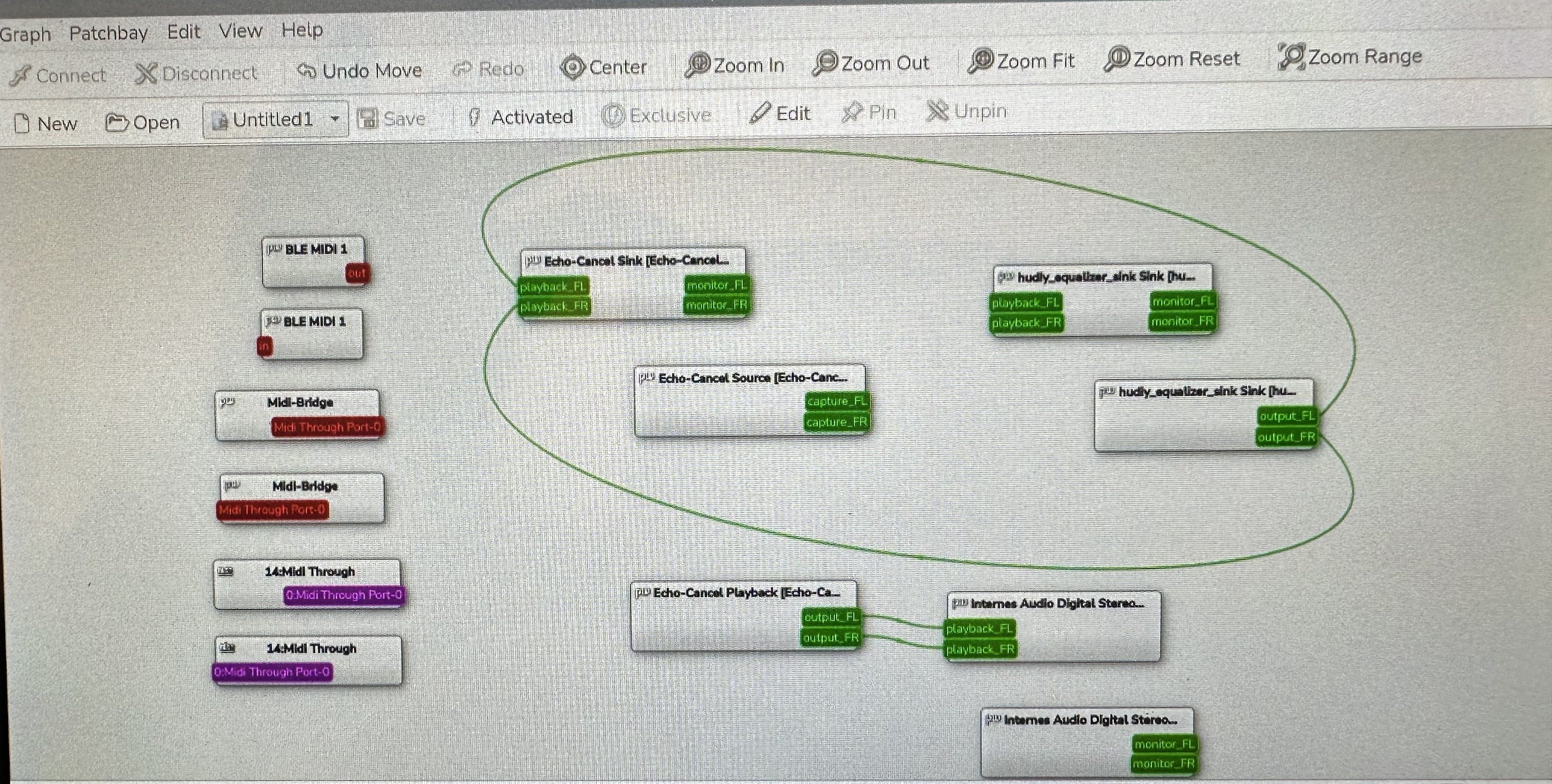

I installed qpwgraph and got the following image.
Re: PI5 Audio
The routing looks good.
During startup, Hudiy loads the equalizer and echo cancel modules. What is the output of the pactl list sinks command while music is playing?

In this setting, the sound from the iPhone plays at the OS desktop through the external speakers.
How can I set this as the default?
To get back to the Hudiy interface, I have to restart the Pi 5. But then all the connections I created in QPWGraph disappear.

Re: PI5 Audio
With the routing shown in the screenshot, the Phone bypasses the Equalizer and Echo Cancel modules. This means that echo cancellation and equalizer processing won't apply to the phone's audio output. It would be better to investigate why in your case the PipeWire doesn't output sound when those modules are loaded.
Does this issue occur only with Bluetooth audio, or also with CarPlay or the Storage Music Player?

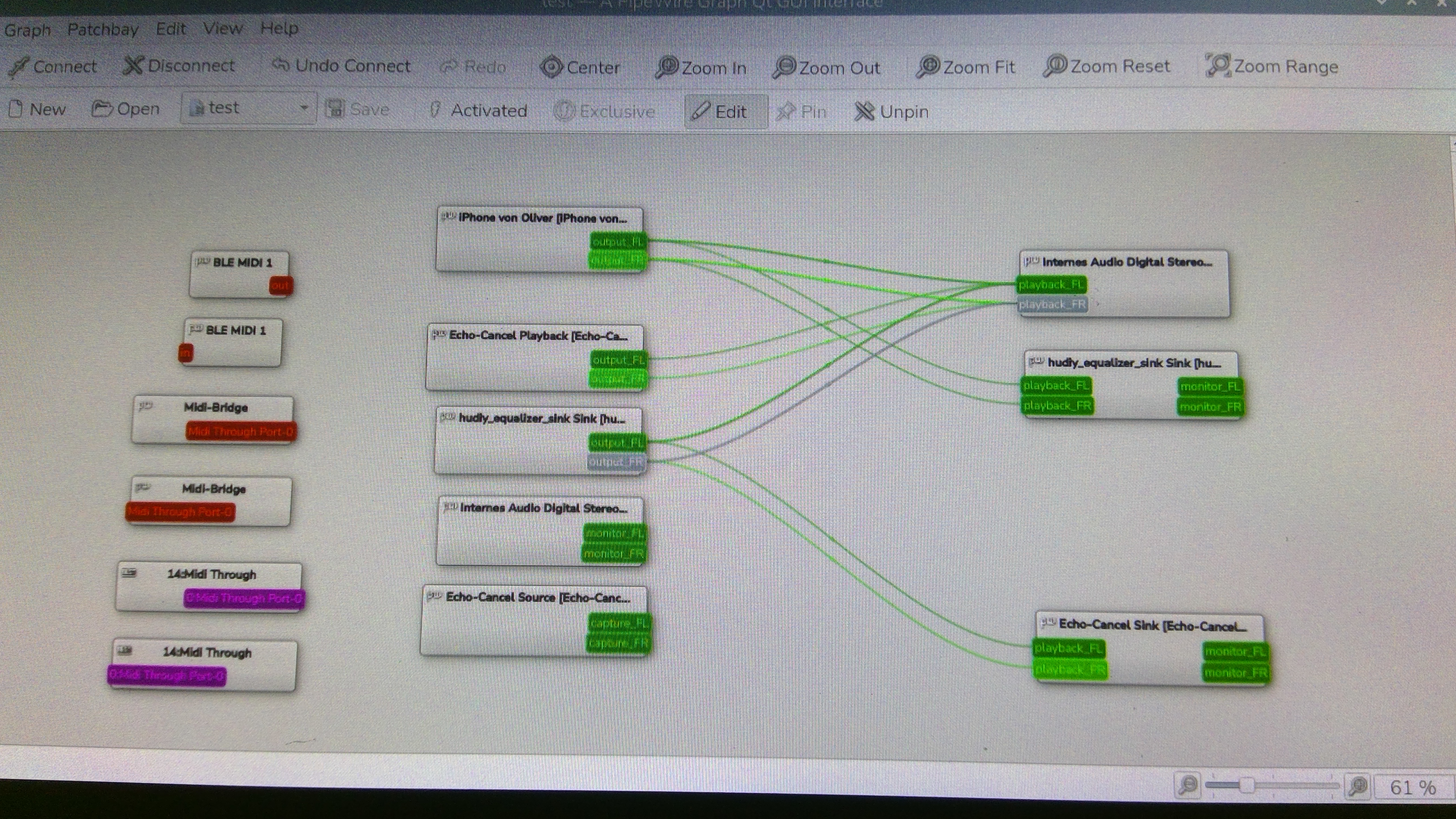

I've now configured this routing.
This means that both music files stored on the Pi and music streamed via Bluetooth from the iPhone will play in the OS desktop.
Unfortunately, nothing up in the Hudiy interface.
