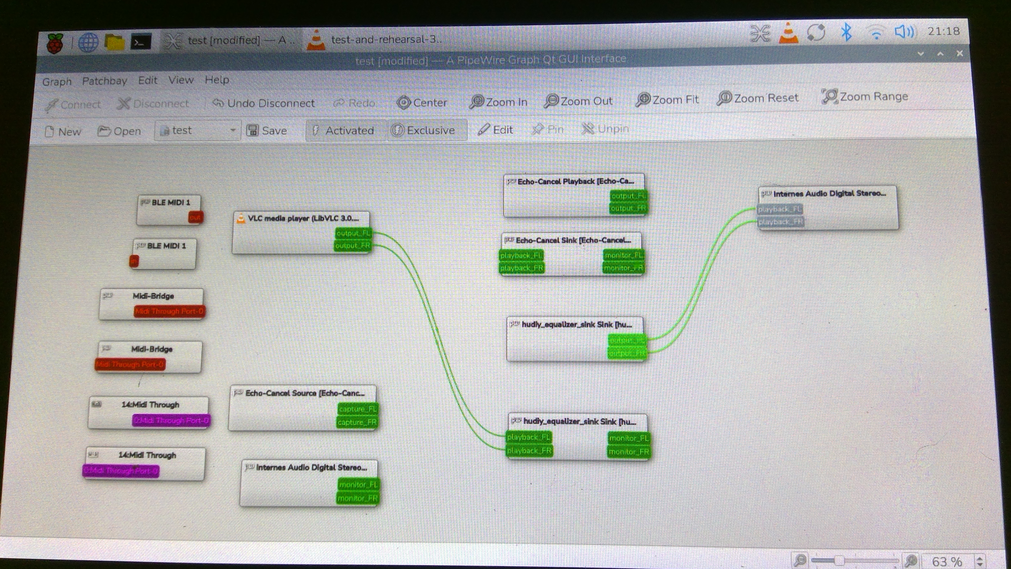

That means the audio from virtual sinks (equalizer, echo-cancel) reaches the sink of physical device but for some reason it is not audible when PipeWire uses virtual sink modules (equalizer, echo-cancel).
Is audio audible when in qpwgraph you disconnect hudiy_equalizer_sink from Echo-Cancel Sink and connect it (hudiy_equalizer_sink) to Audio Digital Stereo?

I've now tried it again with a Bluetooth speaker. Unfortunately, with the same result. The sound works on the OS interface, but nothing works on the Hudy interface.

With these two variants, there is absolutely no sound.

Here we have sound on the OS surface.

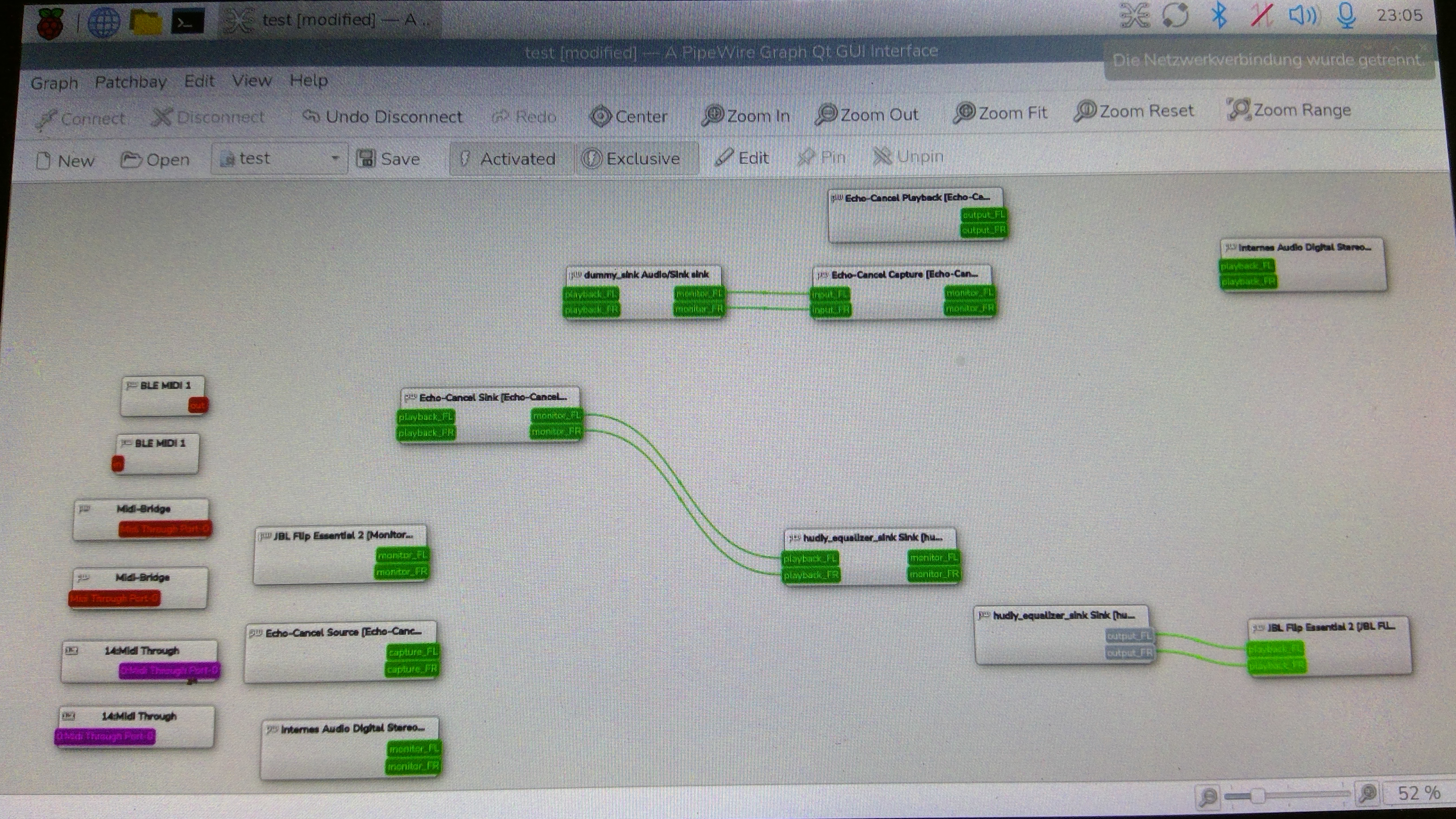

Anything that goes through the echo-cancel playback will not produce any sound.
Re: PI5 Audio
Thanks for testing. Most likely, the echo-cancel module is taking its input from one of the sink.monitor sources and treating the entire audio output as echo, effectively cutting it out.
Could you please run the following commands and check if the sound appears?
cd $HOME/.local/state/wireplumber
rm -rf *
sudo reboot

Re: PI5 Audio
Could you please replace the content of $HOME/.hudiy/share/hudiy_startup.sh file to
DUMMY_SINK="dummy_sink"
sink_exists "$DUMMY_SINK" || pactl load-module module-null-sink sink_name="$DUMMY_SINK"
sink_exists "$EC_SINK" || pactl load-module module-echo-cancel aec_method=webrtc aec_args=\"voice_detection=false\"
source_name="$EC_SOURCE" sink_name="$EC_SINK" source_master="${DUMMY_SINK}.monitor"
then reboot the Raspberry Pi (sudo reboot) and check if that works?
The modified script creates a dummy sink which (monitor) is used as the source for echo-cancel so that the module doesn't take audio from the real sinks that actually play sound.

Great... now music can be played on the Hudy interface even after multiple restarts.
