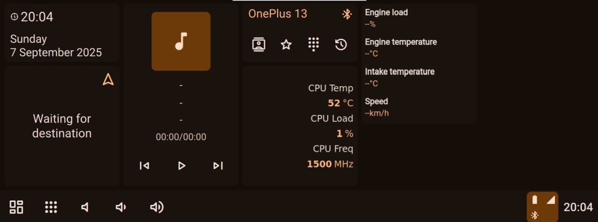

Here’s a sample config that adds https://github.com/wiboma/hudiy/blob/ma ... idget.html as a widget to the default dashboard:
(dashboards.json)
The dashboard:

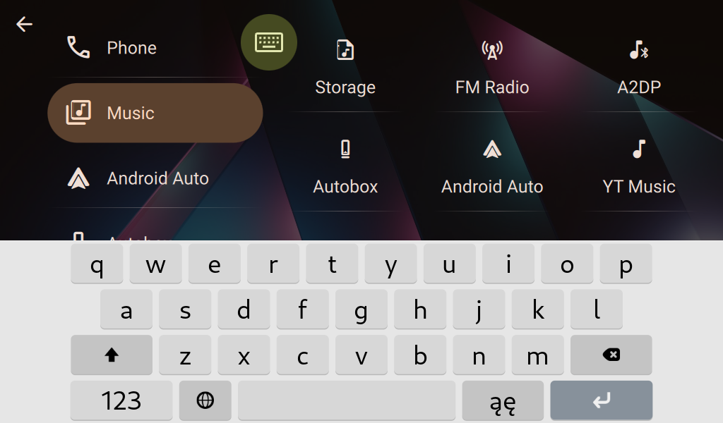

Ok I’m starting to get it . I was able to add web based apps like YouTube music, web radio and google maps. The issue I’m having is I can’t seem to get an onscreen keyboard to work . When I add it as an overlay it clicks out of my selection. Iv already removed all key bindings and hot keys . What’s a good way to implement an onscreen keyboard? Question 2 can I make a background option ? Iv tried using it as an overlay but it just covers the screen and leaves buttons unusable. How would I implement it into the app so it works ?
Re: Help with setup
Hudiy doesn’t have its own built-in keyboard yet, but we’re working on it.
For now, you can use squeekboard, which is the default on-screen keyboard on Raspberry Pi OS Bookworm. The tricky part is that there’s a bug in the Raspberry Pi fork: the version shipped with Bookworm uses the TOP layer, which means it won’t show correctly above fullscreen apps like Hudiy.
You can either patch and rebuild it yourself using dpkg, or just use our patched version included in the attached zip.
Here’s the relevant code: https://github.com/raspberrypi-ui/squee ... anel.c#L82 – it should be ZWLR_LAYER_SHELL_V1_LAYER_OVERLAY so that the keyboard shows up on top of fullscreen windows. The patched version in the zip already includes this change. You can simply replace it with the one in /usr/bin.
Squeekboard can be controlled via dbus (https://github.com/raspberrypi-ui/squee ... /README.md). With the patched version (so it displays properly above fullscreen windows), you can use Hudiy’s API and Overlays to show or hide squeekboard.
You can keep such an overlay always visible, or only show it on specific actions (like your custom action to launch YT Music) – https://github.com/wiboma/hudiy/blob/ma ... d#overlays (check the visibleOnActions parameter).

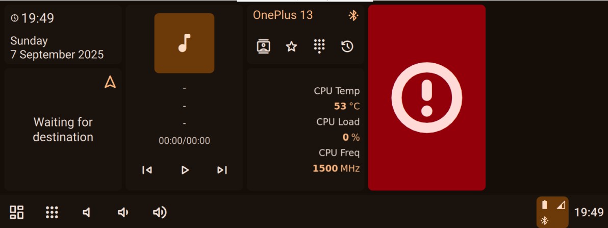

somehow I'm getting a big red exclamation mark when I edited the dashboards.json as stated above and started the http server using 12345 port automatically. I didn't setup the ELM system as I thought it should at least show the html display just without the real value. any idea what is happening? if I use the file path to the obd_widget.html in the dashboards.json, it work. this means I didn't setup correctly somewhere.
- usefilepath.jpg (45.95 KiB) Viewed 1406 times
- obd_widget_error.jpg (49.98 KiB) Viewed 1406 times
Re: Help with setup
This is caused by the fact that the URL specified in the widget is not accessible. Try checking if you can open this URL in your browser. There may be an issue with the path to the file, the HTTP server port, or the server may have been started after Hudiy was already running.

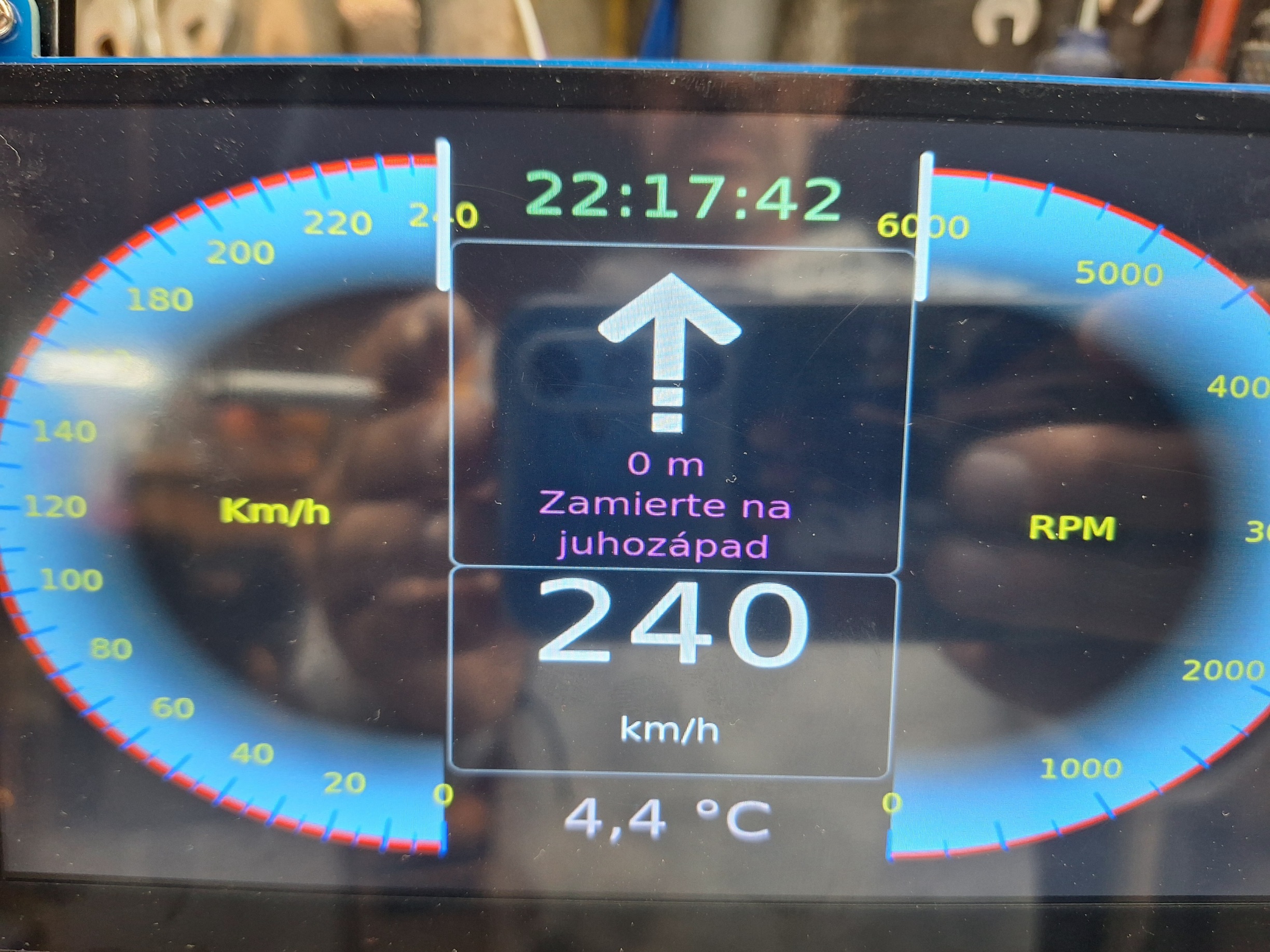

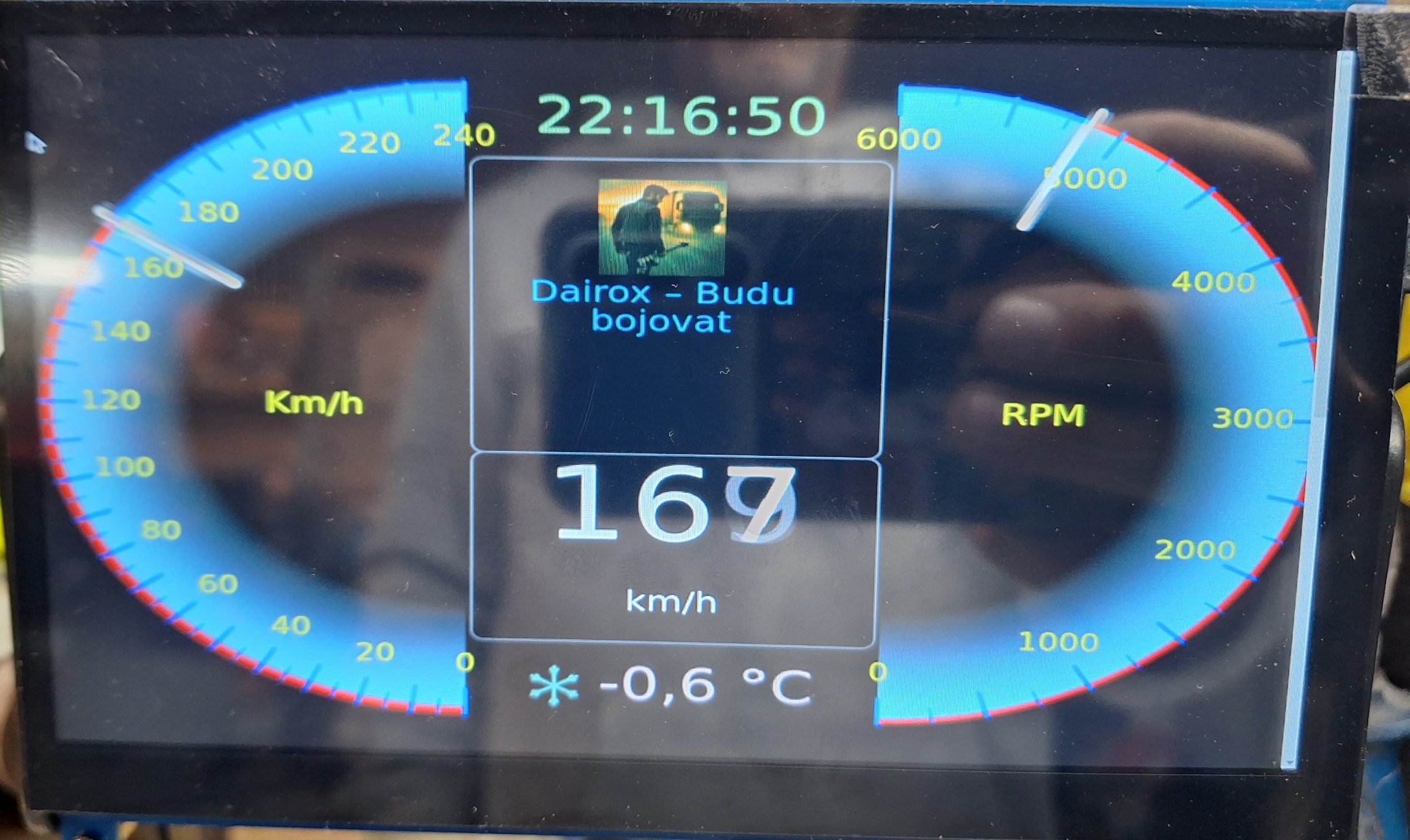

So, I managed to get the API working in my cockpit, for now I'll just send a photo of the project, the details will be fine-tuned. If there is interest, I'll send complete information about the project. Currently, 2 7" displays are connected. Display 1-7" touch 1024x567 (used for Android Auto, display 2-7" no touch 1024x768 (will be used instead of the dashboard). Many parameters can be set nicely in the code. When the cockpit is finally finished, I'll share it with you. Alternatively, you can send some suggestions for graphics, etc.
