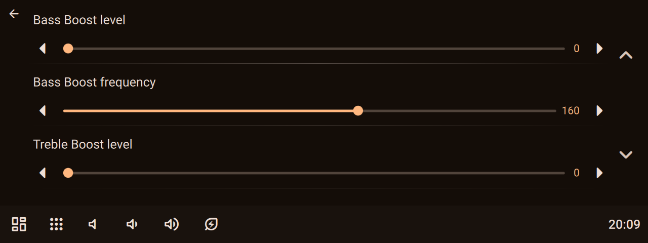

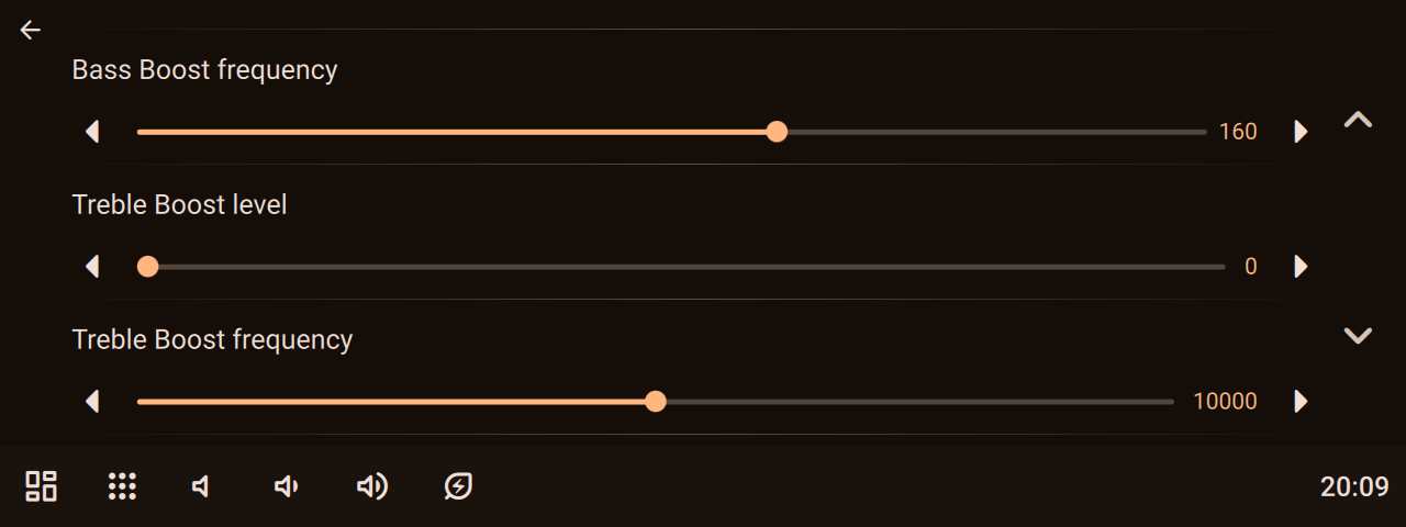

Equalizer
We optimized the DSP equalizer algorithms to reduce CPU usage. We also added Bass and Treble boost effects, allowing you to fine-tune high and low frequencies independently. While similar to the "Loudness" effect, this feature offers more granular control, letting you adjust both the frequency threshold and the gain.
The bass and treble boost effects can also be controlled via the API.

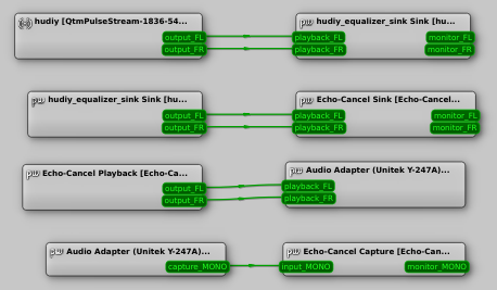

May I know why echo-cancel playback feed into hudiy_equalizer_sink and not the reverse?

wkl3968 wrote: Wed Jul 08, 2026 6:32 am Hi Hudiy,
The default routing should be as in the picture below. It didn't change between the versions. Echo cancel always outputs to the audio device.

Thanks. It seems like Hudiy still using a mixture of pipewire/wireplumber and pulseaudio for the audio setup. Is my understanding correct?

wkl3968 wrote: Thu Jul 09, 2026 5:21 am Thanks. It seems like Hudiy still using a mixture of pipewire/wireplumber and pulseaudio for the audio setup. Is my understanding correct?
PipeWire has a PulseAudio-compatible interface and it's a drop-in replacement for PulseAudio. PipeWire and WirePlumber are standard components to handle audio in Debian/Raspberry Pi OS and there is no other 'clean' way to serve audio from an application's POV.
