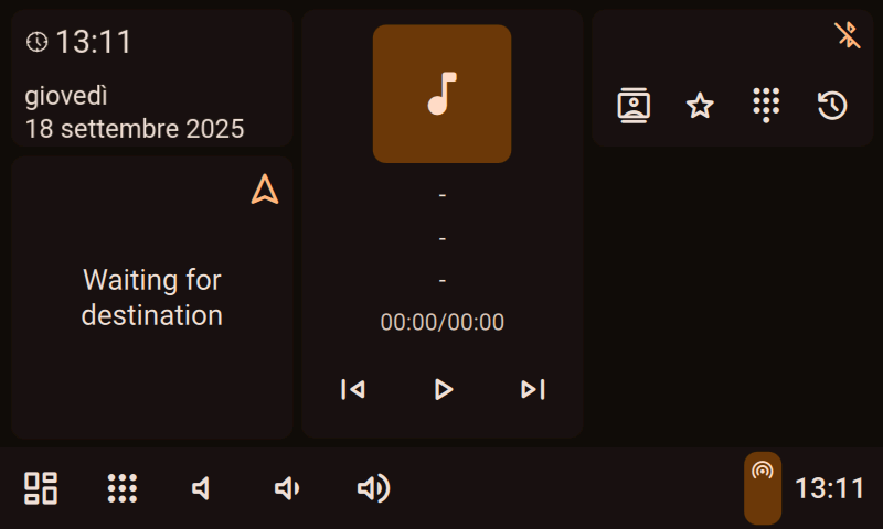

Good morning
I'm a new user of this software, and as soon as I resolve some issues, it will replace OpenAuto Pro. Great job guys. I'm new to this, and maybe my question is a trivial one, but how do I change the font size within HUDIY? The date disappears from the main screen (see photo). Thanks to anyone who can help me.

It looks like there’s a missing newline character between the weekday name and the rest of the date (might be specific for Italian locale).
We’ll check the widget and try to fix it. Fortunately, the widget can easily be recreated in HTML/JavaScript, where the date displays correctly.
Below is the code you can use in your dashboard (e.g., as a replacement for the date_time widget):

In the attachment, you’ll find the HTML file and the Roboto font.
You can also host this widget on a local HTTP server. Then it should load faster because the server can cache the Roboto font.
