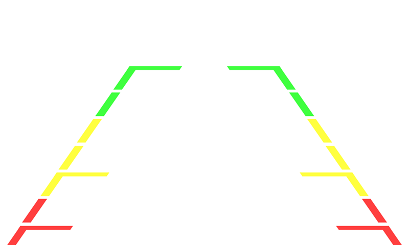

Another example,
this time the reversecamera with guidelines :-)
I've simply added a overlay with a transparent .png to the camera example from GitHub (https://github.com/wiboma/hudiy/blob/ma ... amera.html).
The image must be named "lines.png" or yo have to change the name in the html file/code.
And you have to put the image in the same folder as the html file.
