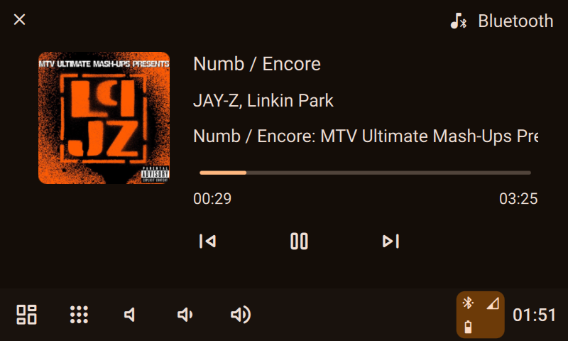

Hello together,
another example from me :-) This time a coverart downloader for bluetooth and storage music.
For Apple Carplay and Android Auto this is not needed because they already deliver the coverart.
Update 2025/08/23:
- VENV bootstrap (~/.venv/hudiy) + package check and automatic install if missing
- Parallel providers: iTunes (600x600) + Deezer (500x500)
- Early-stop: as soon as a very strong match appears (EARLY_STOP_SCORE)
- Only log the chosen winner (no query spam)
- Send cover ONLY if cached / in local DB or right after download
- Inject immediately after download; save cache/DB asynchronously
- Local DB: ~/.cache/hudiy-coverart/covers_db.json (maps key -> filename + meta)
- Cache: ~/.cache/hudiy-coverart/<key>.jpg
- Offline backlog: ~/.cache/hudiy-coverart/pending/<key>.json
- Cleans metadata (cut anything after "•") if Spotify adds "video available"
- Source allowlist (MediaSource): only STORAGE and A2DP (cache/DB + downloads)
- For STORAGE requests, after sending cover, embed it into the audio file (MP3/FLAC/M4A)
- One-shot library pass at startup: find MP3 without covers, download+embed in batch
And here ist the only negative point:
- the script has to run everytime you want to have coverarts while playing music via bluetooth.
At this moment i cannot provide how to put the python script in the autostart because I haven't dealt with it yet.
Big thanks goes to ChatGPT :-D
coverarts.zip
(12.92 KiB) Downloaded 86 times
