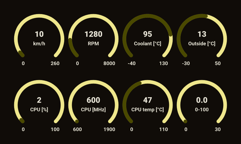

I've tested the dasboard with pre installed browser from bookworm and the image is very sharp/crisp:
sharp
sharp
Now i've made an application in hudi with a new menu entry. If i open the dasboard via hudi now, the image from the dashboard is not that sharp as in the browser:
blurred
blurred

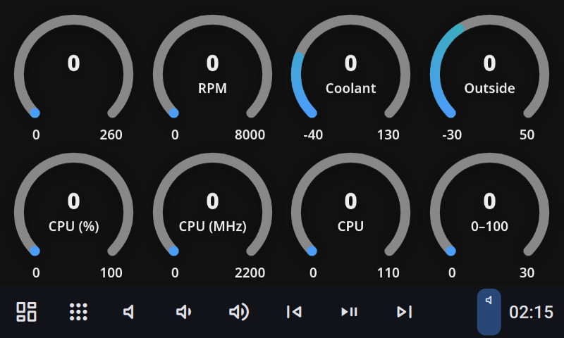

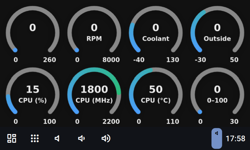

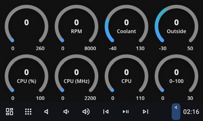

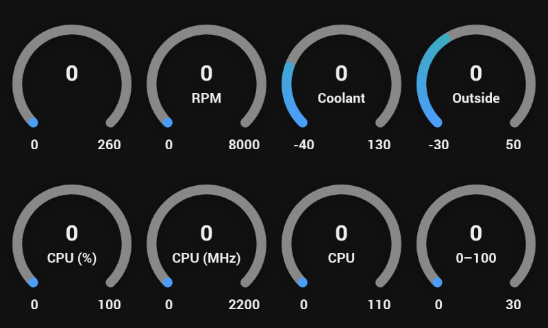

Here are some comparison images with your gauges:
Original:
Post-processed:
We’ll be adding this feature in the next release, coming out in September.
