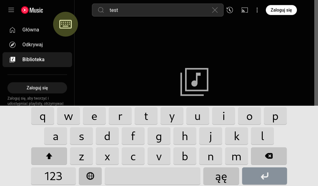

Ok I’m starting to get it . I was able to add web based apps like YouTube music, web radio and google maps. The issue I’m having is I can’t seem to get an onscreen keyboard to work . When I add it as an overlay it clicks out of my selection. Iv already removed all key bindings and hot keys . What’s a good way to implement an onscreen keyboard? Question 2 can I make a background option ? Iv tried using it as an overlay but it just covers the screen and leaves buttons unusable. How would I implement it into the app so it works ?

Hudiy doesn’t have its own built-in keyboard yet, but we’re working on it.
For now, you can use squeekboard, which is the default on-screen keyboard on Raspberry Pi OS Bookworm. The tricky part is that there’s a bug in the Raspberry Pi fork: the version shipped with Bookworm uses the TOP layer, which means it won’t show correctly above fullscreen apps like Hudiy.
You can either patch and rebuild it yourself using dpkg, or just use our patched version included in the attached zip.
Here’s the relevant code: https://github.com/raspberrypi-ui/squee ... anel.c#L82 – it should be ZWLR_LAYER_SHELL_V1_LAYER_OVERLAY so that the keyboard shows up on top of fullscreen windows. The patched version in the zip already includes this change. You can simply replace it with the one in /usr/bin.
Squeekboard can be controlled via dbus (https://github.com/raspberrypi-ui/squee ... /README.md). With the patched version (so it displays properly above fullscreen windows), you can use Hudiy’s API and Overlays to show or hide squeekboard.
You can keep such an overlay always visible, or only show it on specific actions (like your custom action to launch YT Music) – https://github.com/wiboma/hudiy/blob/ma ... d#overlays (check the visibleOnActions parameter).
How to set it up:
  1. Create a simple Python script based on https://github.com/wiboma/hudiy/blob/ma ... hAction.py.
    This script should register an action, for example toggle_osk_visibility.
    The logic will just call dbus to show/hide squeekboard whenever toggle_osk_visibility is dispatched.
  2. Your HTML overlay, when clicked, should trigger the toggle_osk_visibility action. Hudiy will forward it to the Python script, and the script will show or hide the keyboard.
Attached archive contains full example and the patched squeekboard. Ready to configure and use.
To run the Python script, it’s best to create a venv so dependencies don’t clutter your system. For example:
python3 -m venv /destination/path/to/your/osk/venv --system-site-packages
source /destination/path/to/your/osk/venv/bin/activate
pip3 install pydbus protobuf protobuf websocket-client
And start the script:
python3 osk.py
The osk_overlay.html file needs to be served via an HTTP server. You can find instructions on how to install and run one in the README on our GitHub: https://github.com/wiboma/hudiy/blob/ma ... /README.md
Finally, you can configure it in overlays.json (adjust the size to your screen). For example:
            "identifier" : "OSK",
            "action" : "",
            "width" : 80,
            "height" : 80,
            "x" : 0.0,
            "y" : 0.0,
            "visibility" : "NATIVE_UI_ONLY",
            "url" : "http://127.0.0.1:12345/osk_overlay.html",
            "controlAudioFocus" : false,
            "audioStreamCategory" : "NONE",
            "visibleOnActions" : [
            "staticPosition" : false
Also, make sure to disable handleKeyboardEvents (https://github.com/wiboma/hudiy/blob/ma ... pplication), so the interface doesn’t intercept key presses from squeekboard. You’ll still be able to control the interface with buttons through the API.
