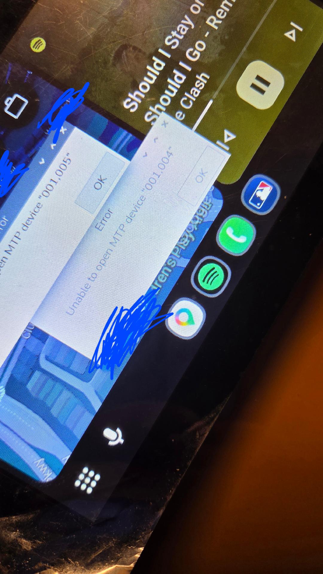

Additionally, when connecting the phone via USB I receive the following error (see attached please)
Re: Audio Not working Hudiy
This popup comes from pcmanfm (Raspberry PI file manager). Pcmanfm tries to mount connected USB device as an MTP drive. You can disable it in pcmanfm settings.
