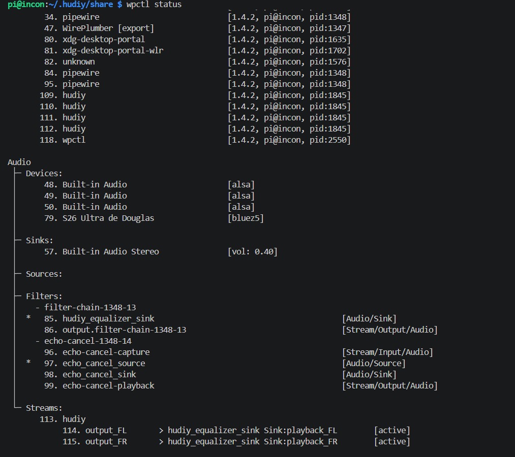

Hello, I install hudiy in raspberry 4 with trixie a d haver no sound I inspect with wpcl status and no find none áudio source. What can be see in imagem and my start-up is

It is very likely that the problem is related to the echo cancel module. When there is no physical microphone input in the system, the echo cancel module cuts off the audio.
The solution is to either connect a microphone input (e.g., by using a USB sound card) or to disable the echo cancel module if you are not using a microphone in your setup. To prevent the echo cancel module from loading, replace the contents of $HOME/.hudiy/share/hudiy_startup.sh with the following:
