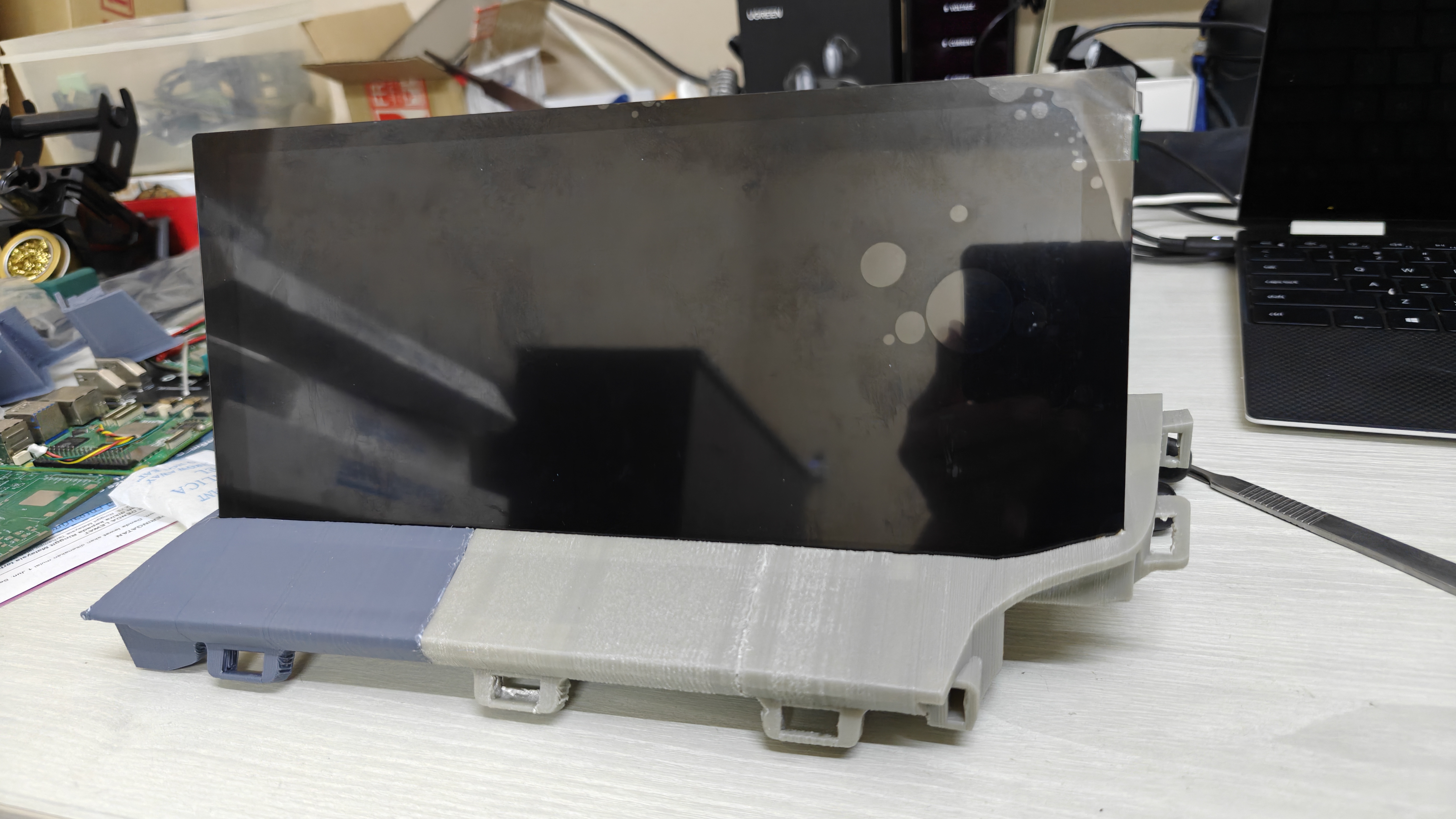

I'm working on a bigger screen infotainment using HUDIY for my Mazda MX5 ND. Still work in progress with custom PCB design and custom casing. It takes time but will share it here.

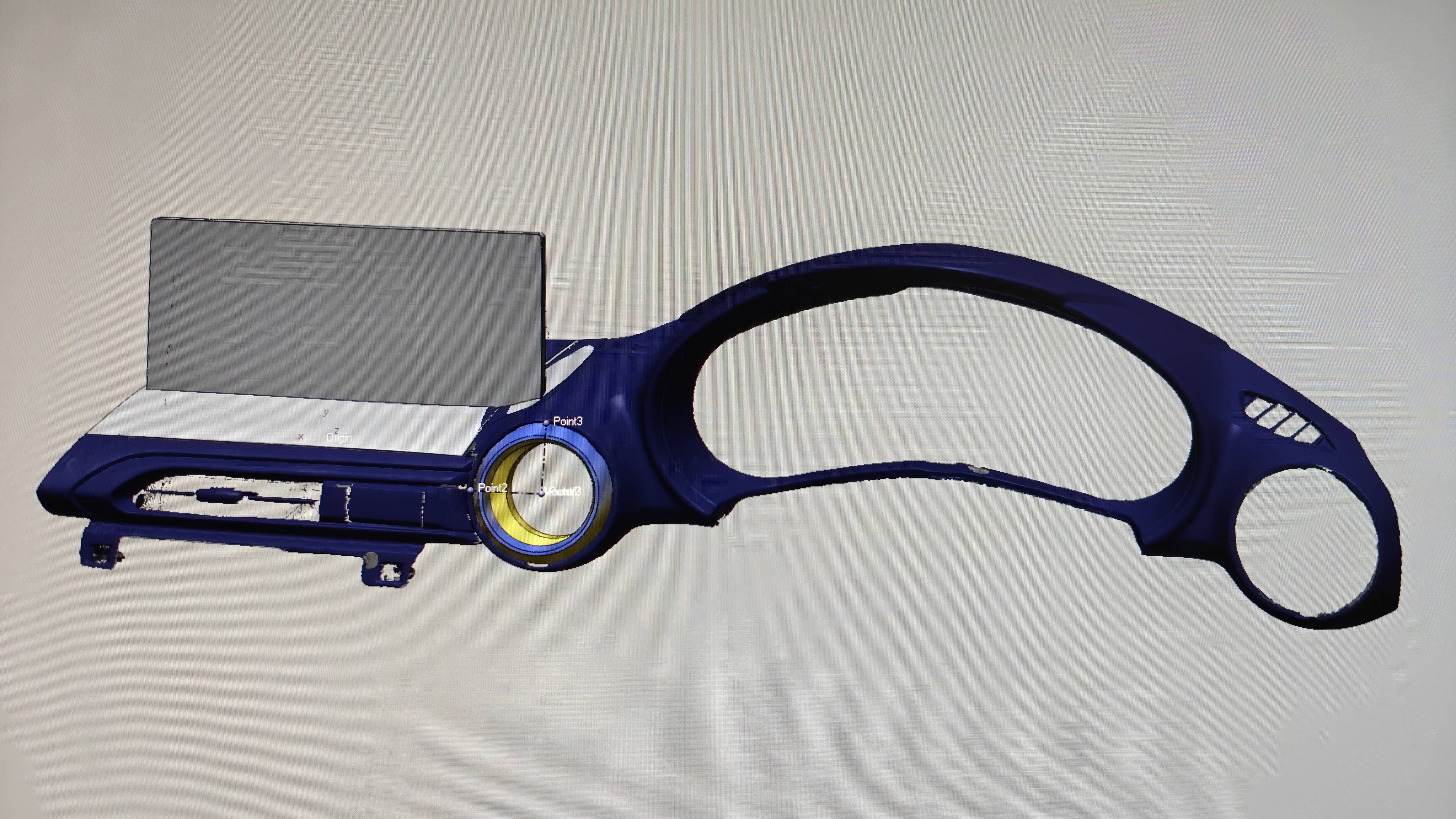

This is the dashboard design with a 10.4 inch screen. Still work in progress.

Love it, I'm 90% completed on my NC build. Have you custom 3d printed the screen base or utilising existing trim with modifications?
Posts: 117
Re: Mazda MX5 ND Build
Yes. I 3d scan and remodel the trim needed. A lot of work started this idea when HUDIY started.
