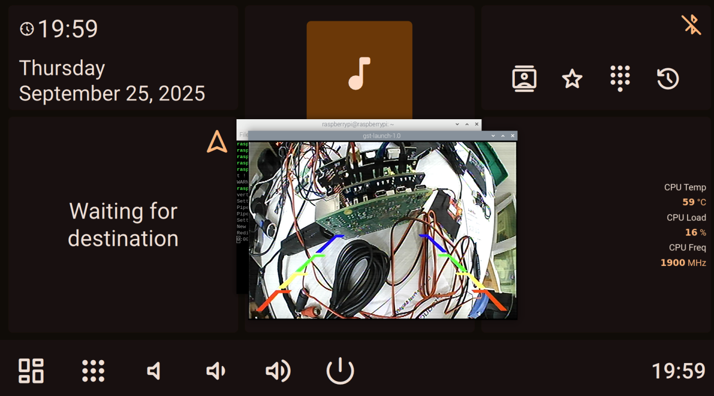

The default pipeline, as suggested in the main config file, doesn't work and I'm getting a black screen. That is why I wanted to test in terminal first. I also tried the ReverseCamera.py in the example and no video capture. the video can be streamed using "gst-launch-1.0 v4l2src device=/dev/video0 ! videoconvert ! autovideosink" as shown in the picture. any idea?

Does it work with:
v4l2src device=/dev/video0 ! videoconvert ! glupload ! qml6glsink name=video-sinkHudiy Team
