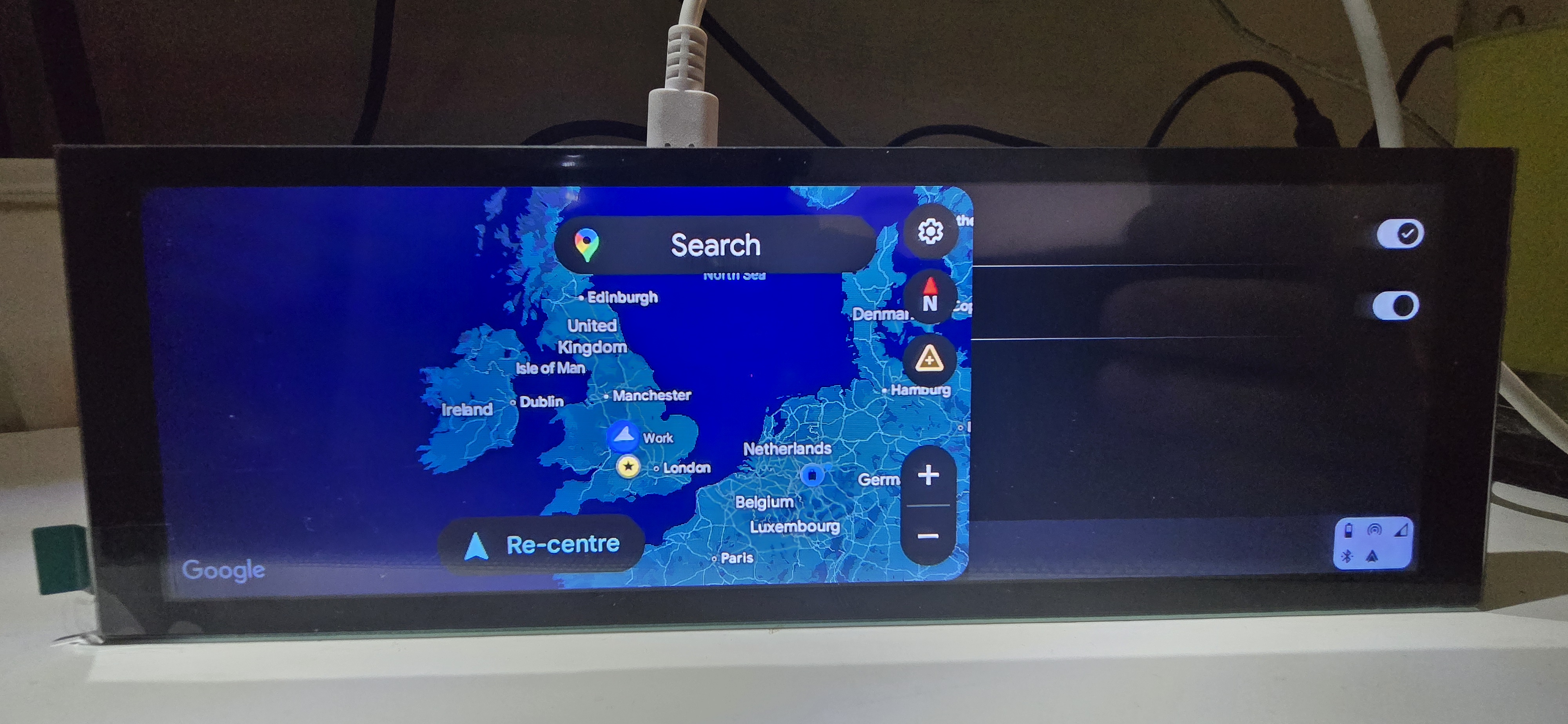

I bought a Waveshare 17916 screen for my Hudiy (running on a Pi4B)
Works beautifully aside from i cant seem to set Android Auto window properly it auto loads to a "default size" of approximately 600x400
Screen resolution is 1280x 400 in landscape mode, i set the fields in ~/.hudiy/share/config/main_configuration.json (as sudo) as follows to allow some room for the task bar an changed no other value.
..."androidAuto": {
"width": 1280,
"height": 350, ...
after a save and reboot the window stayed the same size as before (approximately 600x400)
Is there a minimum size the AA window has to be? or am i missing a different arg/setting?

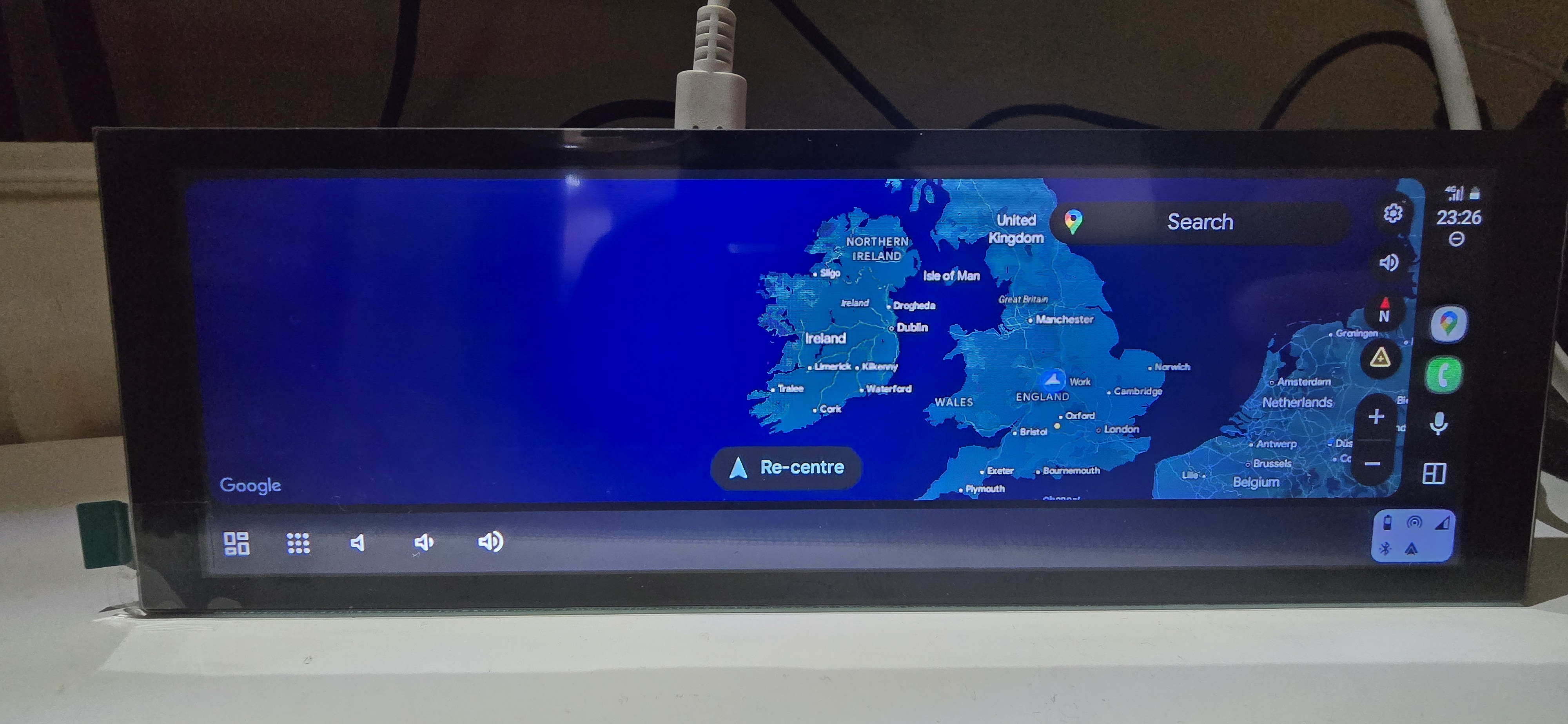

Did the 2nd time... thanks though!
Re: Waveshare 17916, Android Auto Window Size
You are welcome. Thanks for the feedback. It could be a JSON syntax issue. In JSON, every brace and comma matters. There are various validators available online to check the syntax before saving the file, e.g., https://jsonlint.com/.
BTW, if you want to keep the Bottom Bar exposed only for the volume buttons, you might consider using the built-in volume overlay (Menu -> Hudiy -> Settings -> Overlays) and setting its visibility to 'Projection' (it will then only appear on Android Auto / CarPlay). Once the overlay is visible, you can adjust its position using a drag & drop gesture.
D3dl3g
Posts: 10
Joined: Mon Feb 09, 2026 9:17 pm
Post by D3dl3g »
youd think id have learnt about JSON by now...
yep, give it time ;) im only an hour into playing with it, purchased earlier today. thanks for the suggestions :D
