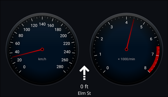

I had a quick question regarding one of the marketed extensions/widgets for hudiy. I noticed that you show this analogue speed/tachometer/navigation cluster running on a separate display on your YouTube page as well as the main GitHub repo, but I haven't been able to figure out just where the template for this is. Also, I wondered what would be the best way to modify the look of this (maybe change the background and add a digital read out of the speed), and if there is a way I could modify it via my computer without having to re-upload it to the head unit every time I made a change (as I assume it is a HTML/JS file integrated with the Hudiy API).

The items visible in the screenshot are available on our GitHub https://github.com/wiboma/hudiy/tree/ma ... les/api/js. You can find an example configuration on our forum showing how to display them on the Hudiy interface using overlays: viewtopic.php?p=212&hilit=tacho#p212
The tacho and speedo examples use the Hudiy API, which allows you to easily communicate with the ELM327. You can also modify the HTML/JS to use your own data source - in that case, Hudiy will simply act as the display.

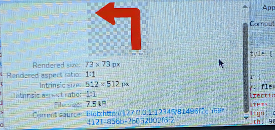

I successfully created the GPS Navigation Overlay like the one shown above. I have an issue and a question...
Issue:
The navigation overlay (copied directly from the github: navigation.html) works well and the text is white, but the icons/arrows are RED. Any idea why this would be? If I open the html file in a browser window while Hudiy is running, the arrows are white, but in an overlay in Hudiy they're re

In the example image shown above, is that three separate overlays displayed at once, or were all combined into one html file for a single overlay? (or was that a photoshopped mockup?) I'm just trying to figure out layout/space limitations.

In the mentioned screenshot, three overlays are visible (tacho.html, speedo.html, and navigation.html). You can position the overlays in the overlays.json configuration file, by using a drag & drop gesture (after a long press on the selected overlay), or by using the arrow keys (left, right, up, down) and 't' (toggle overlay).

Initially the maneuver icon was red in both a browser window AND in the Hudiy overlay. Then I tried the filter: brightness(0) invert(1); trick and it only worked in the browser window, but didn't have an effect in the Hudiy overlay.
Re: Question Regarding Gauge Cluster Widget
Posted: Mon Mar 09, 2026 10:40 pm
Could you please post a screenshot? What navigation app do you use? Is it Raspberry Pi or an x86_64 platform?

So the image is coming through as red.
