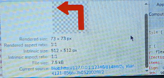

I successfully created the GPS Navigation Overlay like the one shown above. I have an issue and a question...
Issue:
The navigation overlay (copied directly from the github: navigation.html) works well and the text is white, but the icons/arrows are RED. Any idea why this would be? If I open the html file in a browser window while Hudiy is running, the arrows are white, but in an overlay in Hudiy they're re

Could you please post a screenshot? What navigation app do you use? Is it Raspberry Pi or an x86_64 platform?

Raspberry Pi 4b - Trixie - latest version of Hudiy
Google Pixel 10 - Waze for navigation
So the image is coming through as red.
Interesting thing I discovered last night, though...
The addition of "filter: brightness(0) invert(1);" eventually DID work. But only after I started a new HTTP server on a different port (and pointed the overlay settings there. Is Hudiy storing the html in cache? I had to start a new server on a different port to see change in Hudiy, but a browser window loaded the latest code. The other thing that reinforces this thought is... I can restart the Pi and NOT start the HTTP server, and the navigation.html will still work in Hudiy but not in a browser window. That's why I was seeing different behavior in a browser window vs Hudiy. That's why I wonder if there is a cache that needs to be cleared to see my changes take effect?

Still, why do you think the icons would be coming through in red?
