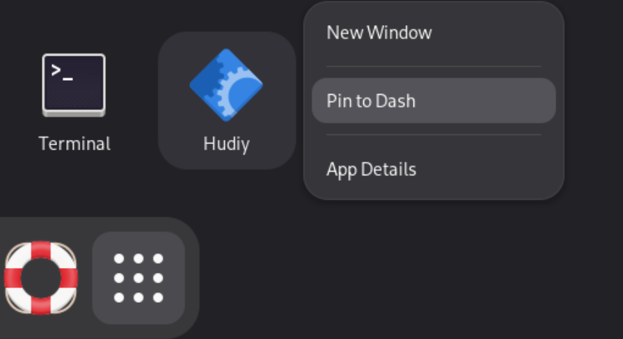

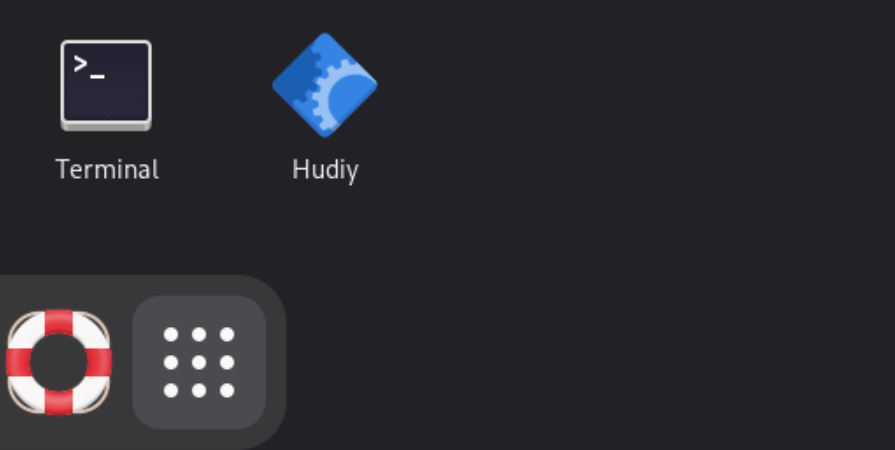

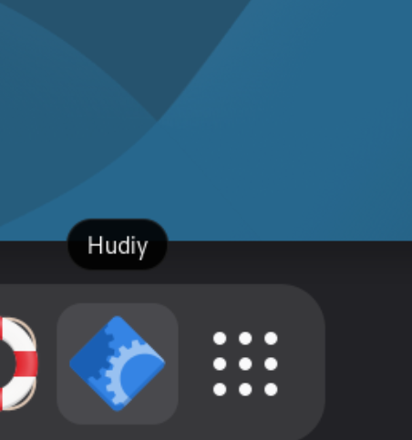

You can just copy hudiy.desktop file to .local and it will show in Gnome launcher. Then you can e. g. right click on the icon and pin it to the dash.
https://specifications.freedesktop.org/ ... ry/latest/
cp $HOME/.config/autostart/hudiy.desktop $HOME/.local/share/applications/
