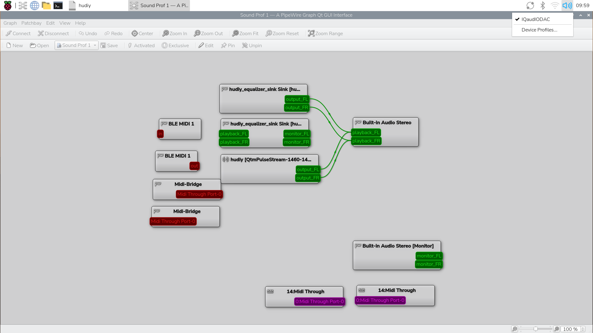

First,thank you for creating this great DIY vehicle infotainment software. I have tried to read through most of the topics that are similar to my problem in these threads and also scoured the internet but I was unable to find an exact duplicate. I'm giving up for now as I can't seem to figure out a solution. Please forgive me as I'm not great at all in using the terminal and I'm no programmer. It took me days just to figure out how to access and change the settings on both the RPI and in Hudiy. I did get some good information from another poster who also had IQAudio problems and I was at least able to change some settings on the $HOME/.hudiy/share/hudiy_startup.sh and also on the rapsberrypi config.txt by following some of your instructions. I changed the EC SINK= from Echo-Cancel Playback to hudiy_equalizer_sink as I wasn't getting any sound after start up until I checked the IQAudio from the volume bar on the desktop. After the changes sound comes out now after start up to the DAC, however the audio is terrible in mono and I still have to go to the volume bar on the desktop and select the IQAudio to change to stereo. How would I make the IQAudio permanently checked on the volume bar dropdown?
EC_SINK="hudiy_equalizer_sink"
sink_exists "$EC_SINK" || pactl load-module module-echo-cancel aec_method=webrtc aec_args=\"voice_detection=false\" source_name="$EC_SOURCE" sink_name="$EC_SINK"
I've also attached the before and after pics of the qpwgraph.
Thanks

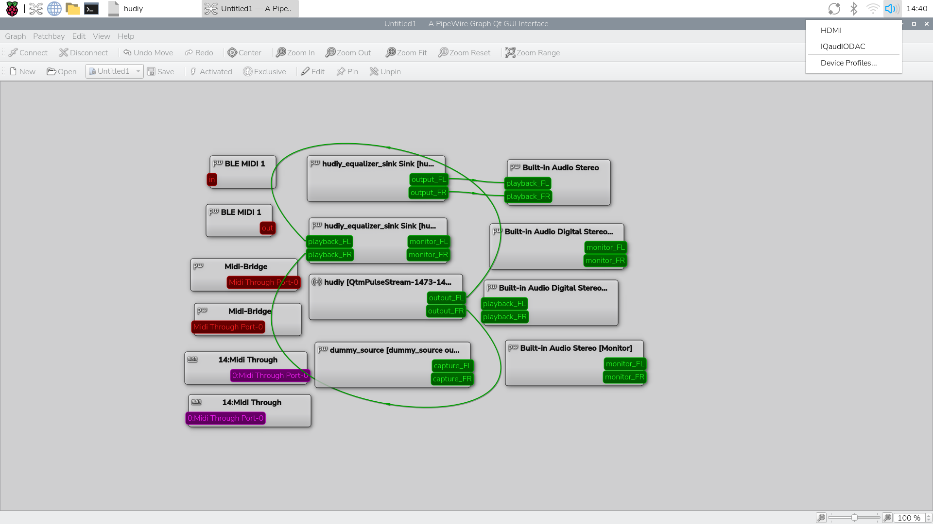

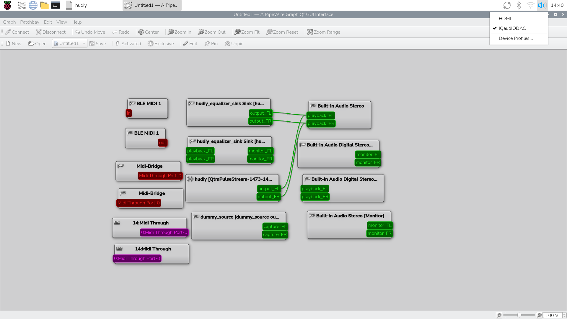

Thanks for the quick reply. So I followed the above instructions and implemented the changes. I did it first with my original install and also after a fresh re-install without changing anything in the raspberrypi config.txt settings. Unfortunately, it became worse with the dummy source. The volume is a lot lower and the sound is still mono with some crackling and static now. Also, the IQAudio DAC on the dropdown from the volume bar is still not checked. When I check it and select the DAC, the sound becomes about 20 times better. It's a very big difference in audio quality change when the DAC is enabled. It's almost HD quality, the bass is deeper and fuller and the highs and vocals are way more defined and detailed. It seems like even with the many changes in settings that I've tried, the DAC still needs to be checked and enabled manually on the desktop. Below are the images with the dummy source before and after enabling the DAC.

Re: IQAudio DAC Starts Up in Mono
By default, PipeWire/WirePlumber sets the volume level of audio devices to 40%. From qpwgraph, it is visible that the sink-input and all sinks are in stereo mode.
The screenshot with selected IQaudiODAC shows that sink-inputs are being routed by PipeWire directly to the device sink (bypassing ladspa-module with equalizer). This might be a compatibility issue in PipeWire between your DAC and the ladspa-module.
