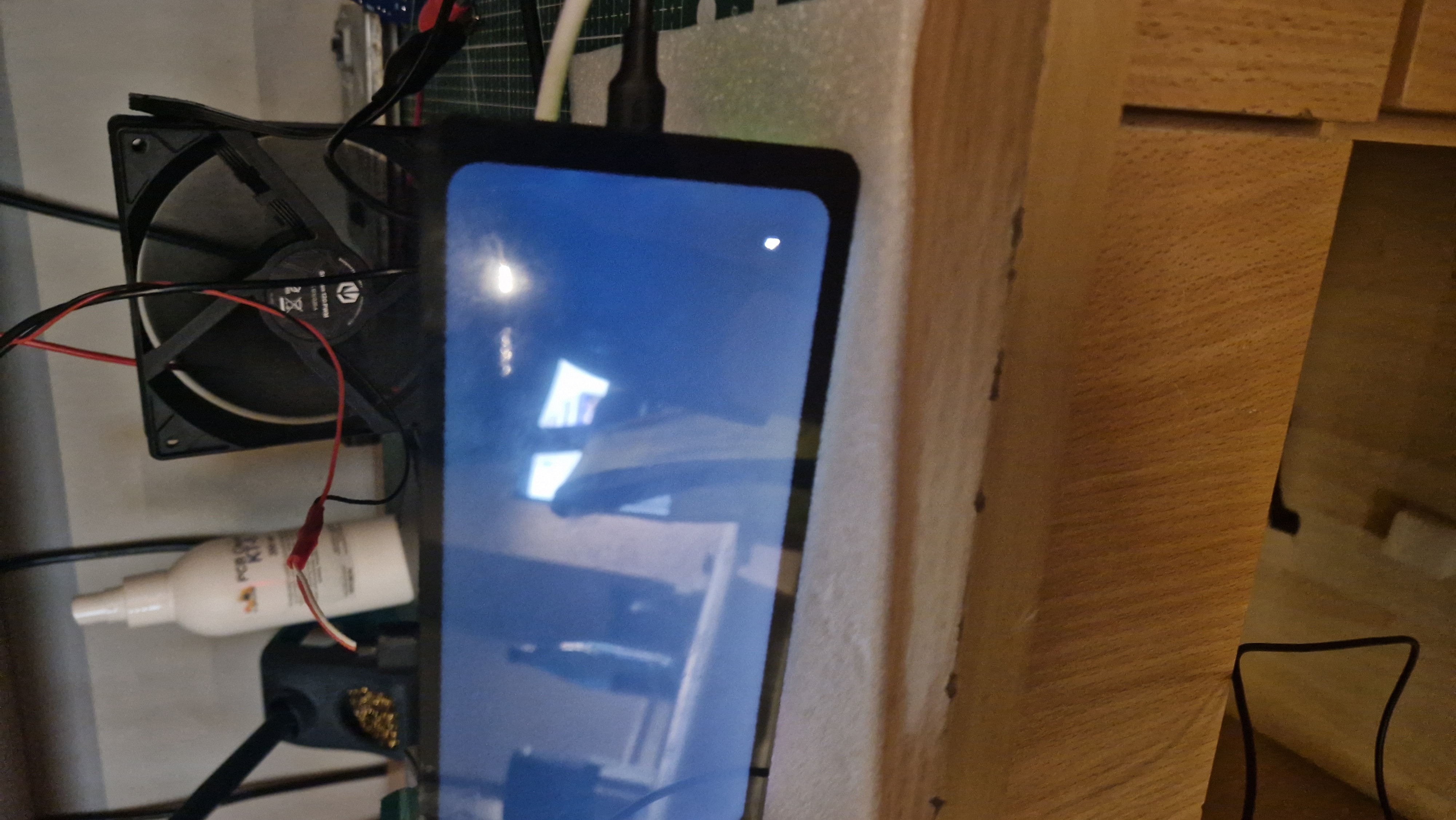

by Twardowsky29
Sure, here's the pic:

Ah, so you mean the mouse cursor. The mouse cursor is managed by labwc, which is the default window compositor on Raspberry Pi OS.
There isn't a perfect way to hide the cursor in labwc (no simple config option), but starting from version 0.8.4 labwc includes a HideCursor action that can be bound to a keyboard shortcut or a windowRule.
As a workaround you can assign HideCursor and WarpCursor to keyboard shortcut in $HOME/.config/labwc/rc.xml like (take the touch node from your current config):

then using the wtype tool you can simulate defined key binding e. g. in /etc/xdg/labwc/autostart:
sudo apt install wtype
sudo nano /etc/xdg/labwc/autostart
/usr/bin/wtype -M alt -M logo h -m alt -m logo
/usr/bin/lwrespawn /usr/bin/pcmanfm-pi &
/usr/bin/lwrespawn /usr/bin/wf-panel-pi &
/usr/bin/kanshi &
/usr/bin/lxsession-xdg-autostart

by Twardowsky29
Okay, I managed to get it working, looks great now , thanks a lot.
