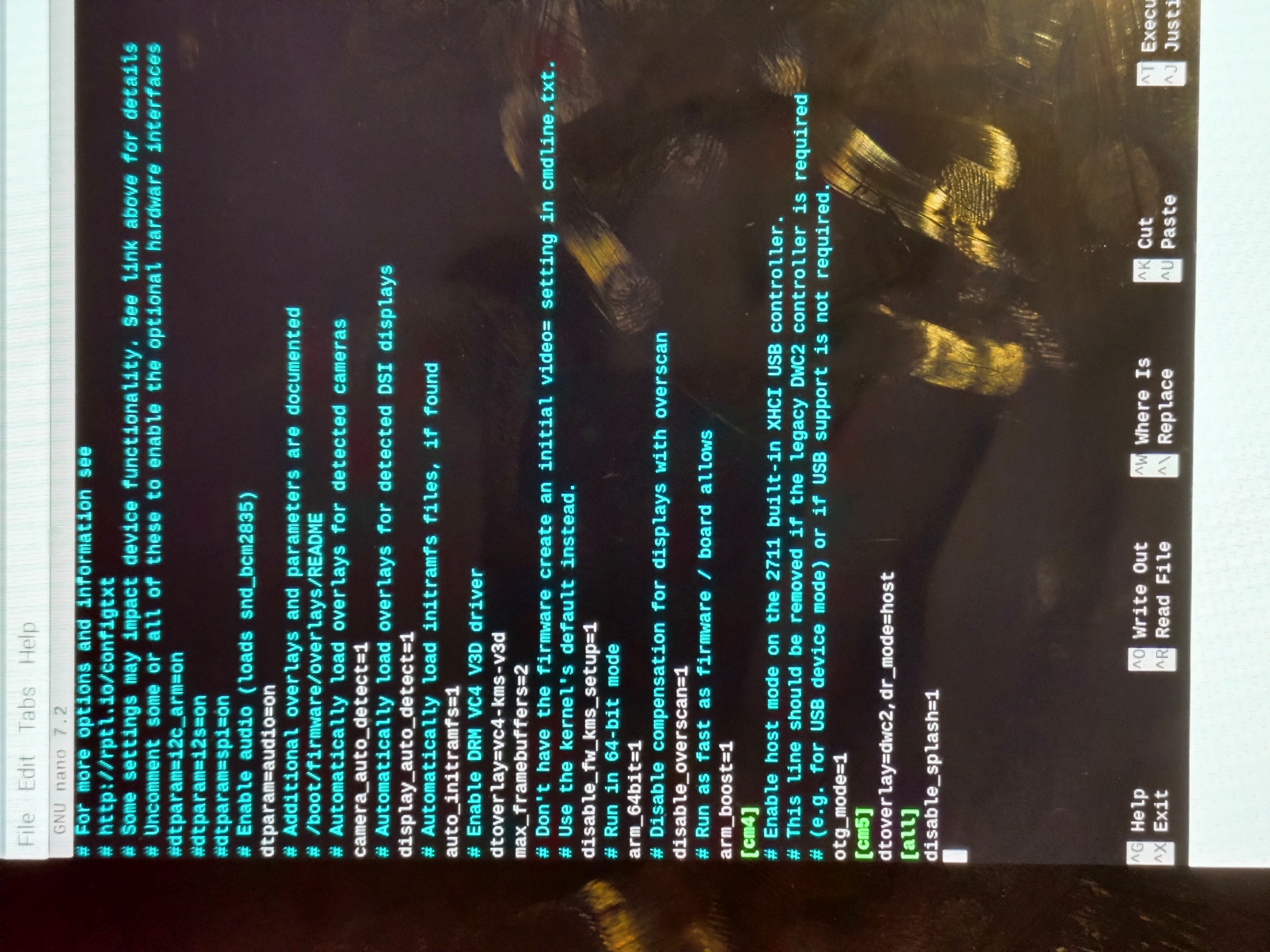

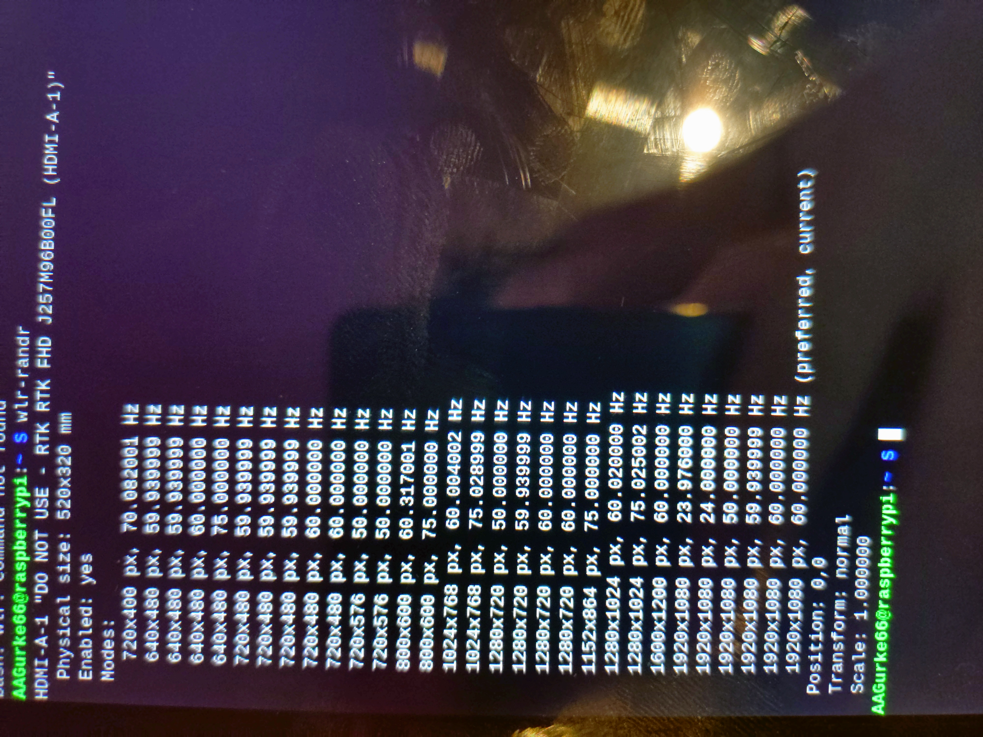

Version 1.2 utilizes full zero copy between decoding hardware and GPU so it is not an issue with decoding the video. Could you please post output of wlr-randr command? Also please post content of /boot/firmware/config.txt.

Here are the the outputs.
I did change the useRpiDrm setting and that seemed to do the trick.
I get good speed on 1080p 30 and 60fps. 720p is also flawless. I didn't test 480p.
Thank you for the great and quick support!
