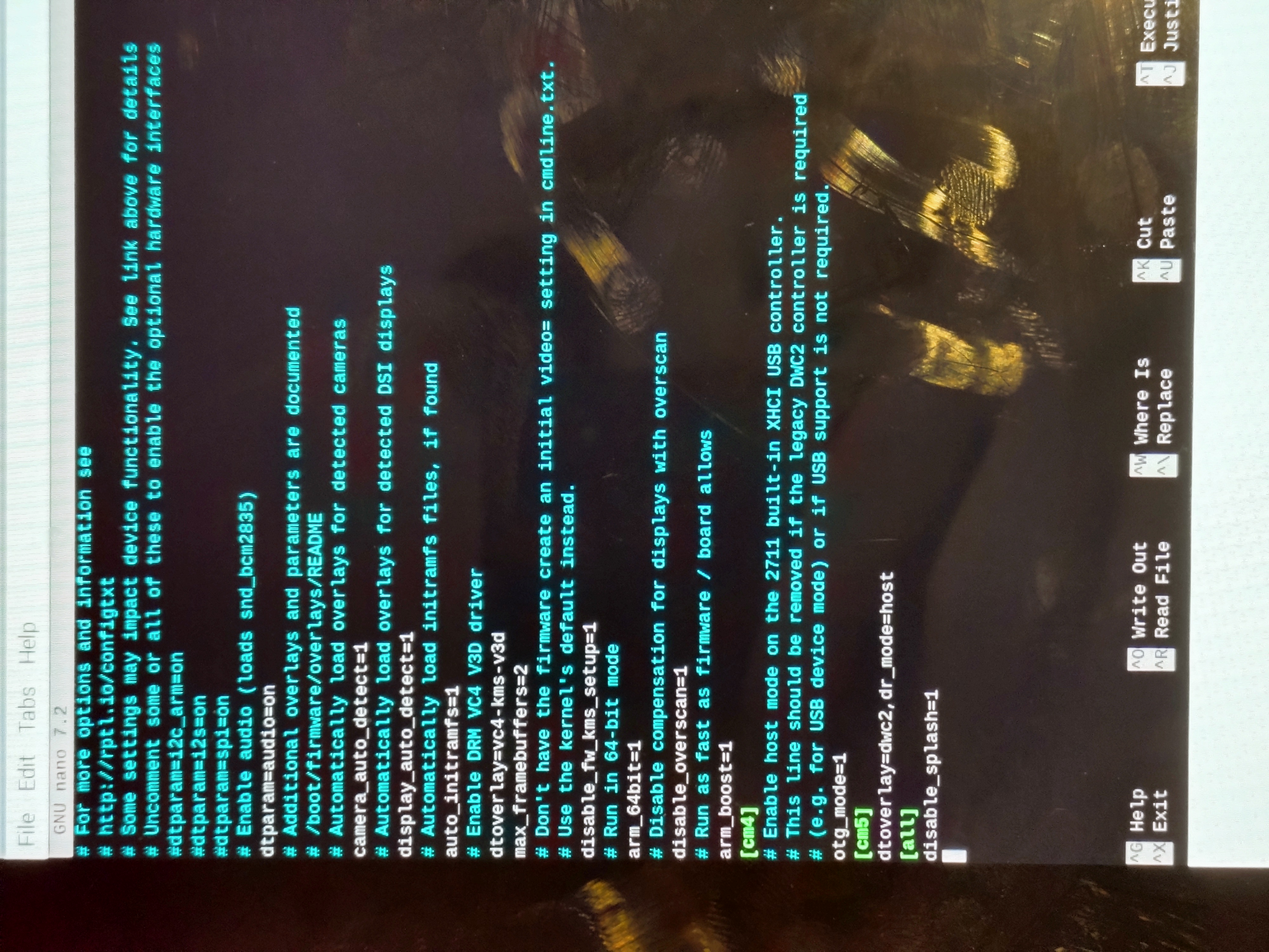

Here are the the outputs.
I did change the useRpiDrm setting and that seemed to do the trick.
I get good speed on 1080p 30 and 60fps. 720p is also flawless. I didn't test 480p.
Thank you for the great and quick support!
