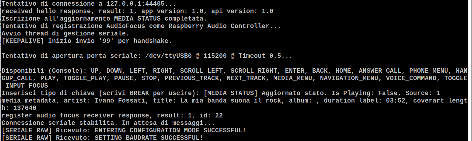

I started working on the audio focus. I get "Attempting to register AudioFocus as a Raspberry audio controller." I then get "register audio focus receiver response, result: 1, id 22." The ID changes every time I run the script.
When I press the Play (PL) button, I get "executing _send_toggle_play_focus (ID:22)," "attempting to send GAIN FOCUS REQUEST," "audio focus change response, result: True id:22," "[audiofocuskey] sent: toggle_play (press and release) with id 22," but nothing happens.
What am I forgetting? Sorry for the English and the writing, which is mixed in Italian and English.
