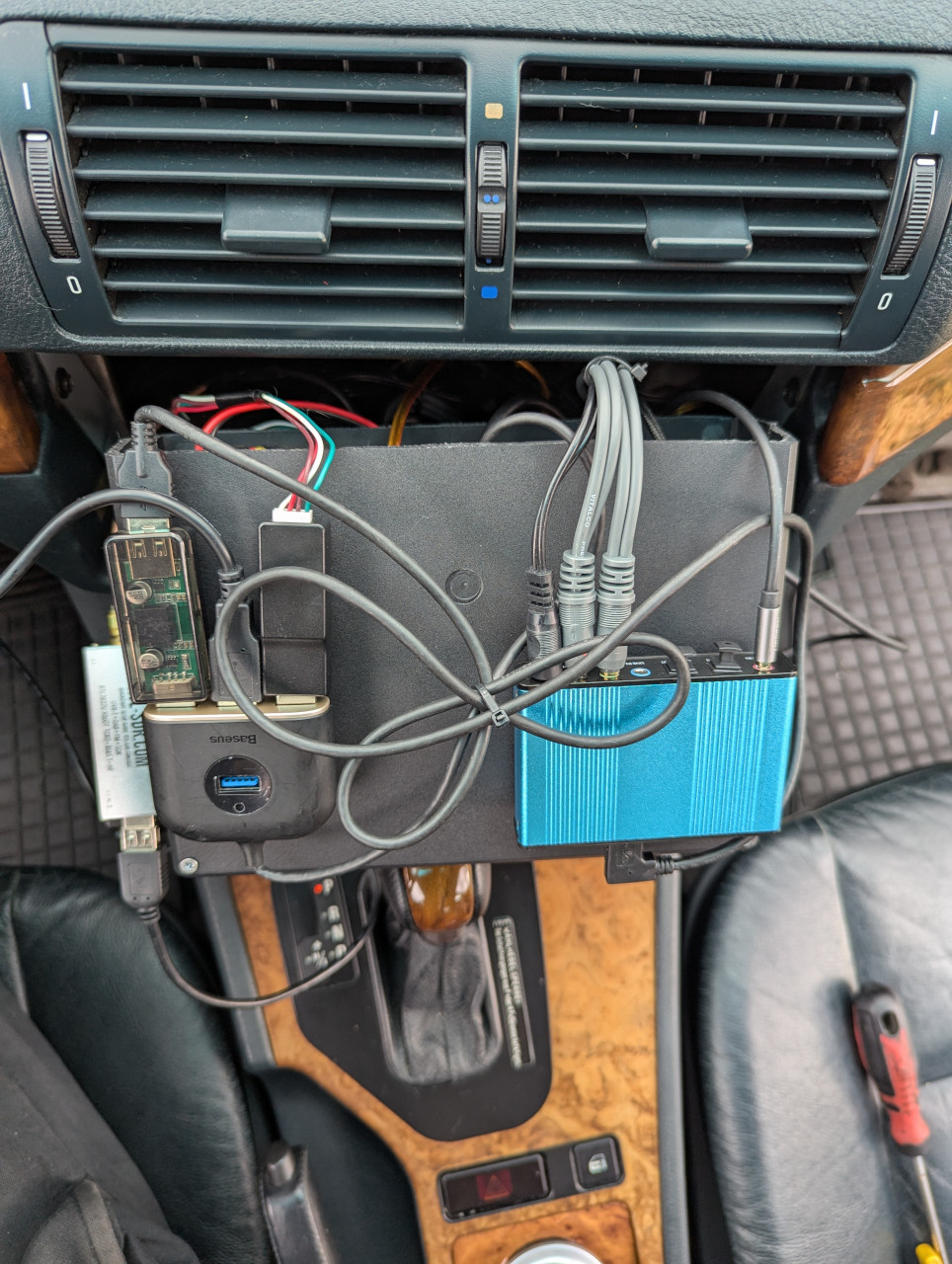

Okay after a 3 hour test drive i have two issues - now and again the volume buttons don’t work, is this possibly an issue with late detection of sound card?
Second, the siri crackle and muffled audio is still prevalent. it sounds like he’s on a very bad phone call.
Third every few mins or so i get a hiccup in the audio, almost as it drops for a split second then resumes as normal. every 15 mins or so there is a longer hiccup of 2 seconds. Is it a bandwidth issue, or buffering? It’s frustrating but i don’t know where it’s coming from.
Any thoughts on the above is much appreciated

My two cents to the topic might not be very helpful but I’m using the exact same cm6206 card with the same 5.1 to 4.1 mapping setup and everything works great. I have an ADUM3160 connected between the card and the rpi to eliminate ground loop. Maybe defective hardware in your case?

Unfortunately, we are unable to reproduce this issue on our side with this CM6206 card. It might be specific to your setup. Try to remove hudiy equalizer and echo cancel modules and check how your setup behaves with remap sink only. Also increasing the quantum in PipeWire configuration might improve audio playback.
