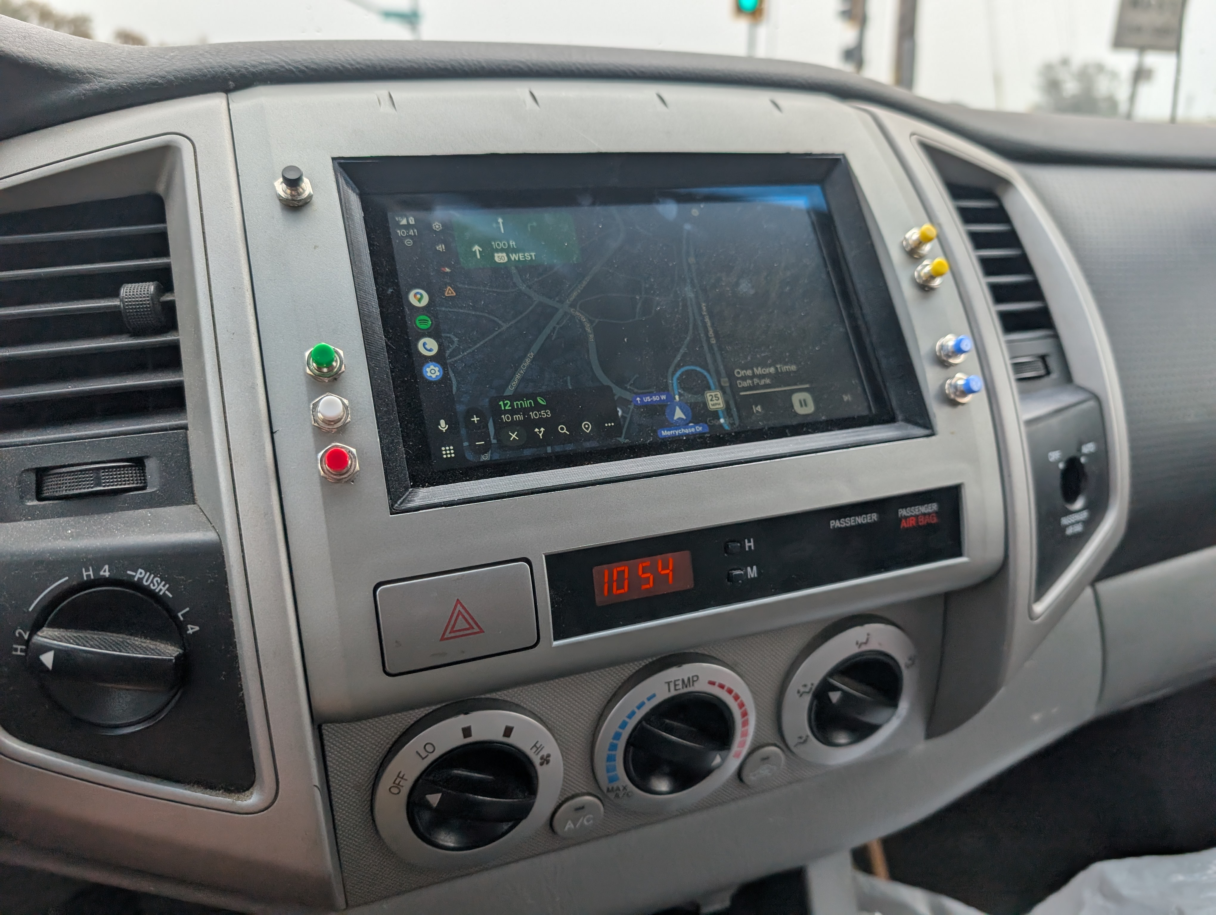

Alright, it's finally in the car and working! Need to look into a couple things:
* Volume level really low, don't want to turn up amp gain until I know I need to...
* De-bouncing the acc line when I need to start the engine but the hu is already on in standby when the screen off.
* Steering wheel buttons. I expected to see the ASWC-1 show up as a serial device or something that I could get button actions from...
