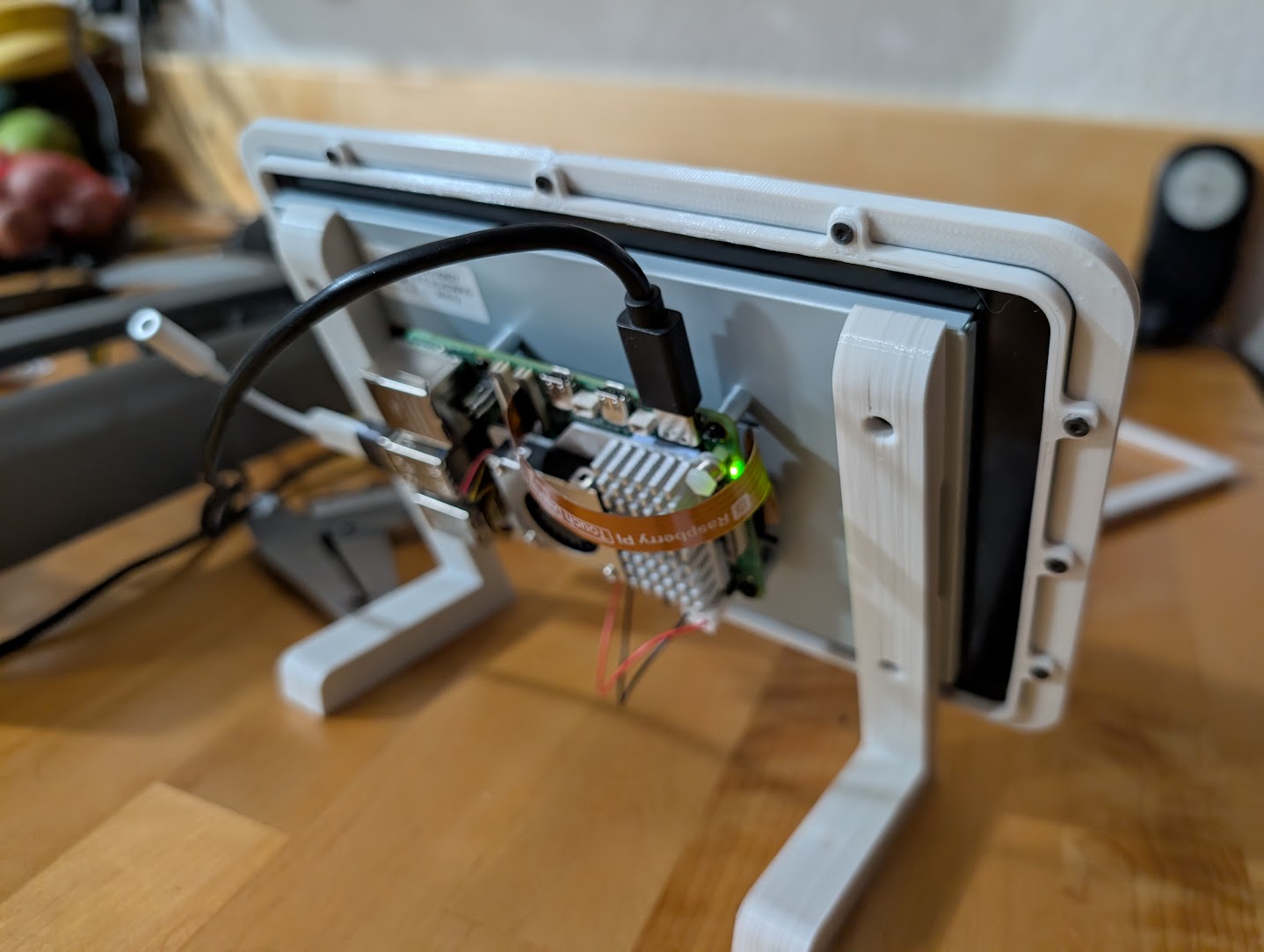

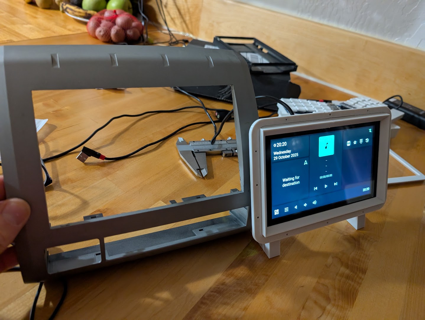

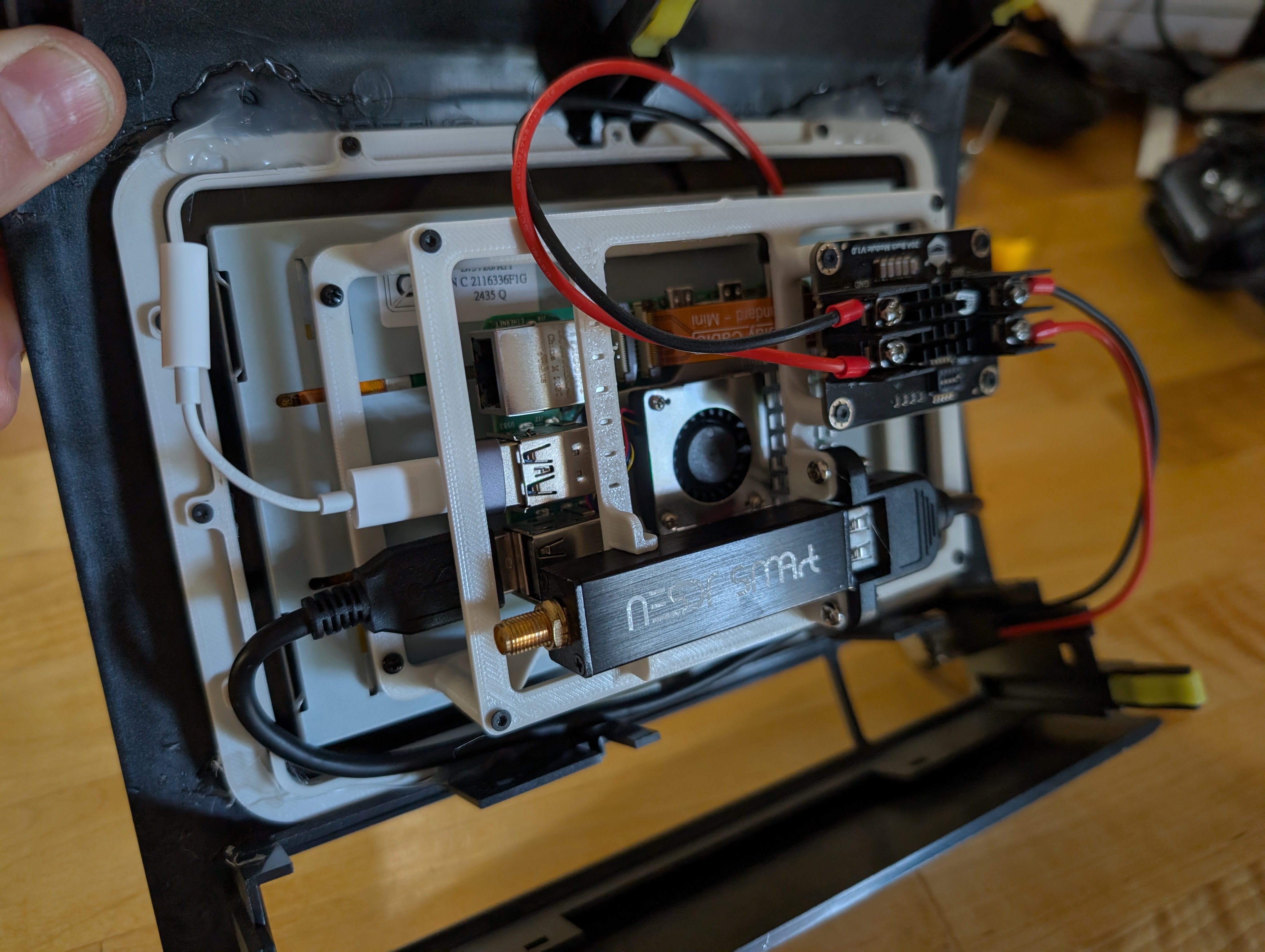

I'm far enough along on this one to share some photos - this build is using a Pi 5 and a Pi official touch screen 2 and going into a double din dash kit. Years ago I had cut the dash piece down and had a nexus 7 tablet glued into it. This time around, I made a bezel that fits into the double din opening and screw-clamps in the pi touch screen. It's a nearly perfect fit for the double din opening:
I need to re-print it in petg once I get a roll in the mail. Then I can glue it into the dash piece.
Next Steps:
* Power - 5v buck converter - I have a couple options to try. I want to leave the pi powered if I can, and use the pins for the power button to switch it on and shutdown if I can. It would be really nice if I could turn the display off and only shut the pi down if I park for more than a few minutes.
* Control Automation - toggle a pin for the amp enable/disable, brightness sensor for screen dim/bright (I think there's a factory stereo wire to read for this)
* Little macro pad by the stick shift somewhere that gives me physical buttons for stuff.
* Need to figure out which dac to use... I kind of want 2.1 channel audio so I can do the x-over between doors and sub in software, but maybe I don't need to. I want to drop anything under 30hz and could just use the amp low/high pass filters. TBD. I mostly want clean sound w/o static or anything. I figure I'll run a usb cable from the dash to down under my seat where the amp will sit.
* Wiring - power, speakers, usb, pw switch, brightness pin, amp enable. Basic setup is pretty simple?

Progress!

I ordered one of these to adapt the rtl sdr to the factory antenna: https://www.aliexpress.us/item/3256805023694169.html
I had a 5v buck converter rated for 20a that I got from dfrobot a while back. https://www.dfrobot.com/product-2662.html
I'm hopeful that'll work without any issues. If it's stable I can change the boot.cfg settings to let it use a full 5a.

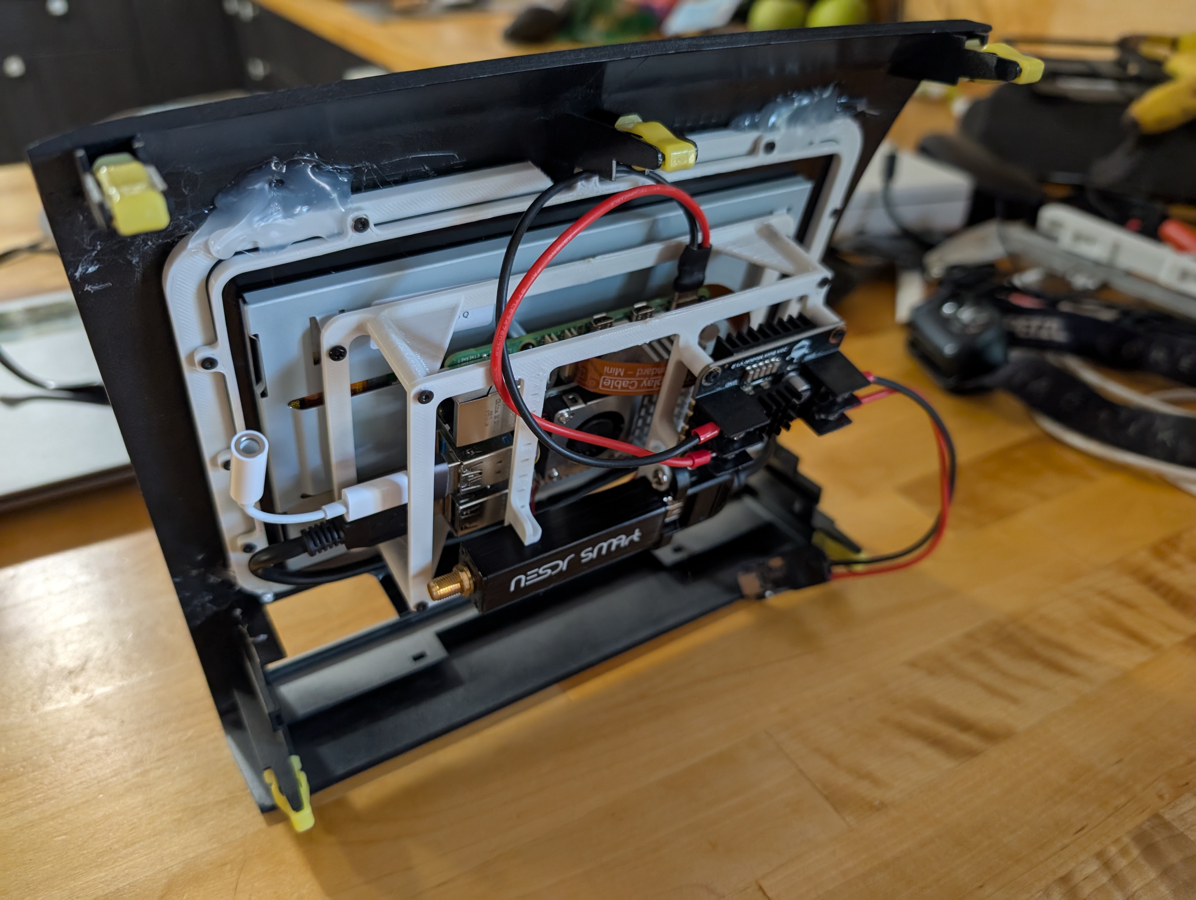

And finally got a spool of petg in the mail today so I can make some little tweaks to the fit in the dash kit and reprint one-more time. The black ptg will look better with the screen.
Standoffs will be added for a piece of perfboard that'll have a pi pico to handle some physical button presses and convert them to key-presses as a usb keyboard. It'll also grok the voltages from the steering wheel buttons for volume and back/next.
I've been thinking about screen brightness and want to have a script that runs at boot to set initial brightness based on time of day and day of year, and then further adjustments will be triggered by buttons.

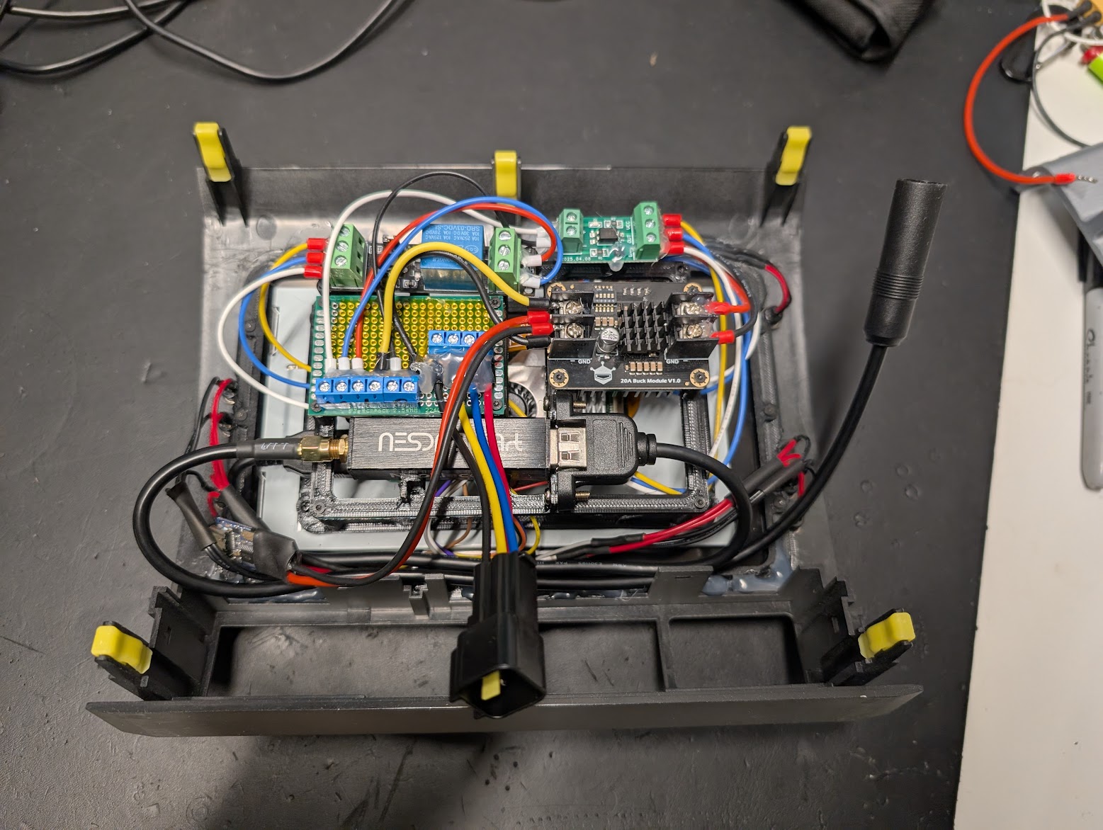

Pretty big update today
* I reprinted everything in black petg
* just did first test with the gpio functionality I need:
* * Toggle relay to switch 12v signal to turn the amp on. I need to find something solid state for this, but it works. click click click.
* * Sense 12v from the red ignition wire so I can tell when the car is on. Works great.
* Soldered pins to the shutdown button breakout and crimped some wires. Touching them controls power on/off.
* Display backlight enable/disable works. Shutdown service turns backlight off when system is shut down but still powered.
* I found out that the Axxess adapter I already had for reading the steering wheel buttons has a usb port and presents an HID device, presumably that sends keyboard presses when you press the buttons. I need to test this in the car still.
* Crimped a dozen wires for gpio and power stutff. I think I'm using too-big wire... the little dupont connectors are a pain to put together.
* I added a second nic so I could stay on wifi while hudiy starts a hotspot on the other. I have yet to get hudiy to start the hotspot. So need to troubleshoot this still.
* Pulled out my old deck and ran all the wires in the car - usb to the amp (direct connect to dac), speaker wires and power from amp to dash.

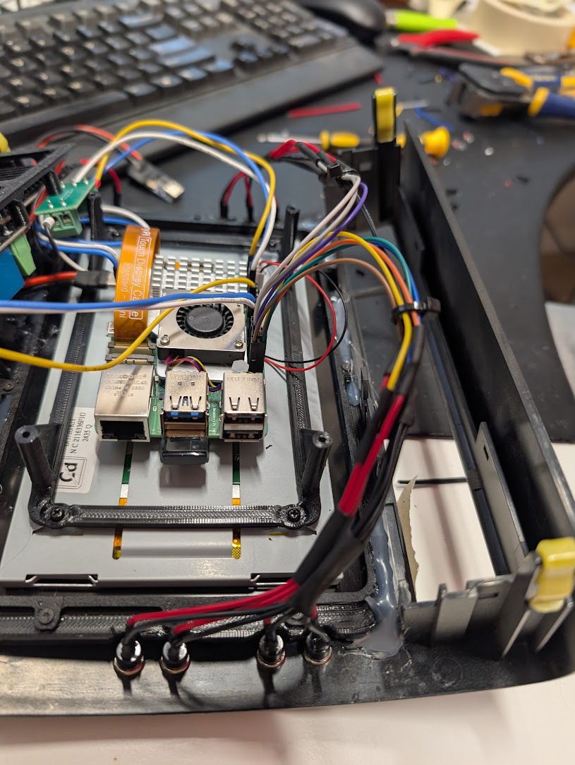

Today was a pretty good day. The Mrs was hanging out with a buddy all day so I got to do lots of project time. Buttons!
I 3d printed a template for each side of the screen for drill guides so I could put the holes all in a row...
Drilling holes...
All of the grounds were wired together and plugged into a ground pin on the pi. The other wire for each button each got a wire to a separate gpio pin...

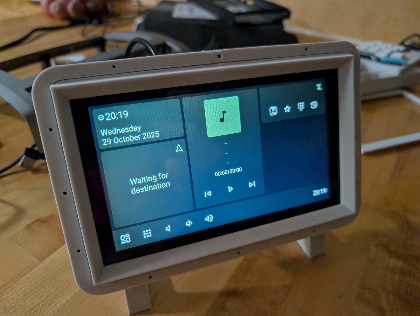

Only get 3 attachments per post, so one more post for the 4th image. Front view. Top left black button is wired to the pi power pins for hard shutdown/power on. Yellow buttons are intended for screen brightness, blue for volume, green for play/pause, and white/red who knows. Mute and something?
Here's my initial test code for reading the buttons. Things changed a little between bookworm and trixie, but its pretty simple to turn button presses into keyboard keypresses using uinput. If you use this, you'll need to apt install python3-uinput; modprobe uinput; chmod 666 /dev/uinput

Alright, the wiring is pretty much done. I got a 4-pin connector to take care of ground, power, switched ignition power, and the blue switched amp wire. The thing's a little messy, but works. I've been putting hot glue on everything I don't want to worry about rattling loose in the dash.
And Rev0 of my power mgmt & button software is done. https://github.com/a8ksh4/taco_hu/blob/ ... o_truck.py
