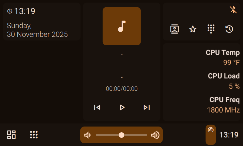

Hello @hudiy:
are there any chances to get relative x and y positions beside or instead of absolute x and y positions for the overlays?
I've created two overlays that i may want to share. If i positioned the overlays with 800x480 as resolution and a other user has for example 1280x720 the overlay will be somewhere else and not in the bottom bar anymore :-/
I've also tried to put the overlay like fullscreen and moved the div to the position i want. So like a fullscreen with transparent background and just the tile is shown in the bottom bar. That worked pretty well, but then i cannot use mouse or touch in hudiy because i can not click threw the html side.
Waiting for your reply :-) Thanks!
Now:
  "width" : 280,
  "height" : 55,
  "x" : 260,
  "y" : 416,
CSS example:
  "width": "35vw",
  "height": "11.46vh",
  "x": "32.5vw",
  "y": "86.67vh"
