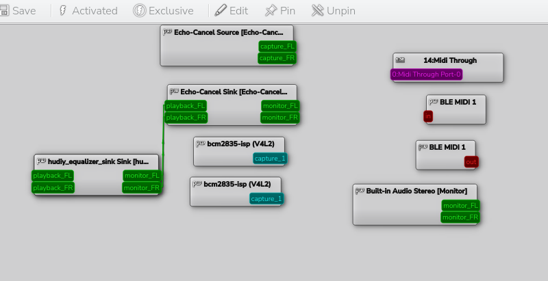

Please post some screenshots from qpwgraph program - it's a good starting point for investigating audio issues in PipeWire.

and these are my qpwgraph
- screenshot2.png (73.3 KiB) Viewed 1328 times
- screenshot1.png (51.75 KiB) Viewed 1328 times
Re: Trixie/ DAC (CarPiHAT Pro)
Thanks for the screenshots. In qpwgraph it's visible that the Echo Cancel Source is not connected to any physical audio input (microphone). You mentioned that you have a USB microphone in your setup. Was it connected to the Raspberry Pi? If so, please send the output of the command pactl list sources. Looks like it was not detected (if was connected).
For now (with not detected microphone), this looks like the Echo-Cancel module issue on Trixie that has already been discussed on the forum. If you are not using a microphone, could you try the suggestions from below post?
viewtopic.php?p=785#p785
