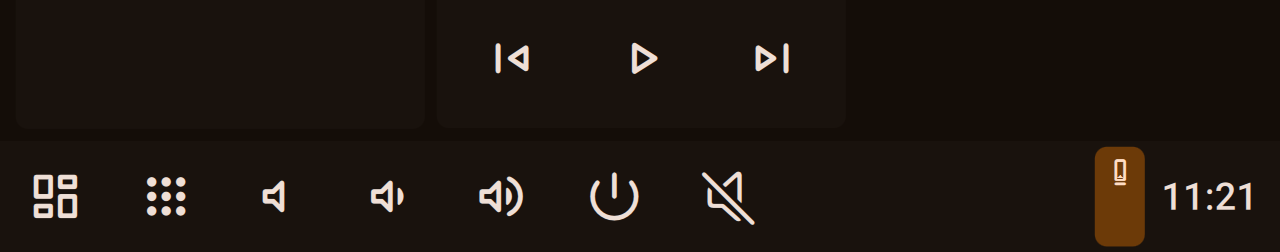

I've been trying to get glyphs from a certain font in the shortcuts menu by editing shortcuts.json but I can't seem to get it done. This is what I've done so far:
- Loaded an OTF font via the main config file (it loads correctly).
- Tried get a certain glyph by using an icon name but the font doesn't seem to support it (apparently because it doesn't support ligatures)
- Tried to use a Unicode locator but normal 4-digit unicode (e.g. \u03B1) doesn't work, my glyph isn't defined as it's one of very many in the font.
- Tried to use an HTML numeric character reference (􀊢) but that just writes it as a string in the font i've loaded.
Is there a way to use the HTML character reference that I've missed? Or are there any plans to change the way the shortcuts are edited?

I already saw that the Hudiy symbol for Android Auto was defined as "\ue900". The issue is that there's so many glyphs in this font, I can't define the symbol in this way with my font.
The font does load properly, but when I try to define it as "􀊢", it just puts this exact string in the shortcut bar instead of the desired glyph.

shortcuts.json:
            "iconFontFamily": "SF Pro Display",
            "iconName": "\uDBC0\uDEA2",
            "action": "volume_mute"

Thanks so much!
I actually came across this surrogate pair but I mean to recall it didn't work for me. I must have made a mistake. Thanks so much :) It's really enjoyable to work on this with good support!
