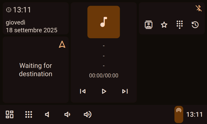

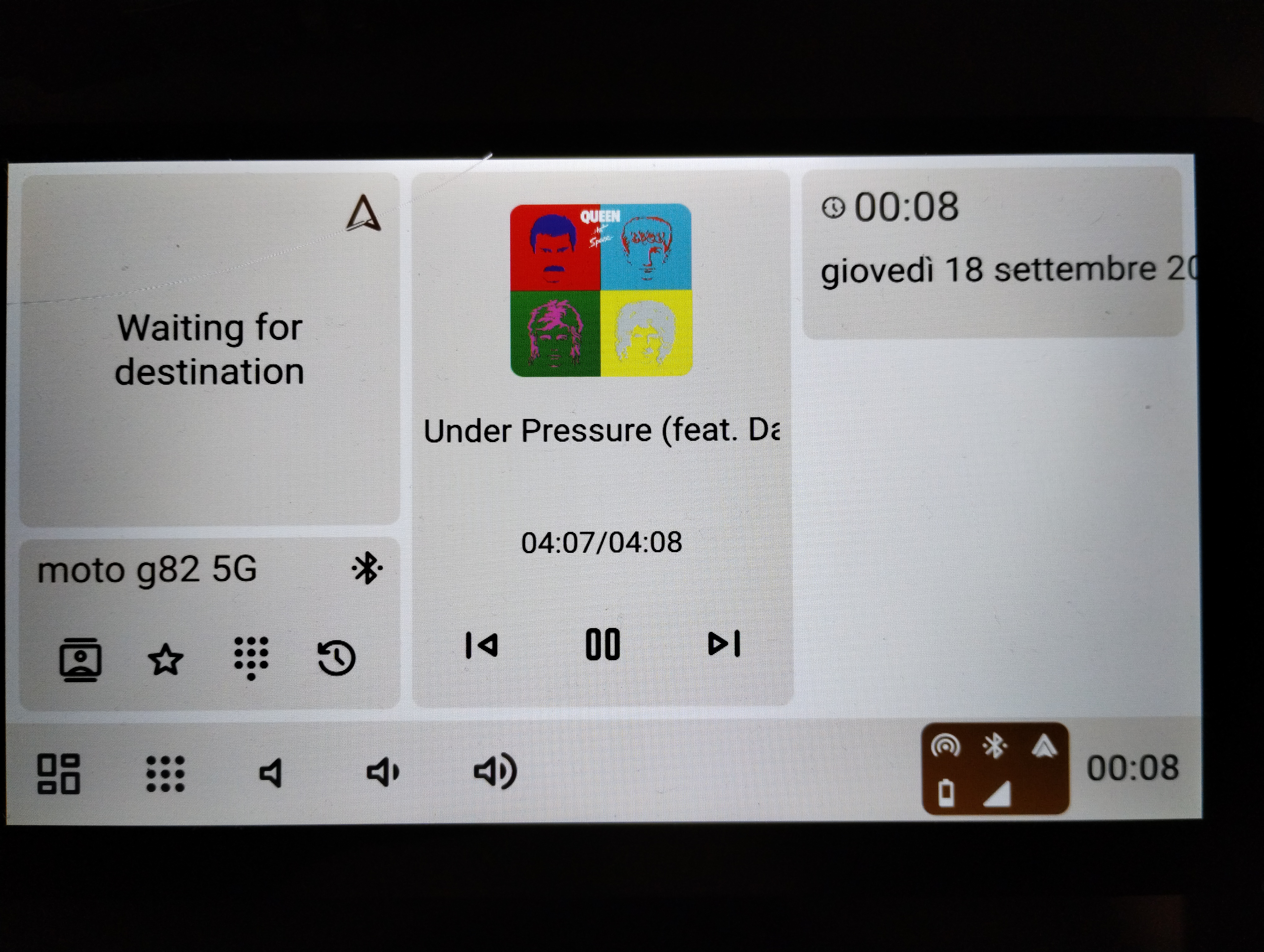

Good morning
I'm a new user of this software, and as soon as I resolve some issues, it will replace OpenAuto Pro. Great job guys. I'm new to this, and maybe my question is a trivial one, but how do I change the font size within HUDIY? The date disappears from the main screen (see photo). Thanks to anyone who can help me.
display
ElmodiLatta
- Posts: 24
- Joined: Mon Sep 15, 2025 10:11 am
- Location: Italy
Re: display
Thank you for your kind words.
It looks like there’s a missing newline character between the weekday name and the rest of the date (might be specific for Italian locale).
We’ll check the widget and try to fix it. Fortunately, the widget can easily be recreated in HTML/JavaScript, where the date displays correctly.
