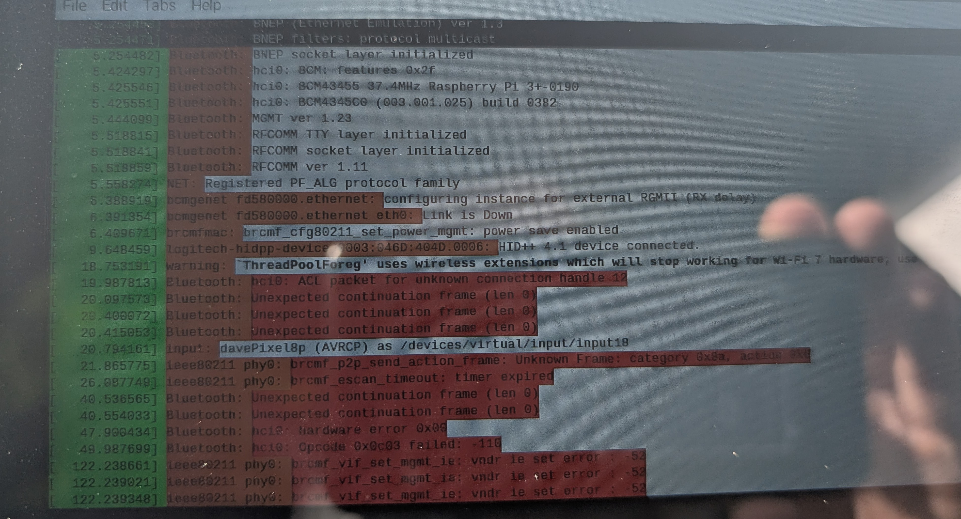

hudiy wrote: Wed Aug 27, 2025 6:08 am Could you send the output of the dmesg command after the problem occurs? If the phone cannot connect to the Raspberry Pi afterward, it may indicate a firmware crash or an internal error in its code. The dmesg output should help determine whether something is happening with the Raspberry Pi itself.
2 phone calls attempted now to do this.
Android auto started and played music fine.
On attempted first call Bluetooth instantly disconnected

Re: Phone disconnects shortly after accepting a call
Thanks for the dmesg log.
The line hci0: hardware error 0x00 points to a firmware issue. According to the HCI driver source, 0x0c03 is the opcode for resetting the Bluetooth chip.
If the problem doesn’t appear when using miniuart-bt but only with PL011, it’s most likely a bug somewhere along the driver–DMA–firmware path.
During an HFP/SCO connection, the system performs a lot of very small transfers (for built-in Bluetooth, the MTU is 60 bytes), and it seems this causes the firmware to crash.

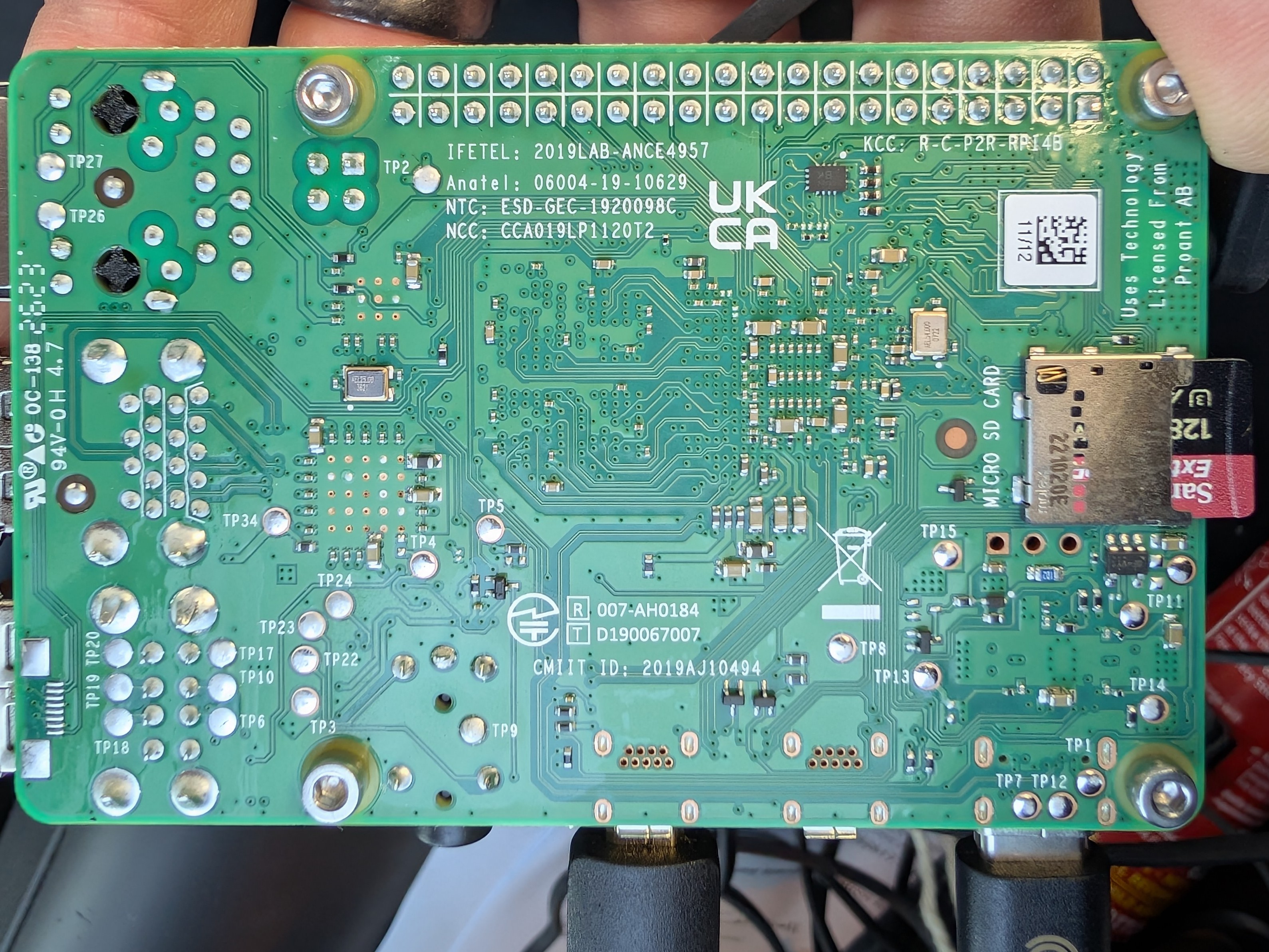

Would you be able to take a picture of your Raspberry Pi board? We’ll try to find one with the same markings so we can reproduce the problem and report it on the Pi Foundation GitHub.

Please let this be the side you need. I really don't want to have to remove the CarPiHat! :?
That is enough, thanks. We will try to find the same hardware revision and reproduce the issue so we can provide as much information as possible in a bug report for the Raspberry Pi Foundation.
