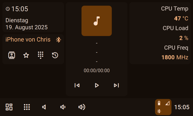

Hello together,
i wanted to share my cpu monitor dashboard widget :-)
There is no need to install anything because the python script will do that for you.

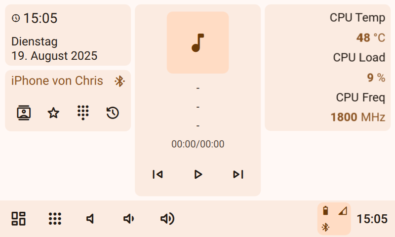

You can change the temperature unit from °C to °F and the HTML will change the output automatically.
The cpu monitor widget adopts the theme when changes are made by hudiy.
Please do the first run with internet connection so the script can install missing python3 packages :-)
I recommend to install all the Hudiy fonts system wide:
-Run these commands one after the other
mkdir -p ~/.local/share/fonts
cp /home/pi/.hudiy/share/assets/fonts/*.ttf ~/.local/share/fonts/
fc-cache -fv
How to add to hudiy dashboard:
-Edit the file: "/home/pi/.hudiy/share/config/dashboards.json"
-Add the following line to the file:
{ "type": "web", 		 "size": "medium_narrow", "url": "file:///home/pi/scripts/cpu_widget.html" },
Caution: If you add this widget in the latest position, please remove the "," behind the "}":
How to run:
-Put the python file "can_widget.py" in the folder you like
-Set the correct permissions with shell
sudo chmod +x can_widget.py
-or via fpt/ssh to 0755 (rwxr-xr-x)
-Run the script via command
python3 cpu_widget.py
-or put it in the autostart
How to autostart:
-Login into the shell
-Run the command
crontab -e
-Select the editor of your choice (i prefer nano)
-Add the following line at the bottom (make sure to adjust the path if needed):
@reboot /usr/bin/python3 /home/pi/scripts/cpu_widget.py
-Save with CTRL+X
cpu_widget.zip
(5.66 KiB) Downloaded 138 times
