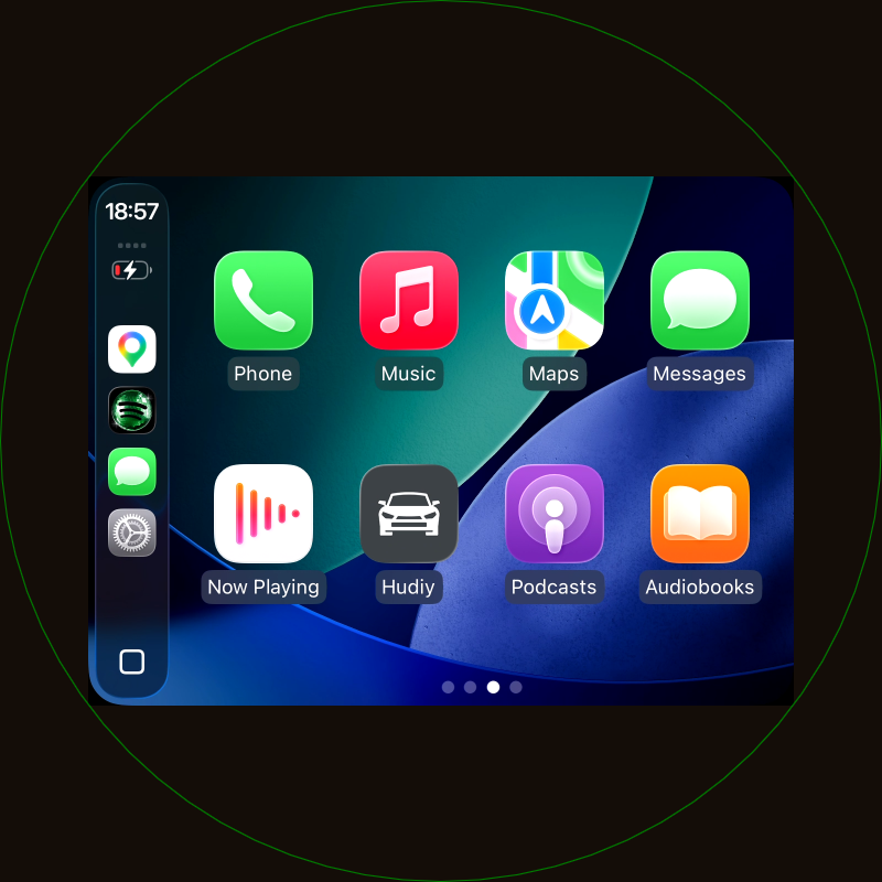

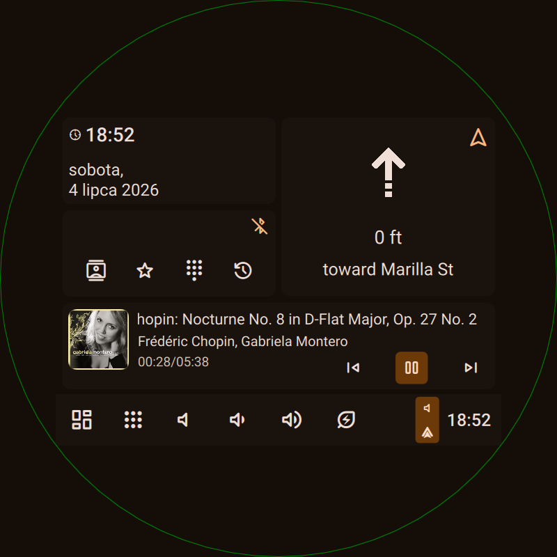

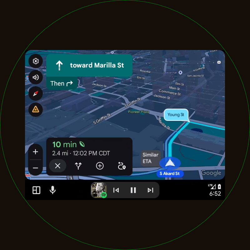

Thank you for your kind words! Regarding the round screen, the simplest solution would be to use the width, height, x, and y parameters for Native UI, CarPlay, and Android Auto. With these parameters, you can freely position these elements within the Hudiy window (the Hudiy window can remain fullscreen):
https://github.com/wiboma/hudiy/blob/ma ... pplication
https://github.com/wiboma/hudiy/blob/ma ... ndroidauto
https://github.com/wiboma/hudiy/blob/ma ... md#autobox
We ran some local simulations, and it can be configured like this, for example:
config (selected parameters) for width, height, x, and y:
main_configuration.json
dashboards.json

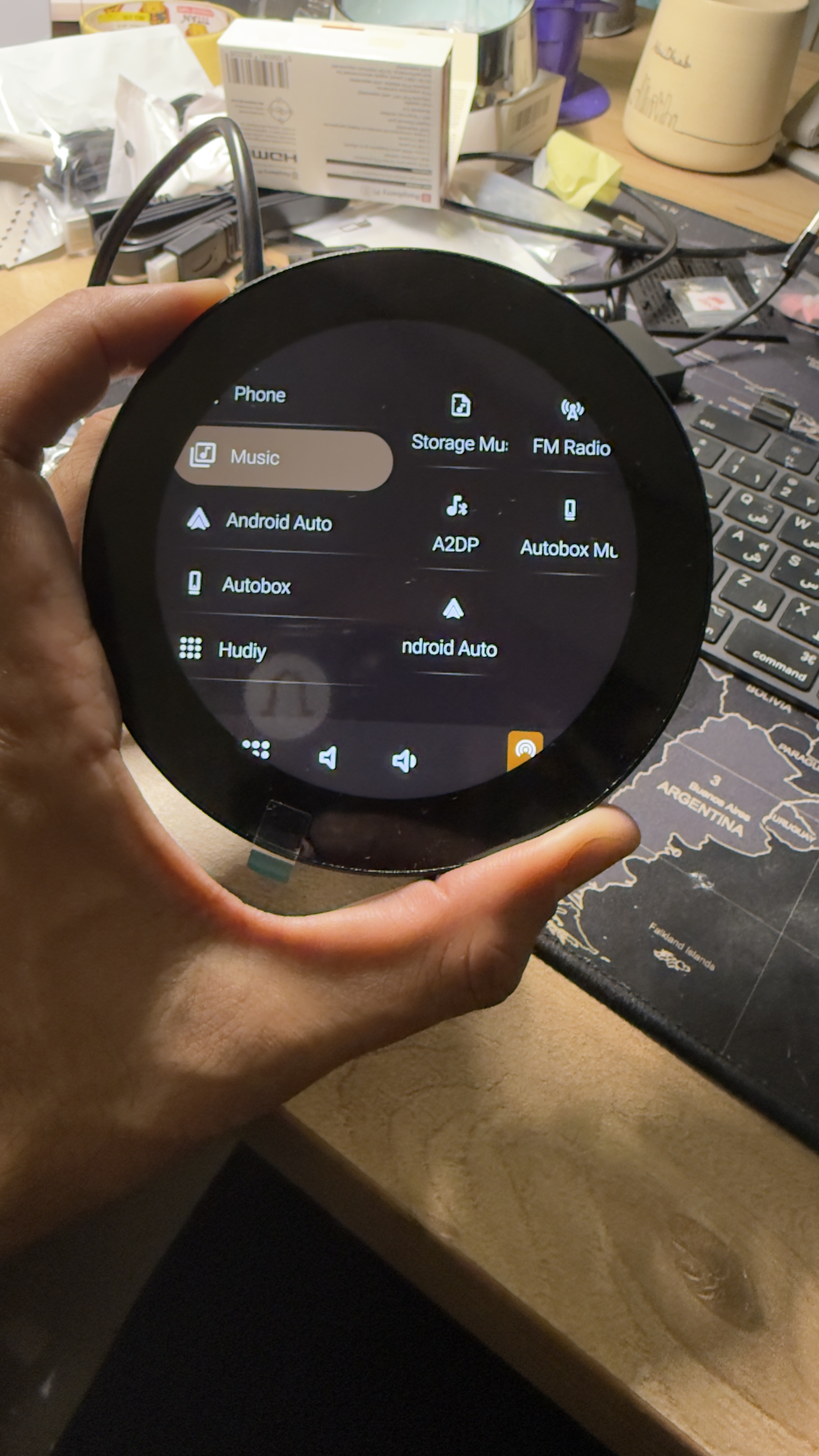

Re: Round Display UI, GPS Speedometer & Audio Output Questions

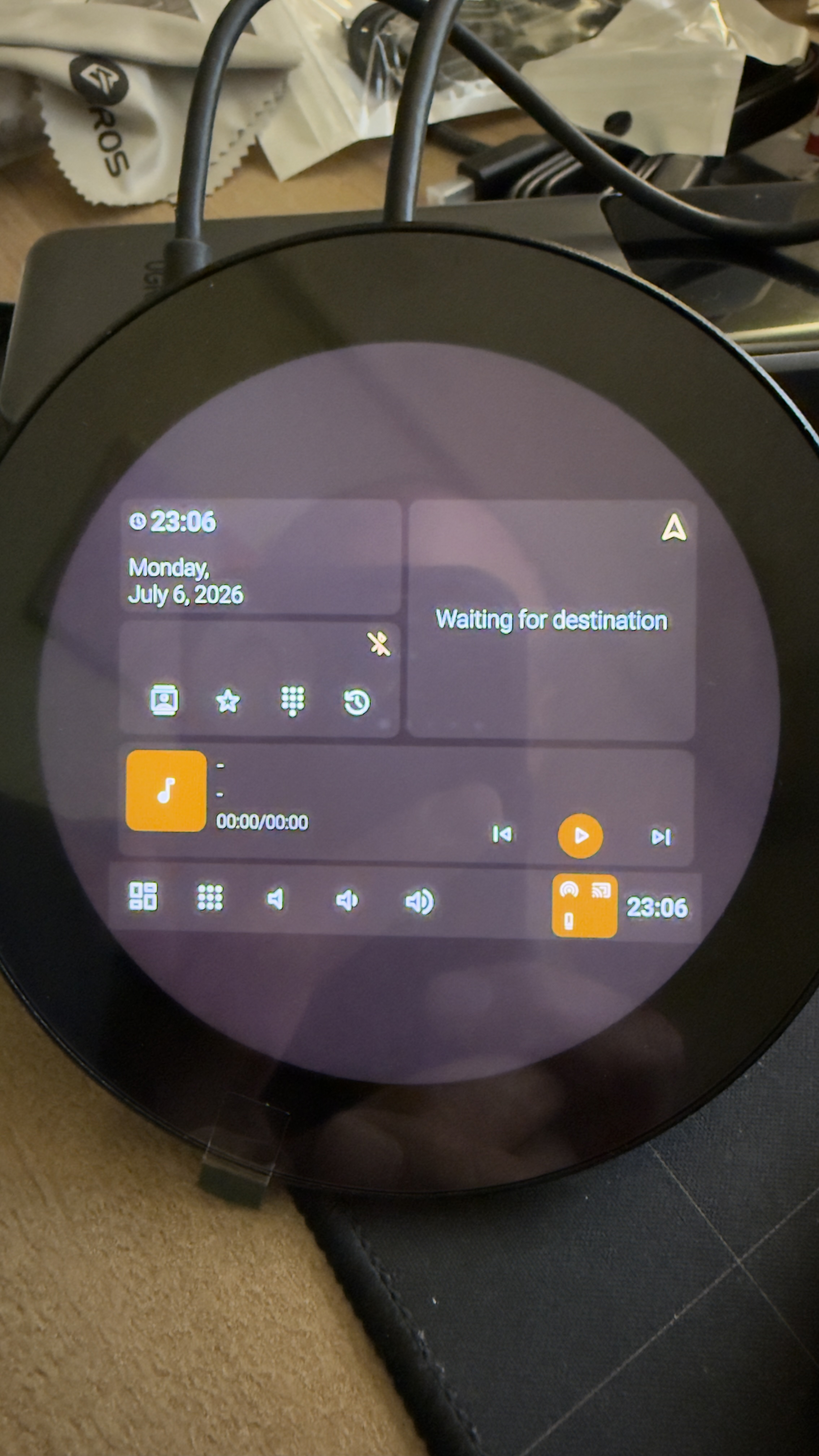

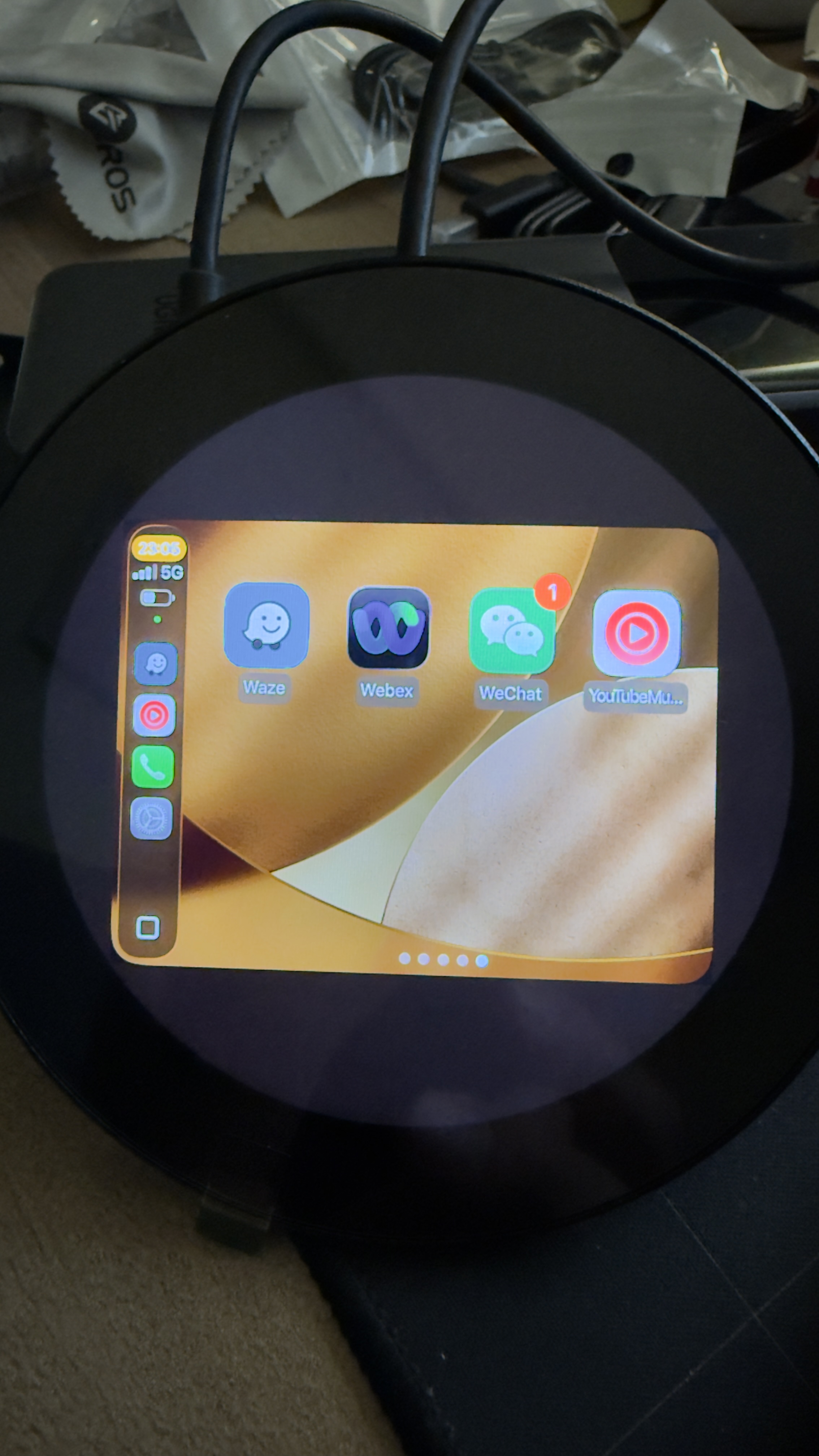

Thank you very much for your excellent support and guidance throughout this process.
I'm happy to let you know that everything is now working perfectly. I applied the configuration changes you suggested for the round display, and the results are excellent. The dashboard now fits the 800×800 round screen very well, and I'm really happy with how it looks.
I've attached a few photos so you can see the final result on the round display.
I really appreciate the time and effort you put into helping me. Your support has been outstanding.
I'm looking forward to the future GPS speedometer feature you mentioned. I think it will be a fantastic addition to the project.
Thanks again for all your help!
Best regards,
Saeed
Best regards,
Saeed
