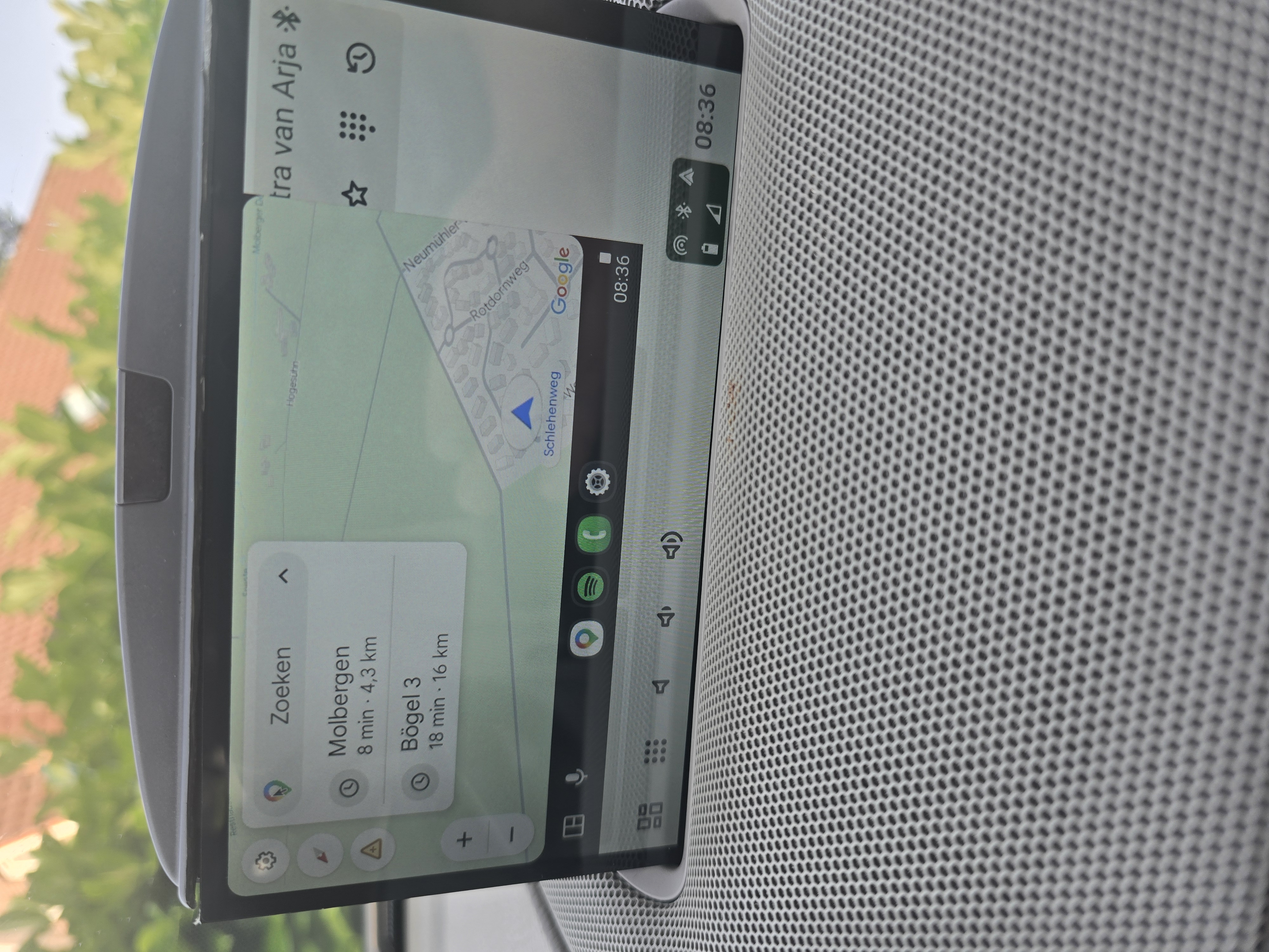

I had a 6.5 inch screen but it was not realy showing great in auto had a lot of sun interference so i could not see screen realy well.
Now i bought a 7 inch screen and al works fine also better view. In full sun still not great but better than before.
So only thing i walk in to is screen of Android is small.
See picture.

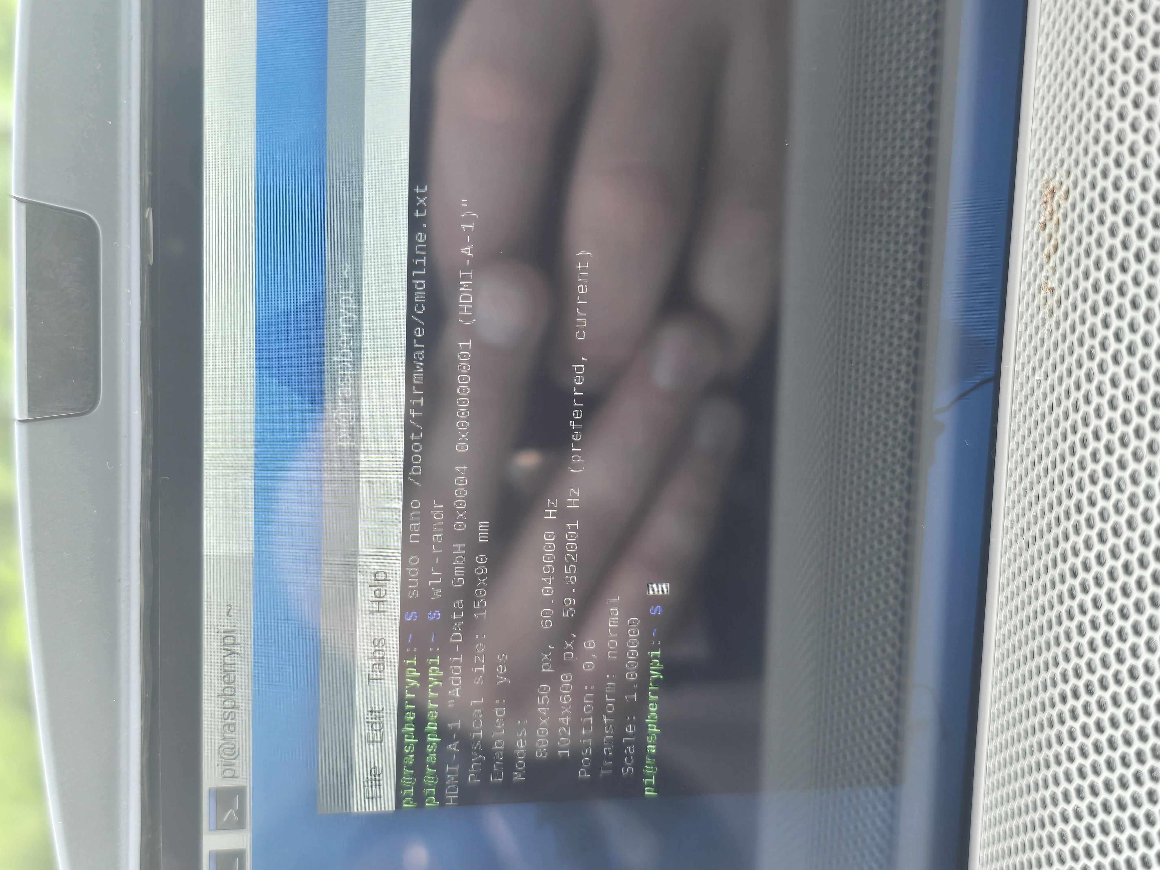

I thought maybe i must adjust the cmdline but maybe i am wrong. I saw a post on this but i am a bit of a noob it had a link to github and there is where i stall.
Do i know that it can be fixed but i dont know how sorry guys.

By default, the Android Auto resolution is set to 480p (800x480). For non-standard resolutions (like 1024x600), you have to change both the resolution and the margins in the configuration file: https://github.com/wiboma/hudiy/blob/ma ... ndroidauto
To make Android Auto fullscreen e. g. on 1024x600 display, the values should be set as follows:
"resolution": "720p",
"widthMargin": 256,
"heightMargin": 120,
720p = 1280x720
widthMargin = 1280 - 1024 = 256
heightMargin = 720 - 600 = 120
Please note that the .hudiy folder has a dot in its name, which means it's hidden. You can enable showing hidden files in the file manager using CTRL + H, or you can edit the files from the terminal using a tool like nano, for example: nano $HOME/.hudiy/share/config/main_configuration.json

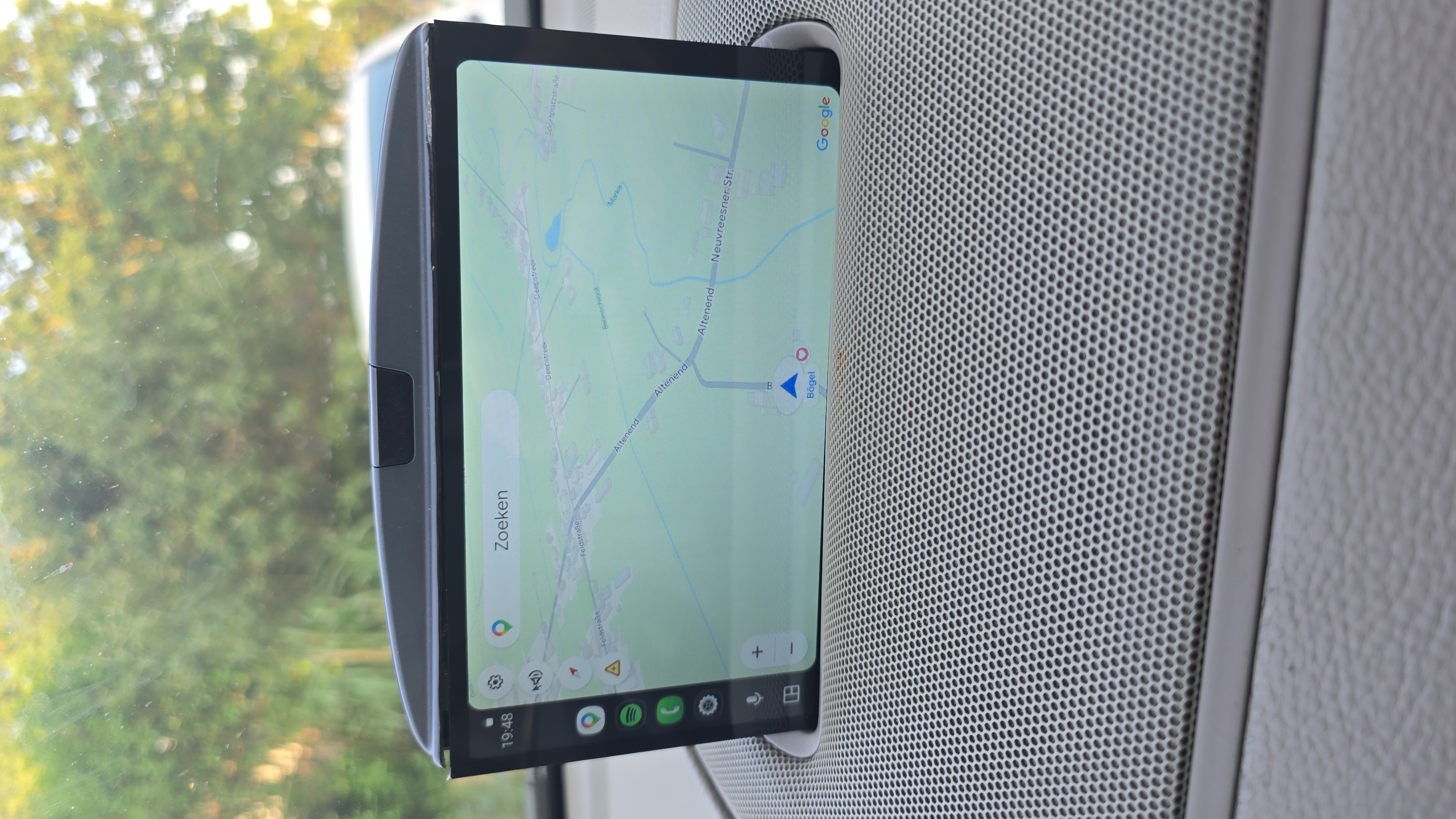

Great response
Thanks sorry that i didnt understand the other post it was now clear.
