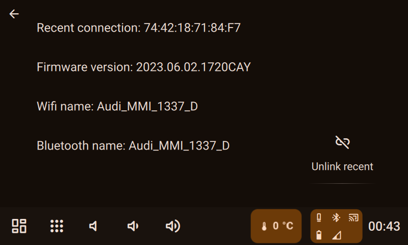

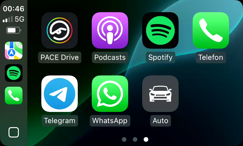

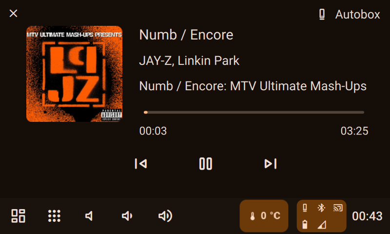

Because i still have my Carlinkit CPC200-AutoKit i've tried my luck and had success :-)
I've changed the "productId" in the "/home/pi/.hudiy/share/config/main_configuration.json" config file from "5409" (CPC200-CCPA) to "5408" (CPC200-AutoKit) and it worked fine:
-Carplay works
-Autobox Music player works
-Media Metadata via API works
Are there any chances to get official support in Hudiy for Carlinkit CPC200-AutoKit without the need to change the "productId".
Were there any reasons why you didn*t support Carlinkit CPC200-AutoKit out of the box?
