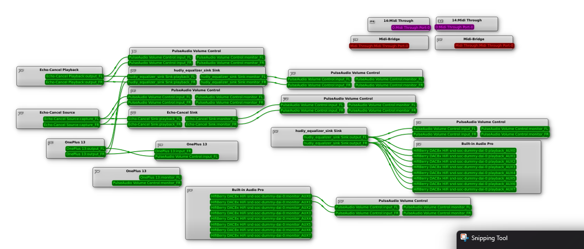

Just started testing the HifiBerry DAC8x as shown in the photo. it works for Channel 1 and 2 Stereo out of the box with the right config.txt. dtoverlay=hifiberry-dac8x. I also tried to duplicate the 1-2 channels to channel 3 to 8 using qpwgraph as shown in the photo but the setting is not sustained after reboot. still need to figure out how to approach this. the main reason I want to use a hifiberry DAC8x because of the hires audio support, can setup different sound stage (4.1, 5.1, 7.1 and etc) and most importantly, I want the phone call or phone navigation only output from certain channels (not all). Im looking for guidance on how to do this.

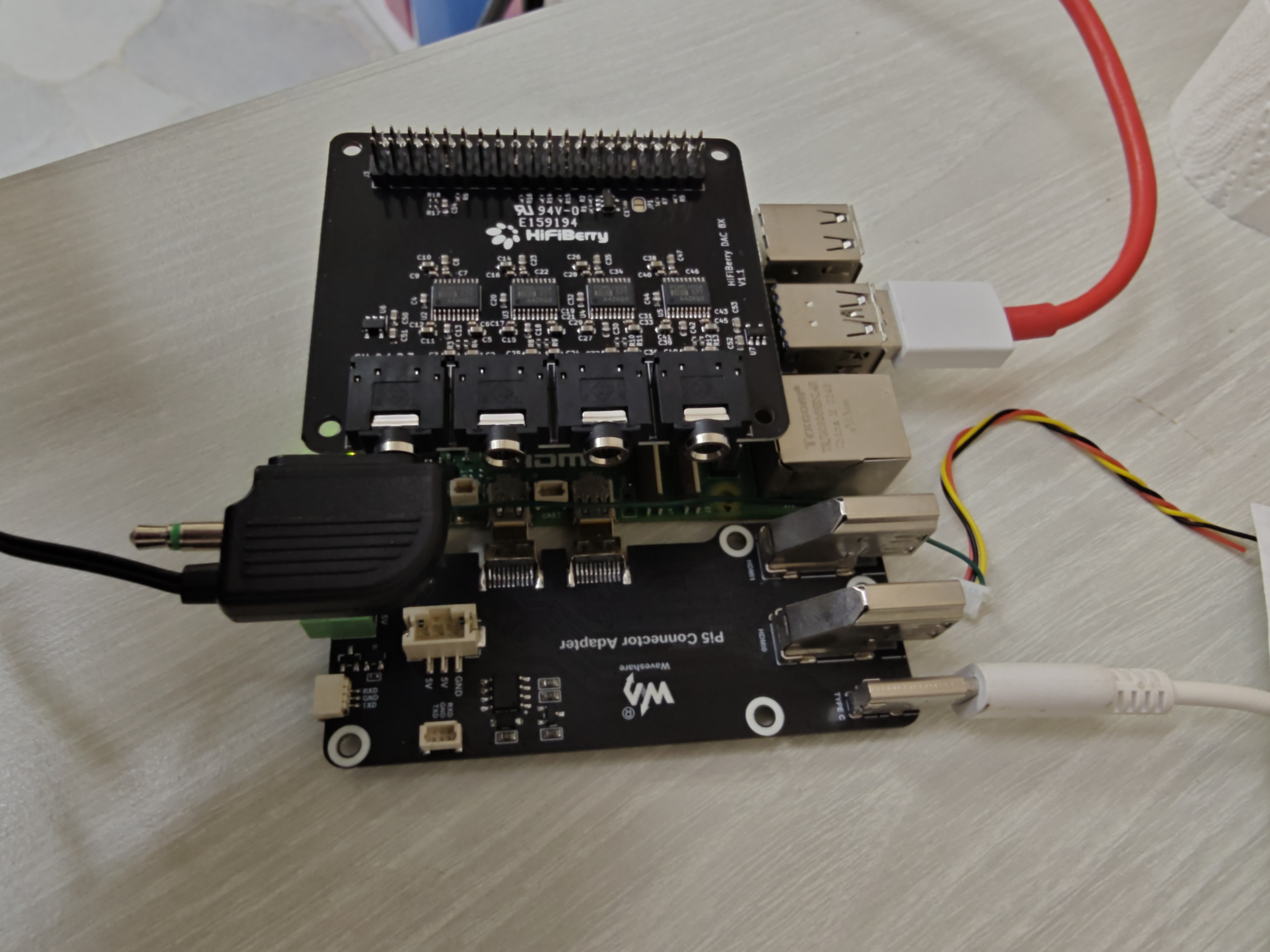

Here is the hardware setup. It is sleek and high quality. I need to spend time to setup correctly and have the ability to customize the audio piping. Any guidance will be appreciated.

Re: HifiBerry DAC8x
After configuring the routing using qpwgraph, you can save it to a file and restore it (e.g., in hudiy_startup.sh) using the following command:
qpwgraph --minimized --activated --exclusive saved_routing.qpwgraph
viewtopic.php?p=1184#p1184

somehow when I use the "qpwgraph --minimized --activated --exclusive /home/raspberrypi/AA_DAC8x.qpwgraph" as instructed above, hudiy fail to boot and it keeps looping the splash only.
Re: HifiBerry DAC8x
qpwgraph may be blocking the current terminal session. Try running qpwgraph --minimized --activated --exclusive /home/raspberrypi/AA_DAC8x.qpwgraph in the background by adding & at the end of the command.
Also, in background mode, some sleep might be a good idea to give qpwgraph some time to restore the routing.
qpwgraph --minimized --activated --exclusive /home/raspberrypi/AA_DAC8x.qpwgraph &
sleep 2
If that does not help, please execute the $HOME/.hudiy/share/hudiy_run.sh command in the terminal and post the output.

now it can boot like normal with "&" at the back but somehow it cannot sustain the connection between Hudiy FL/FR to the 8 channels as shown in my first post. it always default to just two channels output.
