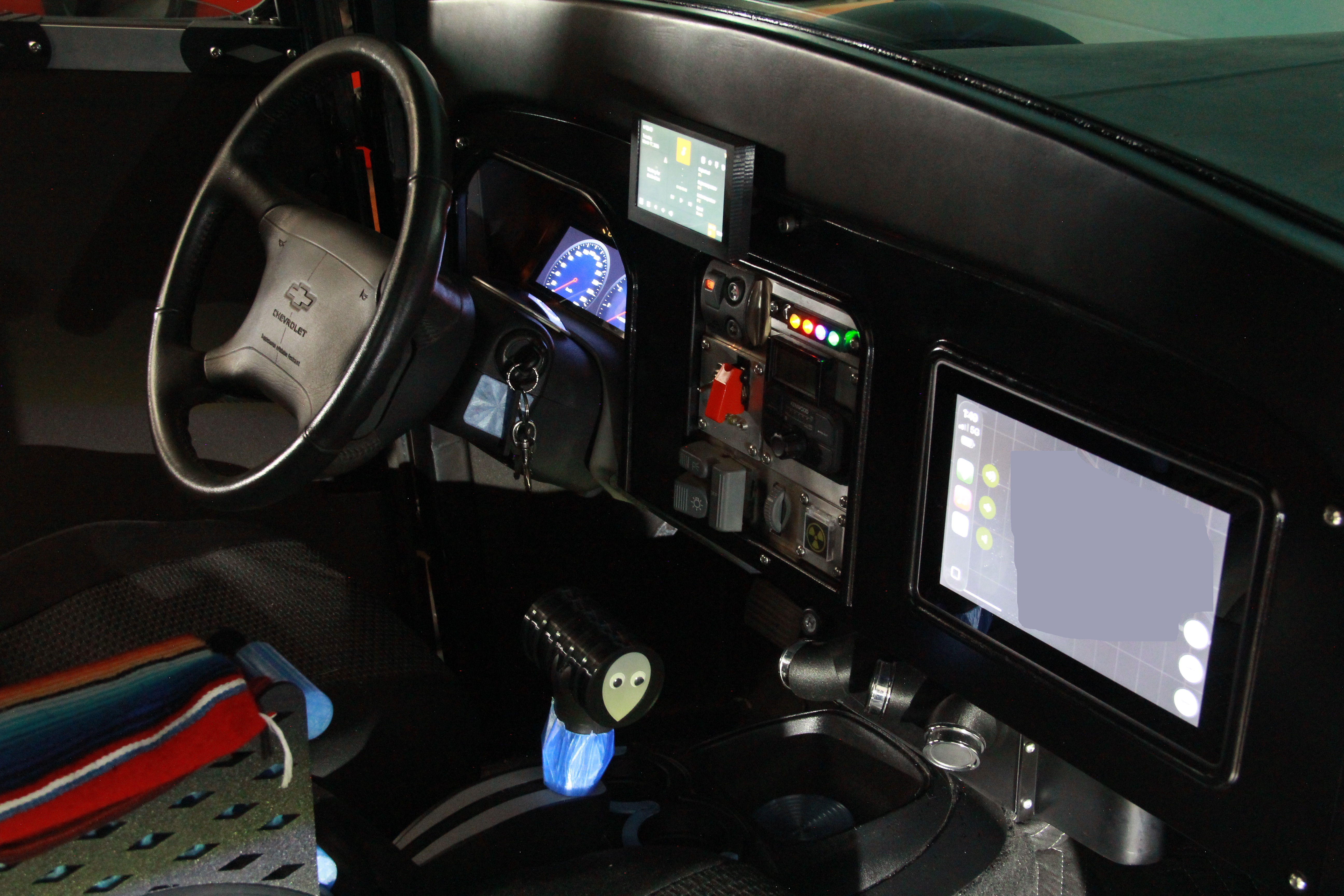

Greetings from -34C Alberta. With the first deep freeze here I'm finding the hours needed to finish building & installing a head unit in a 1935 custom built truck on a '97 Chevy S10 4x4 chassis; a project started in 2011 and put on the road in 2023. I doubt it will ever be 'done'...
The head unit build was started a few months prior to my discovering Hudiy, and I'm thankful for your application: my python is marginal but I did have OBD and GPS working before the addition of the Carkit dongle and its live iPhone connection.
The unit has a Pi5 8GB 256GB M.2 with RTC on Trixie attached to a 10" HMI. All power flows via Waveshare 3S UPS configured to power up by a momentary switch latching relays that remain powered until commanded off by the Pi 20 seconds after the truck ignition goes to zero. Attached to the pi is a powered USB hub hosting the Carkit adapter as well as RTL-SDR and OBD2 connections. A buck converter charges/ isolates truck +13.6v from the UPS +12v and separate grounds are maintained on the truck and logic circuits.
The Pi/ Hudiy/ Carkit are configured/ working and I'm finishing up the wiring. The dash has been modified with a bigass hole and mounts have been designed, printed from PA6 and installed.

Design criteria:
1.) Parasitic draw when off is not permitted.
> RPi5 must disconnect when off; normal shutdown leaves the computer in 'low-power-mode'.
> HMI screen must disconnect when off; backlight remains on when connected to power.
> UPS must disconnect when off; LiPo batteries are not to charge when system not in service.
Operation:
2.) Manual startup with a demo mode bypass.
Momentary button pressed -> amber LED lights (13.6v truck active)
Buck converter powers up -> red LED lights (12v Buck out active)
UPS on switch activated -> blue LED lights (5v UPS out active)
RPi5 comes up -> green LED lights (Pi alive)(INI219.py monitoring active)
3.) Auto shutdown:
The Waveshare 3S UPS charges while discharging: being a smart device, internal voltages and current are available via python script. A Pi script monitors the supply voltage and starts timing down upon loss of mains. The Pi then winds things down and commits suicide by gpio.
4.) Manual shutdown:
Securely located Blue Switch of Death.
Hudiy.
5.) Pi starts -> scripts start -> Hudiy starts -> iPhone connects -> music starts -> happy place.
So far it performs as designed. Next step is to plagiarize a few scripts then add a second Bluetooth to stream tunes from iPhone -> Hudiy -> Kenwood bluetooth only amp + sub. 1kw of Tiesto & Mathame in a 1935 truck cab... I'm on my second sub... Right now it's wifi from phone to Pi then b/t to amp, but I'm thinking that's asking for trouble.

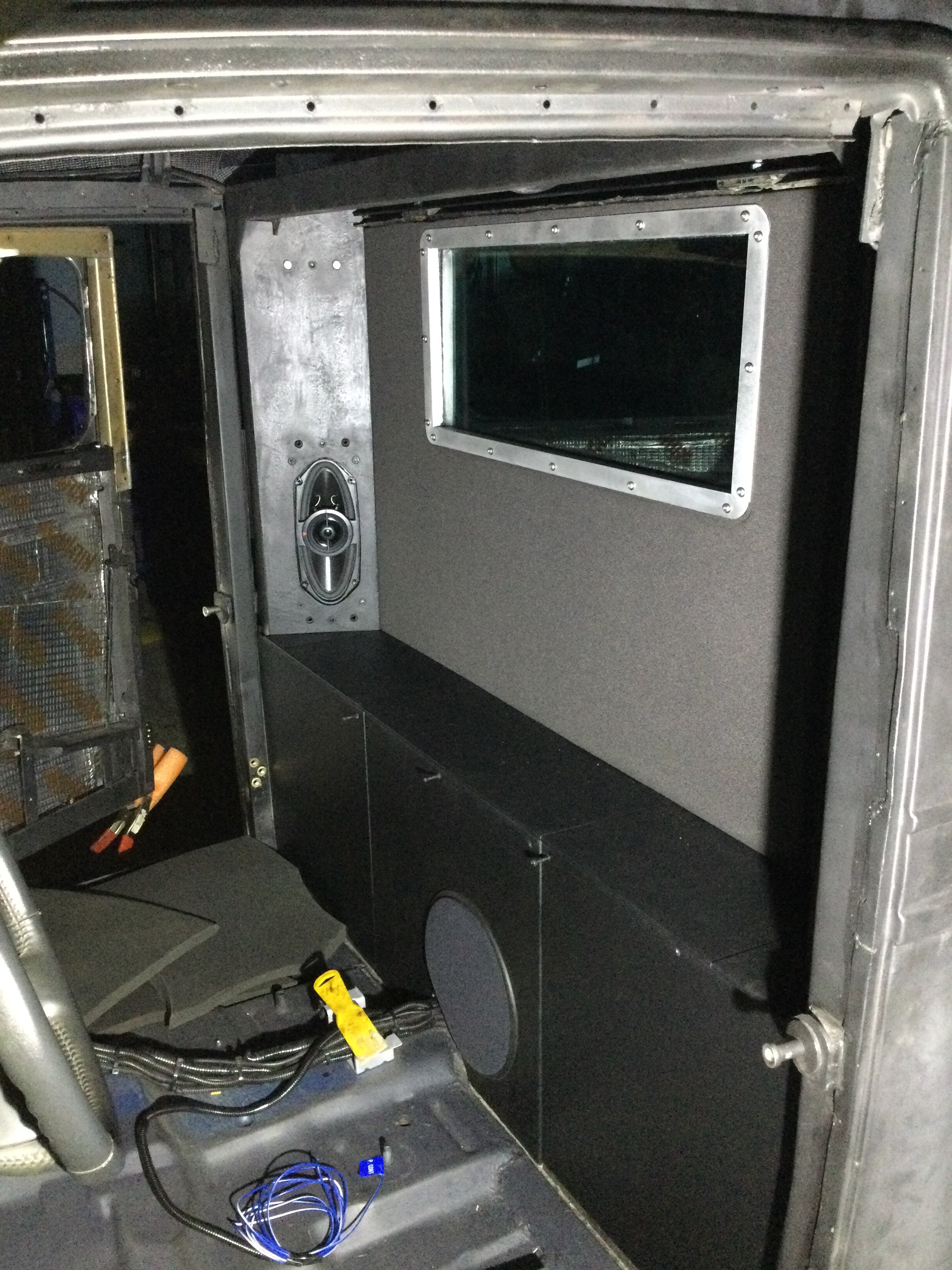

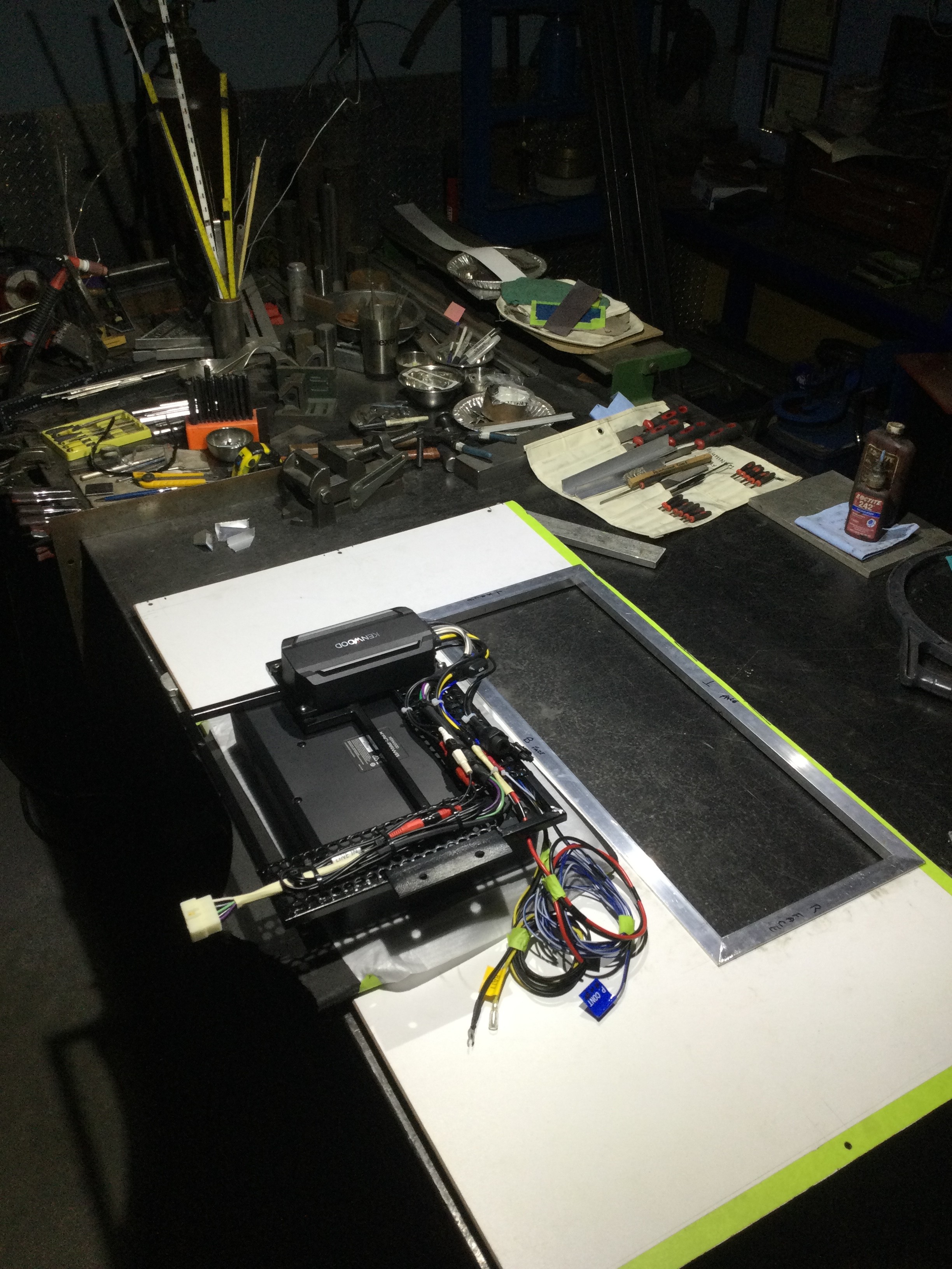

fyi, due to lack of space (1935 trucks are Small) I chose a bluetooth only amplifier with wired remote designed for off-road utility vehicles. Kenwood KAC-M5024BT https://www.kenwood.com/ca/car/motorsports/kac-m5024bt/ and a matching powered sub. There's also a pair of tweeters with HF crossovers hidden above the rear window.

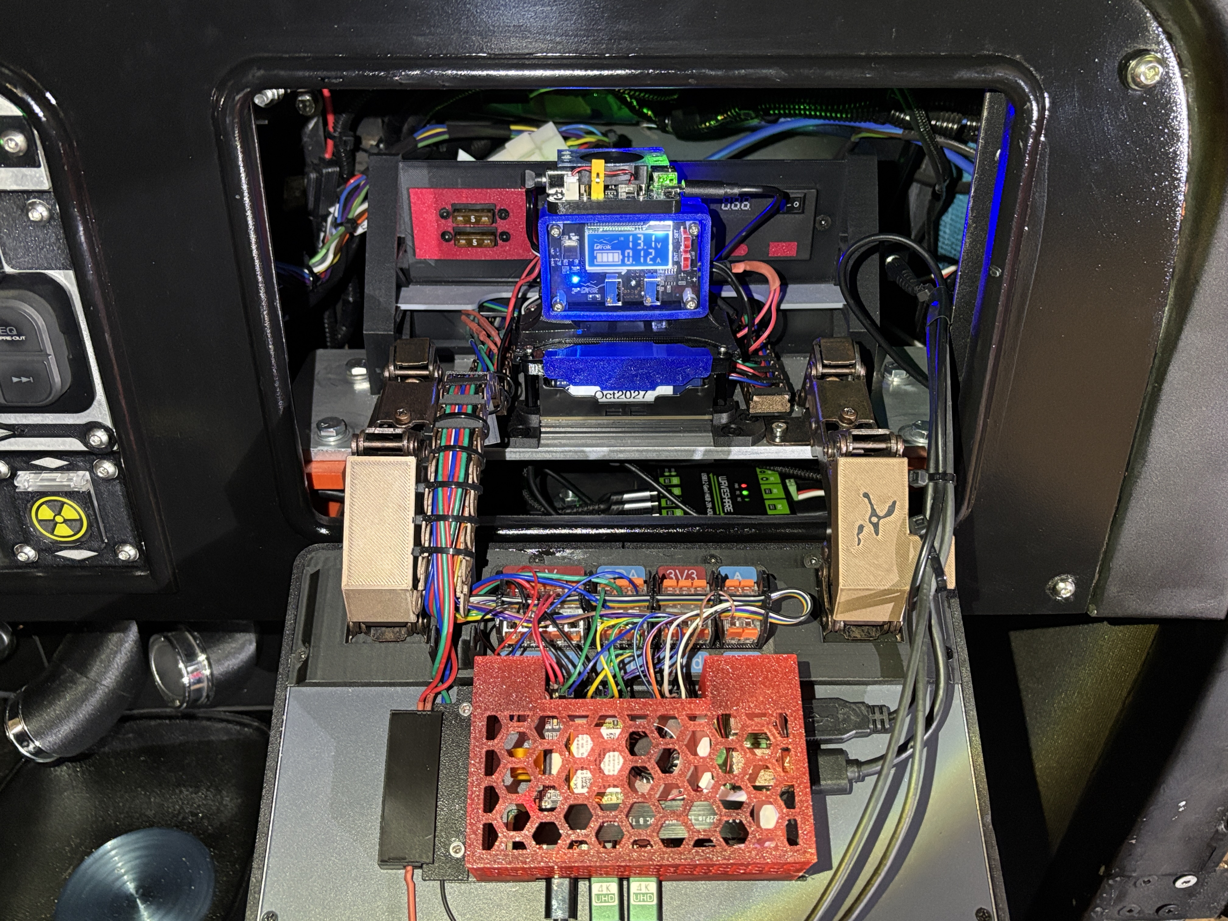

re: Waveshare 3S UPS
Things didn't go as planned. The initial design was for a script to monitor the inlet voltage of the UPS using its INI219 chip, and initiate shutdown when that voltage dropped out. The script works fine, but I mistook 'inlet voltage' to mean 'inlet of the UPS' rather than what it is: 'inlet to the chip', and the chip is at the outlet of the UPS, so: battery voltage. I bowed to the obvious and added a small board with 2x relays -> 2 GPIO pins to inform the Pi of the power state.
The 3S has 5V -> RPi5 on one set of pins, 5V -> relays & LEDs on another, and 12V -> relays & LEDs & USB hub on a third pair. With this load, the UPS was discharging faster than it was charging. About 90 minutes to empty but likely less than that. Because the design is to only charge when running, it meant I'd have to charge the LiPos by an alternate means between uses. To get around this, a second Buck converter was added at the top of the first, and both its output and the UPS output were tied together through diodes, so the new Buck powers the Pi and there's an instant changeover to the UPS upon Power Off, while the UPS powers the hub, relays and lights. Head Unit V2 will have an upgrade, but for now the startup/ shutdown logic works near perfect. I can still screw it up but even that's become rare.

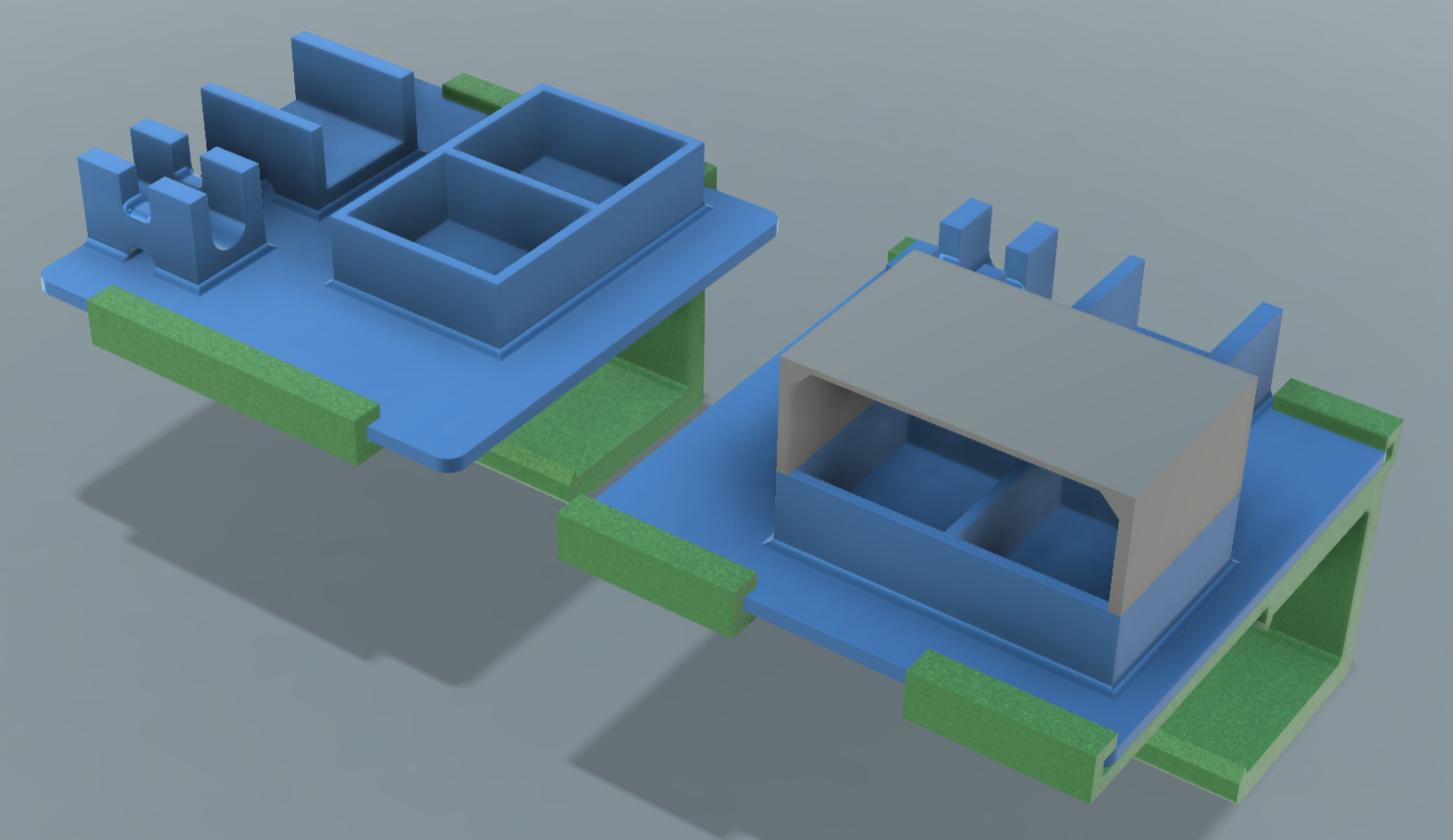

I'm happy with it. Real happy. The fit is perfect, and made so by printing a custom foam gasket with SirayaTech TPU air.

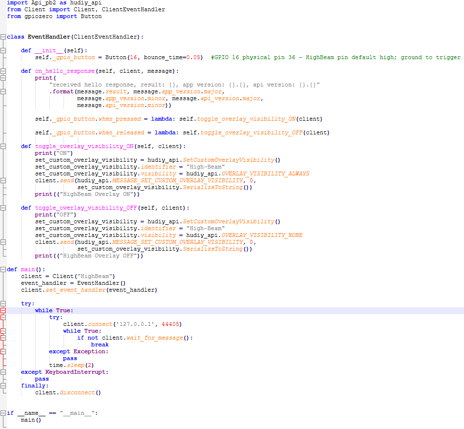

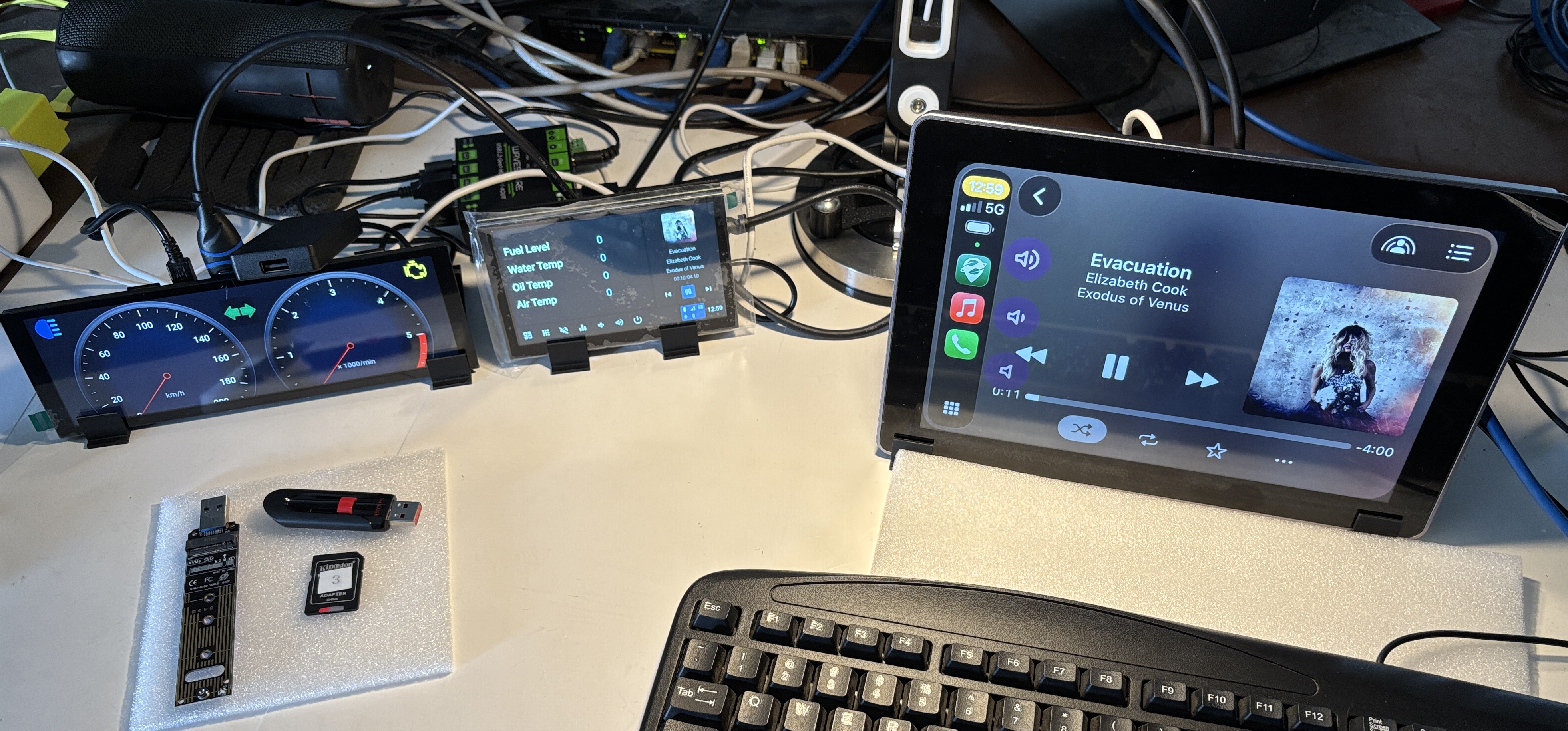

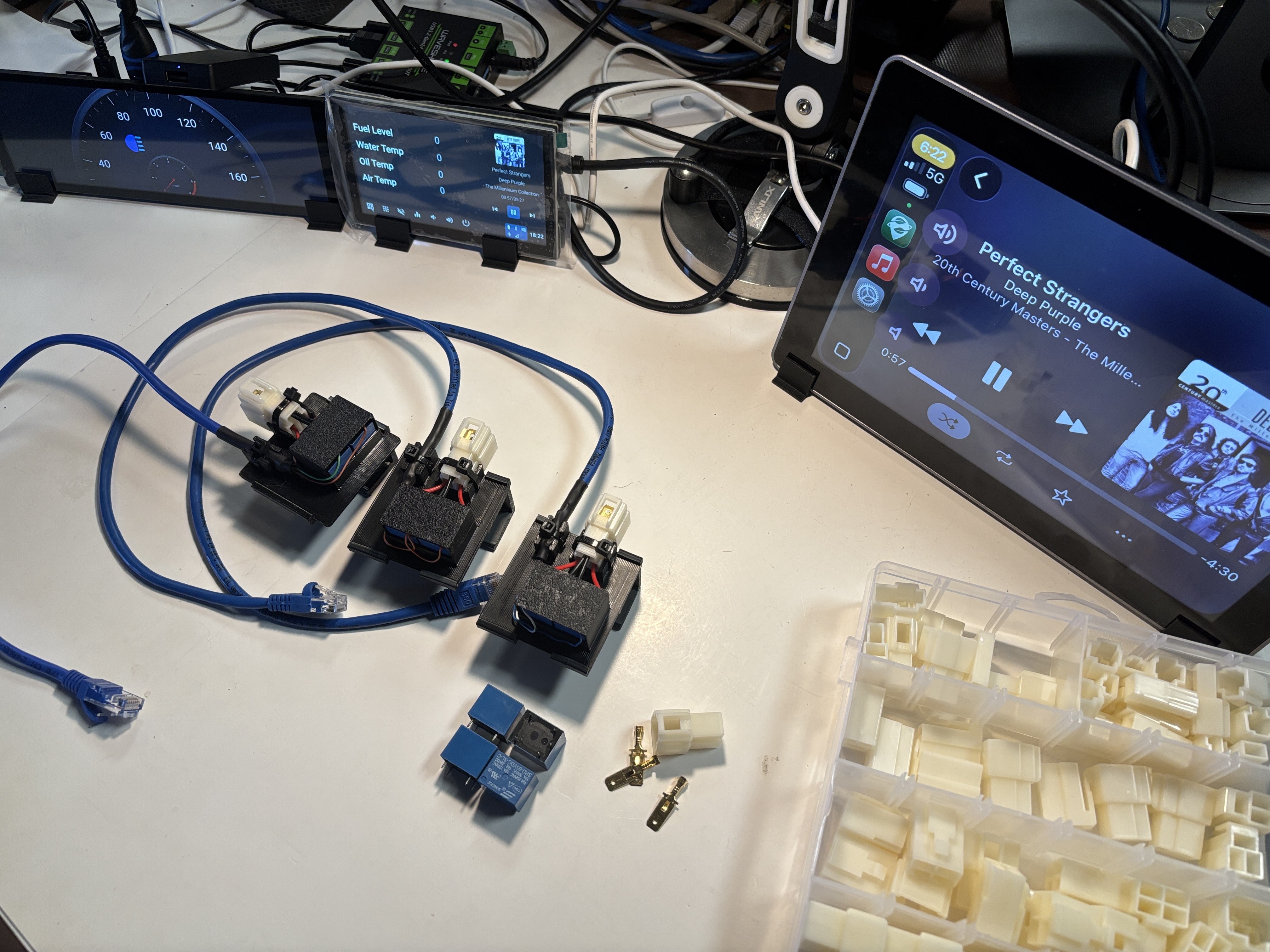

With the head.unit installed in the truck I needed a workstation and added a license.

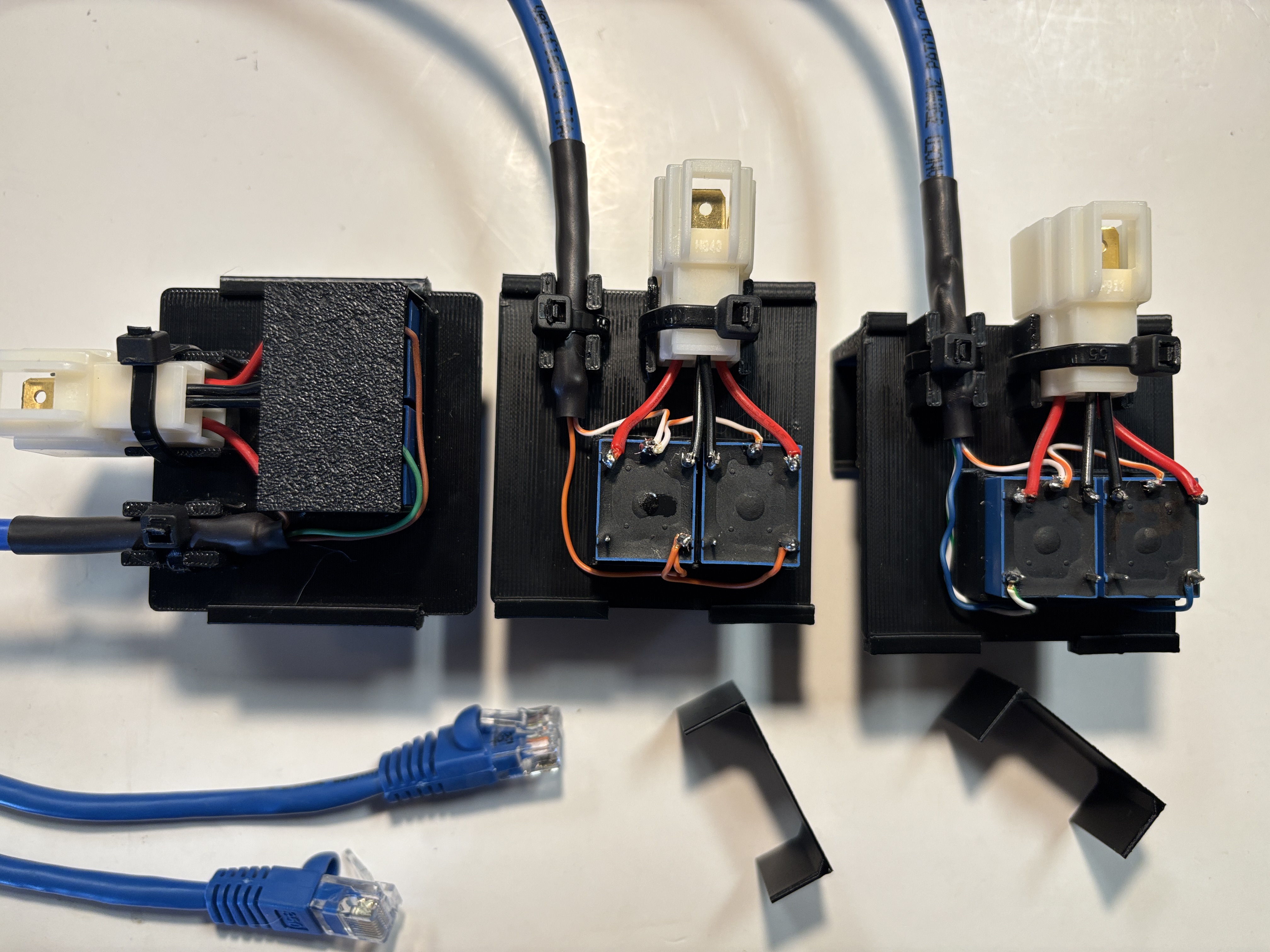

The truck.head.unit has a RJ-45 keystone + ribbon cable <-> gpio tied to 3v3 + gnd + 6x signal lines. The attached.relay.board has 2x12v relays telling the pi.shutdown.logic which 12v.truck.source is active. The 12v hots are separate but the logic is over cat5 back to the head.unit, so installation is flexible; there's not a lot of room to work with. Also makes it easy to unplug and work on.
I'm expanding to an 8 relay board and tapping into the hots for the turnsignals, highbeam and checkengine lights. These 3 signals trigger overlays on the dash screen. The checkengine signal is available in OBD so this might change.
It works bigly.
For now, I'm using one .py per signal because it's within my skill level. I'll make a master .py when I get more talent.
@hudiy Many thanks for the gpio.examples, and for the high.quality.code you often reply to questions with. It makes it possible to figure out.
edit: cleaned up code

The 8-relay panel turned into three of 2 each; not enough room. Cloned x2 the original and rotated the clones to keep the cables happy.
The first panel is to tell the Pi which power source it's using, the second is for turnsignals, and the third is for highbeam and a spare. I can't reach the checkengine light to tap 12V so it has to use OBD.
Waiting on a 3-way RJ-45 splitter then everything gets installed.
A note on the Molex connectors: I only use these Amazon spade type for low current; they don't handle heat well.
It's all Public Domain on Cults with .stl and Fusion .f3d files if you need something similar.
https://cults3d.com/en/3d-model/gadget/aux-relay-panel
- Aux Relay Panel 2.jpg (3.29 MiB) Viewed 459 times
- Aux Relay Panel 1.JPG (2.52 MiB) Viewed 459 times
- Aux-Relay-Panel.png (648.77 KiB) Viewed 459 times
