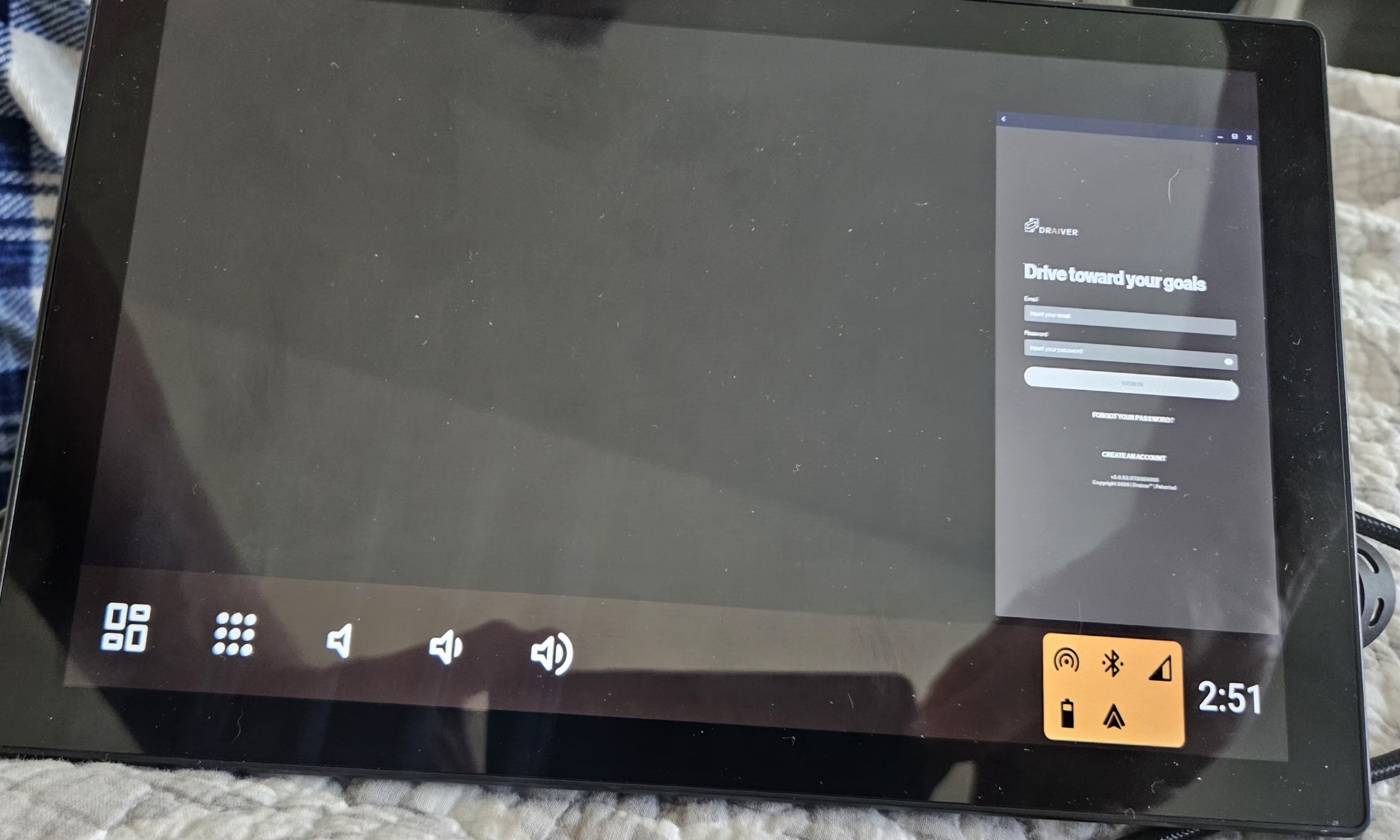

Im using some of the coding from
To create a menu button for a android app launched with waydroid. I have successfully created the menu and it launches the app. But when I go to access other areas of hudiy the android app looses focus and I cant bring it back to the front.
Is there a better solution?
The code i am using is

Thanks for the reply. It is a option I was looking at but is there a way to do this through some UI changes so that it only displays on screens that i want?
The app i want to launch will always be in a static location and size.
So ideally I would like hudiy UI just to show that area of the desktop. And then change the width of android auto so it doesnt cover that area up as well.
