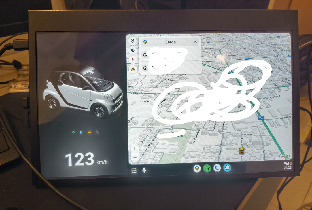

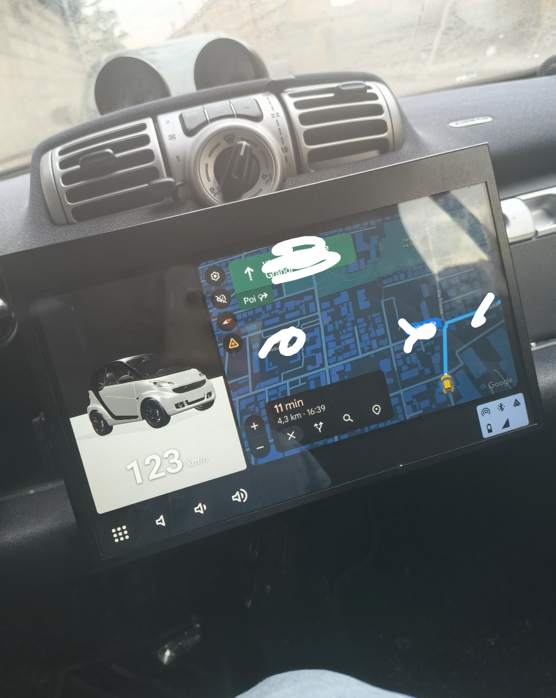

I wanted to achieve an interface similar to Tesla’s UI. I had created an HTML widget with a 3D render, and I placed Android Auto next to it, modifying its size and margins. However, I didn’t like the bar at the bottom being so thick—it took up too much space—so I wanted to reduce its size.
In the end, I decided to modify the overall size as suggested, so as to hide the bar and replace it with the Android Auto one.

Thank you for the explanation. As a workaround, you can create a custom Bottom Bar in HTML/JavaScript as an overlay of the desired size to mask Hudiy's bottom bar, and then stretch the projection and your overlay containing the 3D render. You can also add controls to your custom bottom bar that trigger specific actions via the API (similar to shortcuts). Additionally, most status indicators (such as phone signal, battery, Bluetooth, and Android Auto) can be retrieved using the API as well:
https://github.com/wiboma/hudiy/blob/ma ... d#overlays
https://github.com/wiboma/hudiy/blob/ma ... .proto#L55
https://github.com/wiboma/hudiy/blob/ma ... proto#L102
https://github.com/wiboma/hudiy/blob/ma ... md#actions
We will test how the UI behaves with a smaller bottom bar and try to add an option to resize it in the settings.

Thanks for the tip. I created an overlay for an application bar in HTML with some icons, but I can’t figure out how to attach Hudiy functions to the icons using the API. Could you briefly explain how to do this? Thanks.
