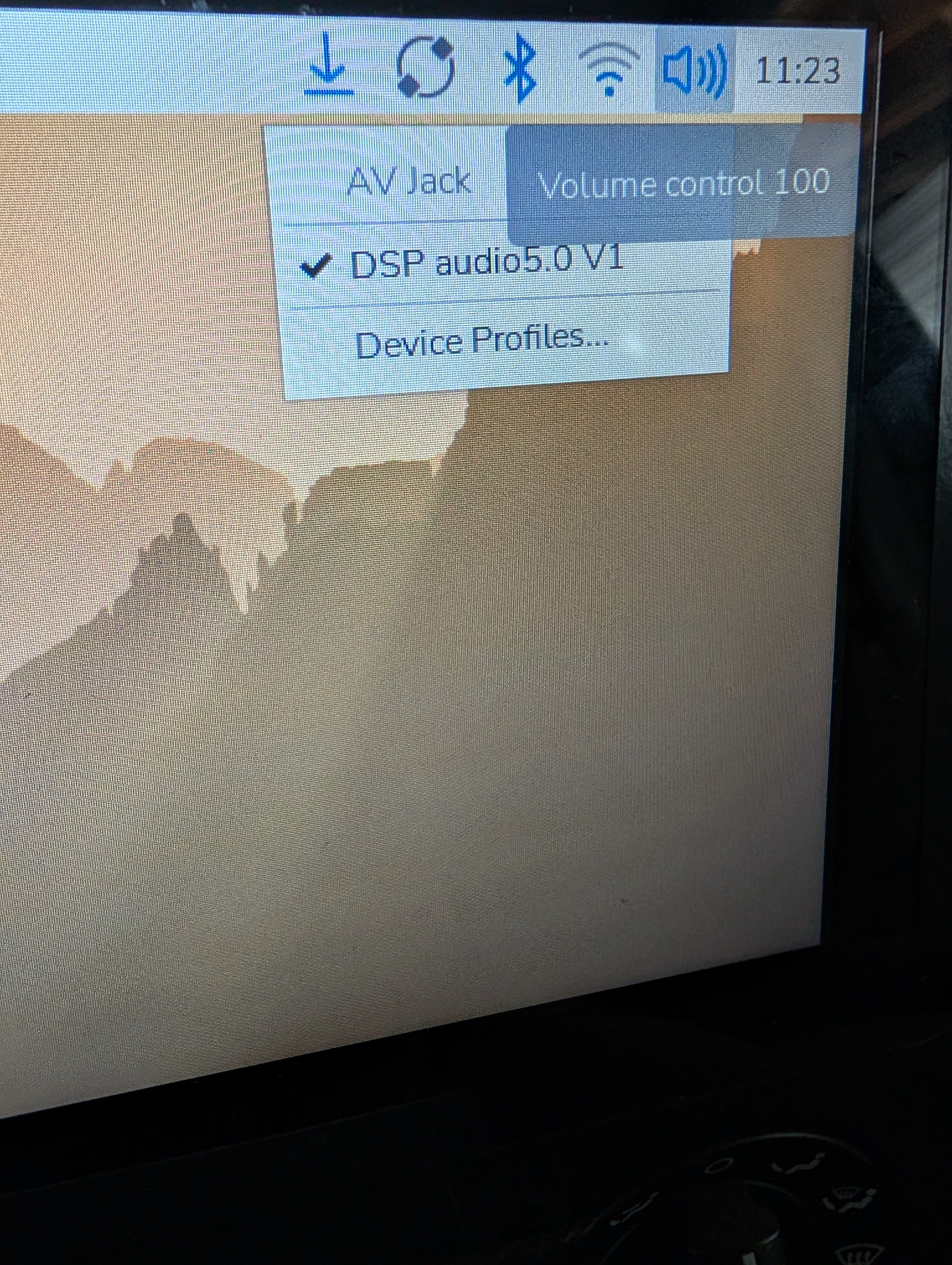

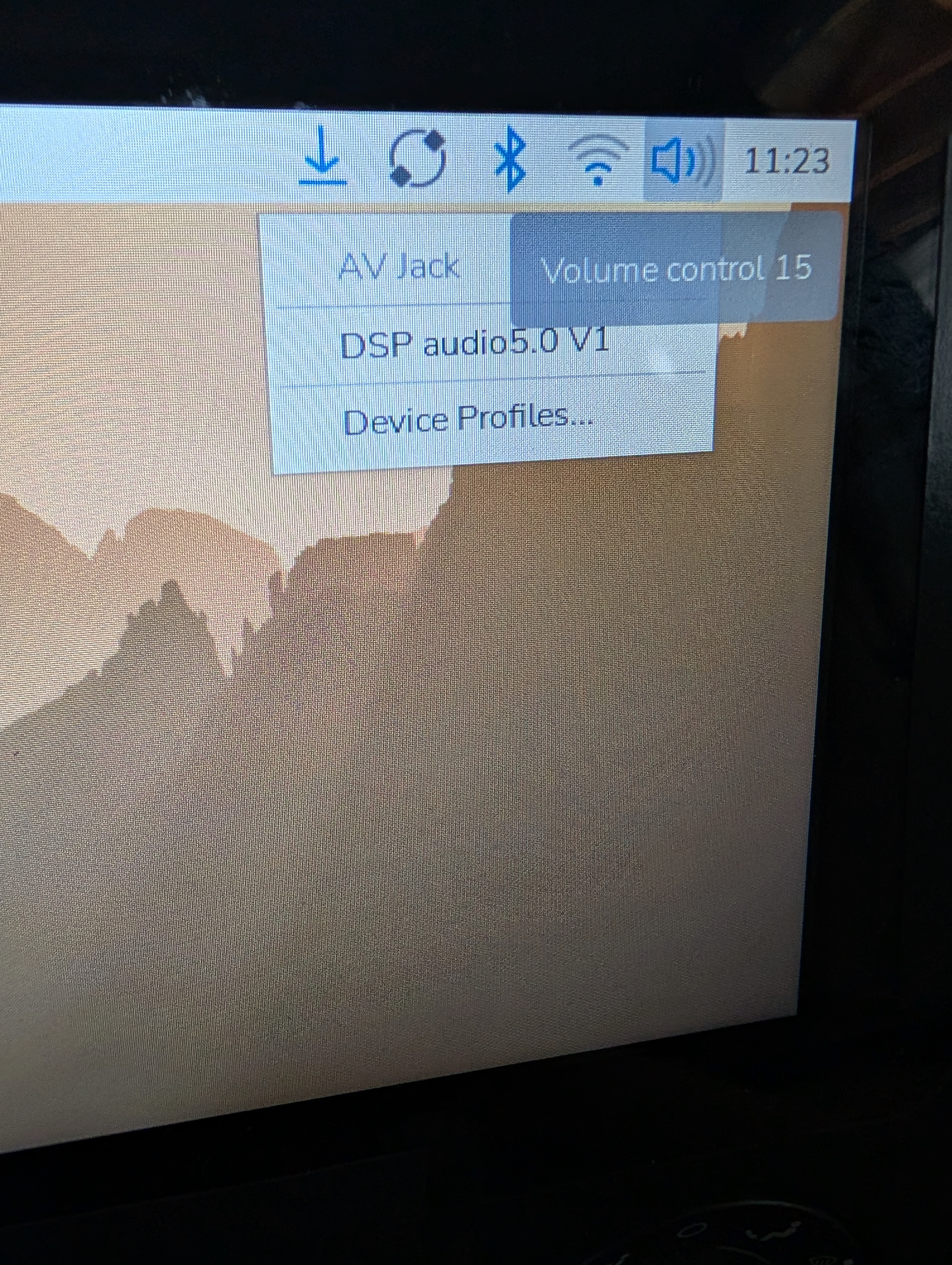

I have this issue where after pairing, connecting, and trusting a bluetooth device I still have to exit to desktop after every boot and manually select the device. After selecting the device, I get the checkmark before the name. If I dont do this I dont get audio.

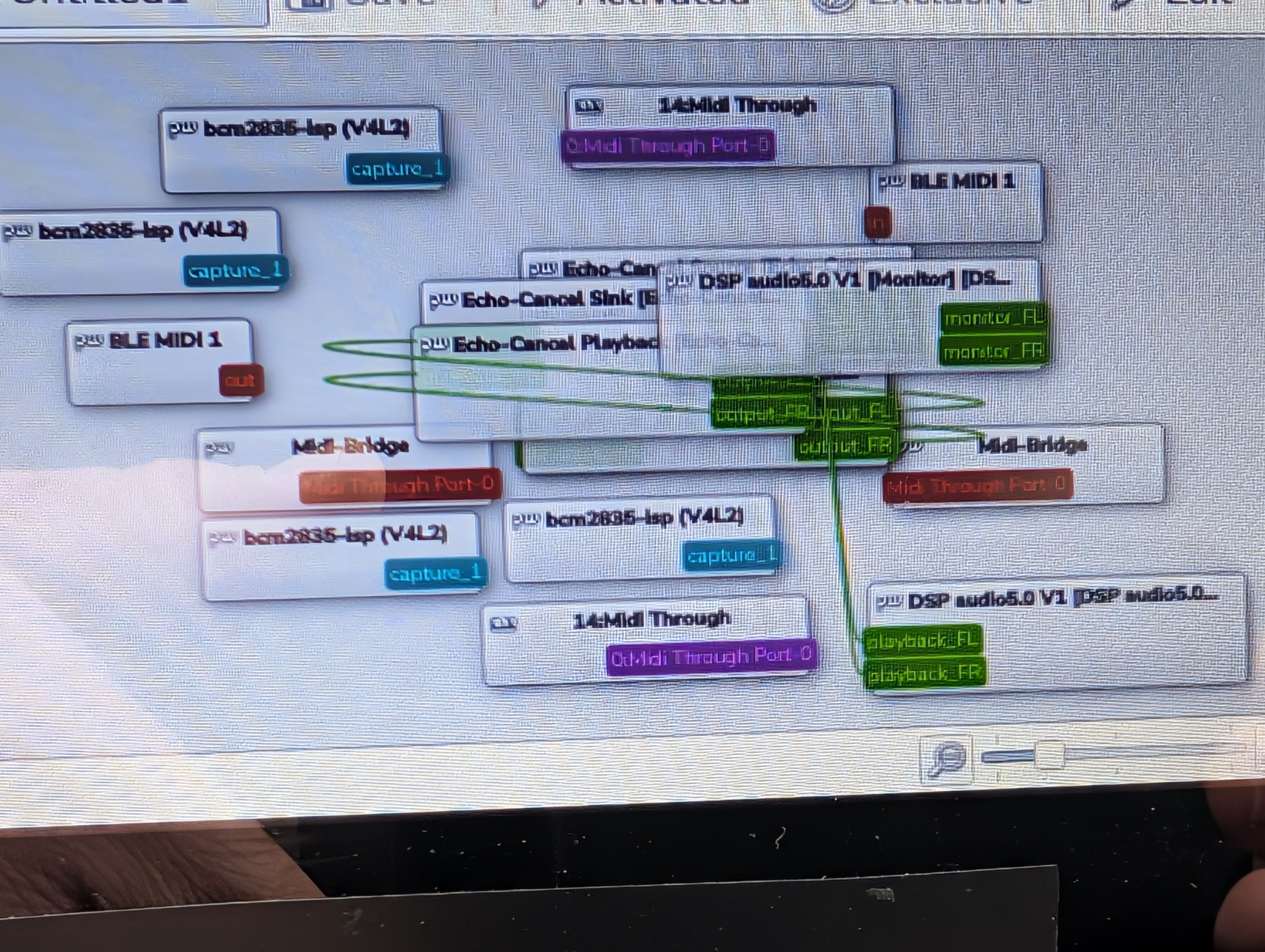

Could you please grab the audio graph (in qpwgraph) both before and after you select the device? It looks like PipeWire is sending audio to a different device before you switch to the desired one.
Is DSP audio5.0 V1 some kind of Bluetooth audio receiver (over A2DP)?

Yes, it is a dsp that has Bluetooth input and/or 4 channel analogue input. Bluetooth is over A2DP yes
Edit: changed the picture so everything is included.
After
After
Before
Before
Re: Automatic BT device active
If you do not have microphone connected, could you please apply changes to hudiy_startup.sh mentioned in this thread viewtopic.php?p=785#p785? Just to make sure echo-cancel does not interfere with the bluez card.

Thank you, no I do not have a microphone. I made the changes and the connections seem to be working as expected. No more having to select the output device.
