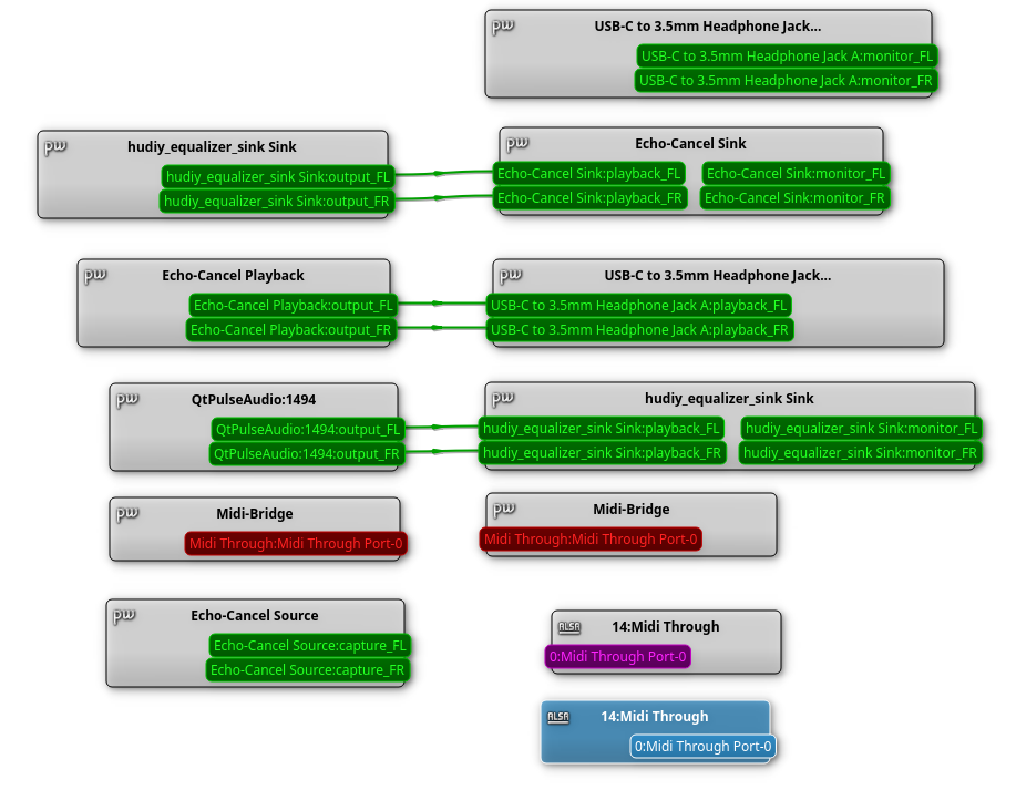

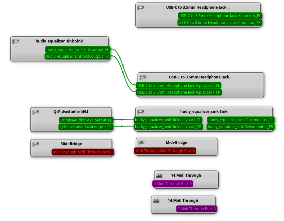

I seem to have had the same prob. No audio, but I ran the above pactl command and instant working. Hmmm... I'm just doing initial bench testing with an apple usb audio dongle and a pair of headphones. Any chance there's a usb2 vs usb3 conflict? It was working a few minutes ago when I had it in a usb2 port, but it stopped after moving it to usb3. Not many data points yet though. :)
Broken State:
Working after running the pactl command:

I'm seeing similar behavior in trixie. Had to do "pactl unload-module module-echo-cancel" and then I get audio output.
Re: No audio. Sometimes....
Posted: Thu Nov 27, 2025 9:23 pm
a8ksh4 wrote: Thu Nov 27, 2025 8:30 pm I'm seeing similar behavior in trixie. Had to do "pactl unload-module module-echo-cancel" and then I get audio output.
Do you have any microphone device connected to your Raspberry Pi?
According to other threads related to Trixie, it looks like the echo-cancel module in the PipeWire version shipped with Trixie has an issue when there is no microphone present in the system and echo-cancel module is loaded. If the echo-cancel module is loaded without a real microphone, it may treat (but not always) the monitor of the default sink as the microphone input and interpret all played audio as echo - effectively cutting all sound.
If you don't have a microphone connected, the best solution is simply not to load the echo-cancel module. You can modify the $HOME/.hudiy/share/hudiy_startup.sh like:
DUMMY_SOURCE="dummy_source"
source_exists() { pactl list short sources 2>/dev/null | awk '{print $2}' | grep -Fxq "$1"; }
sink_exists "$EQ_SINK" || pactl load-module module-ladspa-sink sink_name="$EQ_SINK" plugin=hudiy_equalizer label=hudiy_equalizer control=0,0,0,0,0,0,0,0,0,0,0,0,0,0,0
source_exists "$DUMMY_SOURCE" || pactl load-module module-virtual-source source_name="$DUMMY_SOURCE"
pactl set-default-source "output.${DUMMY_SOURCE}"
The script will create a virtual microphone to satisfy CarPlay and Android Auto requirements (presence of a microphone). You can also specify master= in module-ladspa-sink to point to the desired output sink if PipeWire selects the wrong one (e.g., HDMI instead of Jack).
