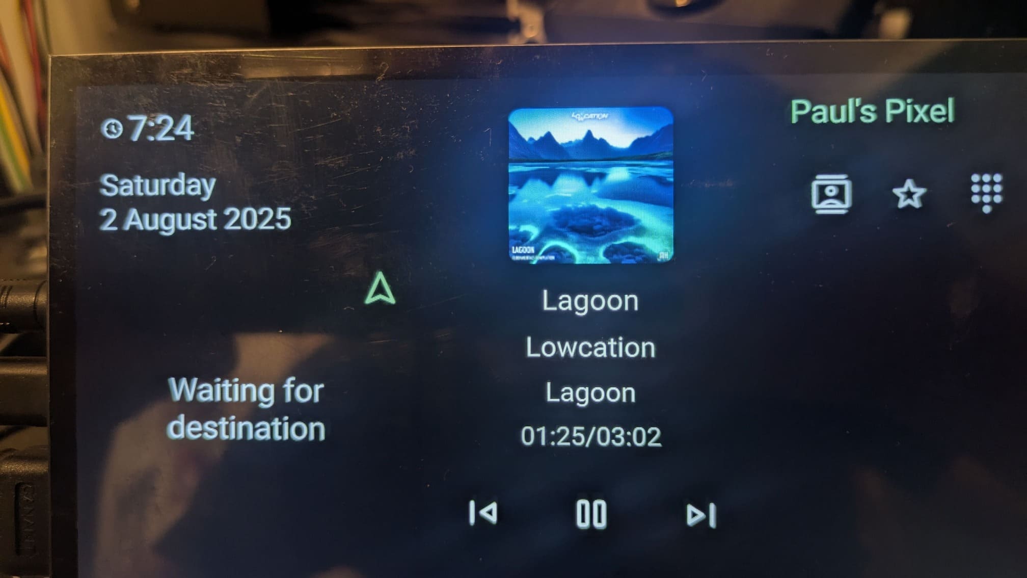

Hey! thanks for all the help. I included some pictures to show my issues, because nothing has worked yet. Is there something i need to run after changing the config to apply the settings? I have just been rebooting.
