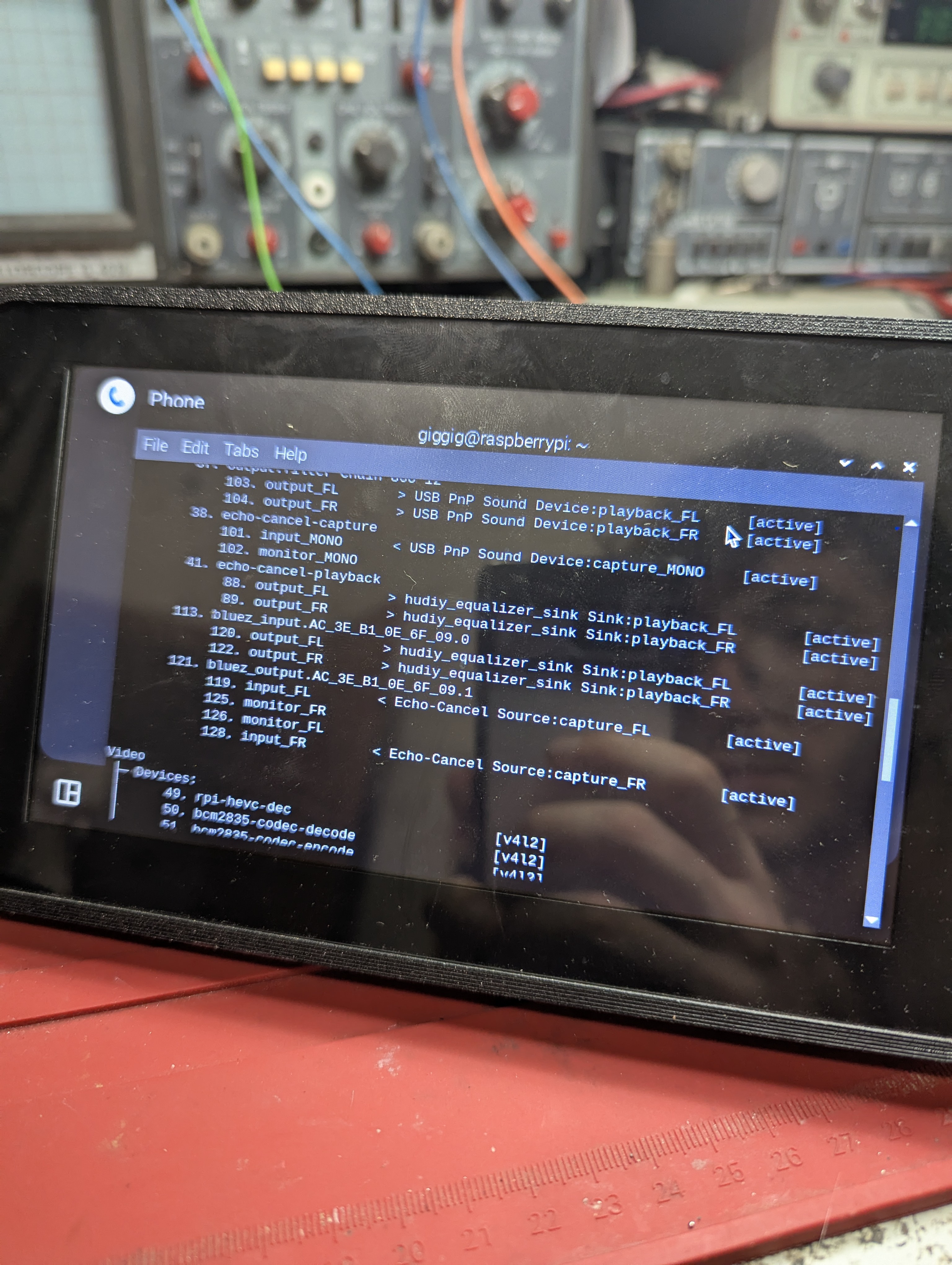

Re: DAC Sound/ USB MIC
I too have a similar issue, when I call someone they can hear me but I can't hear them. I have verified the routing of the blueZ source and output and they both go to the hudiy equalizer and the echo cancelling source respectively (see attachment for reference). In pipewire both the equalizer and the echo cancelling plugin sinks are the defaults for output and input. I don't know where to look into to solve this problem.
Also since my head unit uses a cheap DAC the microphone input I get is really low, even with the sink volume and gain maxed out. Is there a way to activate an auto gain effect reliably? I tried using it through easyeffects but it is very unreliable, it sometimes ends not outputting anything to the mic when the effect is active.
Thank you for helping me with the mic gain, I can at least hear myself clearly without having the mic strapped to my mouth.
Regarding the call issue, I've checked both the input and output volume using both pactl list sink-inputs and pactl list source-outputs and both are set to 100%. As far as I know everything is routed where it should:
Input: echo cancel source capture connected to my audio card mic input jack (I have confirmed that the mic works using the recorder app and also while in a call the other person can hear me clearly)
Output: hudiy_equalizer_sink connected to my audio card output jack (can confirm it works since I can clearly hear any audio that is streamed via Bluetooth by my phone.
I have also confirmed that my phone's volume output while in a call is set to the max, and also that the call output is routed through the pi.
For the Bluetooth I'm using a generic USB bluetooth 4.0 module, I've used this exact Bluetooth module both in openauto pro and in open dash without any issues. The onboard Bluetooth on the pi is disabled
Could you please install qpwgraph (sudo apt install qpwgraph command) and share here the graph generated by that program when voice call is active? It’s possible that during a voice call, the output of hudiy_equalizer_sink is not connected to the sound card but, for example, to the echo-cancel monitor or its sink. Please also send the full output of the pw-dump command executed during voice call.
I've attached a zip file containing both the entire pw-dump text file and a photo of my qpwgraph screen both while in a call. As far as qpwgraph is concerned I don't see any issues myself with the audio routing. Note, this time I had to do a call outside of android auto since i needed to ssh into the pi, but the issue is persistent whether I have android auto running or not.
