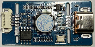

#1 - CVBS to USB capture analog signal to digital USB camera module, UVC, driver-free, plug and play for Android
Price: $11.76 / 10.59€
Working: Yes
Measurements: 38.70 x 19.50 mm
Video output formats:
MJPEG: 720x576 @ 60 Hz
MJPEG: 720x480 @ 60 Hz
YUV422: 720x576 @ 25 Hz
YUV422: 720x480 @ 30 Hz
Link: AliExpress
Notes: I would really recommend this PCB because it already has USB-C and a terminal with a cable for the video signal. You only need to solder it to a female CVBS connector. This cable is perfect for mounting the PCB inside the Pi case: Delock cable
Because the chip gets very hot, it might be a good idea to cool the chip/PCB with a heatsink.
Update 17th of may: The M.2 2230 SSD cooler i've ordered ( DolDer M.2 2230 SSD cooler ) fits pretty well. So i think nearly all M.2 2230 SSD cooler should fit pretty well.

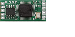

#2 - 1PCS 1080P camera module, analog AV/CVBS to USB digital signal converter, YUV422/MJPEG output, 3D decoding support for RC drone
Price: $9.27 / 8.39€
Working: Yes
Measurements: 25.00 x 12.00 mm
Link: AliExpress
Notes: This PCB is also fine, but you need to solder everything yourself: the USB cable and the CVBS input cable.

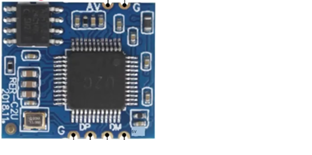

#3 - 1PCS analog AV video to digital USB camera module, CVBS to USB chip for UVC, driver-free
Price: $7.13 / 6.39€
Working: Yes, but with lower specs and only MJPEG at 25 Hz
Measurements: 18.80 x 16.50 mm
MJPEG: 720x480 @ 25 Hz
Link: AliExpress
Notes: This PCB had more flicker during my tests and looked lower resolution.
