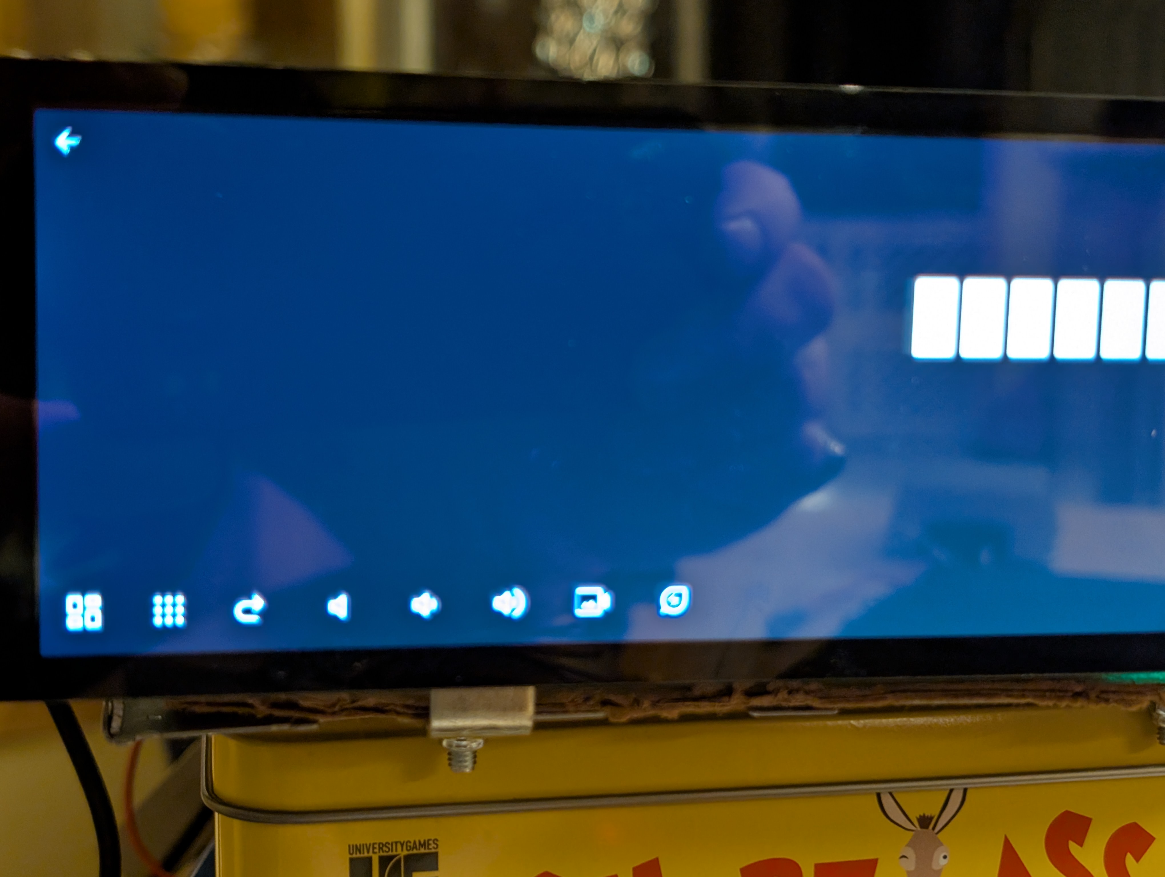

Hello, since 2.6 and now still on 2.8 the EQ presets seems to be missing. Touching in the area where the presets would be doesn't change anything.
Re: EQ presets missing
Posted: Fri Feb 20, 2026 6:14 am
Hello, looks like you had a syntax error in your config file and it was overwritten by the empty one.
You can take default presets from https://github.com/wiboma/hudiy/blob/ma ... .json#L119 and put them to your main_configuration.json
https://github.com/wiboma/hudiy/blob/ma ... #equalizer
