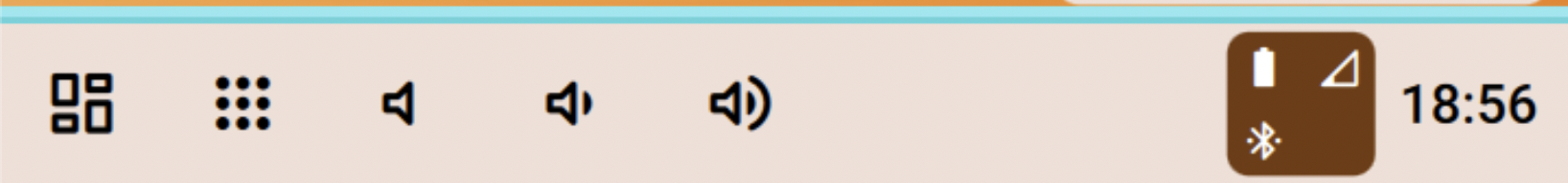

I would like to remove the opaque background from the taskbar.
Can it be done?

Posted: Thu Feb 05, 2026 6:09 pm
Hello, in the latest version we added possibility to set opacity of widgets and bottom bar backgrounds. Please have a look at this thread viewtopic.php?p=1174 and https://github.com/wiboma/hudiy/blob/ma ... n.md#theme (darkOpacity, lightOpacity)
Instructions for updating Hudiy are available at: https://github.com/wiboma/hudiy/blob/ma ... d#updating

Is it also possible to change the other default elements? (progress bar, transport buttons, the area with bluetooth notifications next to clock)
Re: How to remove default parts of UI?
Posted: Thu Feb 05, 2026 6:54 pm
These colors are part of Material Design and are based on selected source color.
More details about colors in Material Design are available at: https://material-foundation.github.io/m ... e-builder/
You can define your custom source colors to match your background: https://github.com/wiboma/hudiy/blob/ma ... n.md#theme (availableColors)
